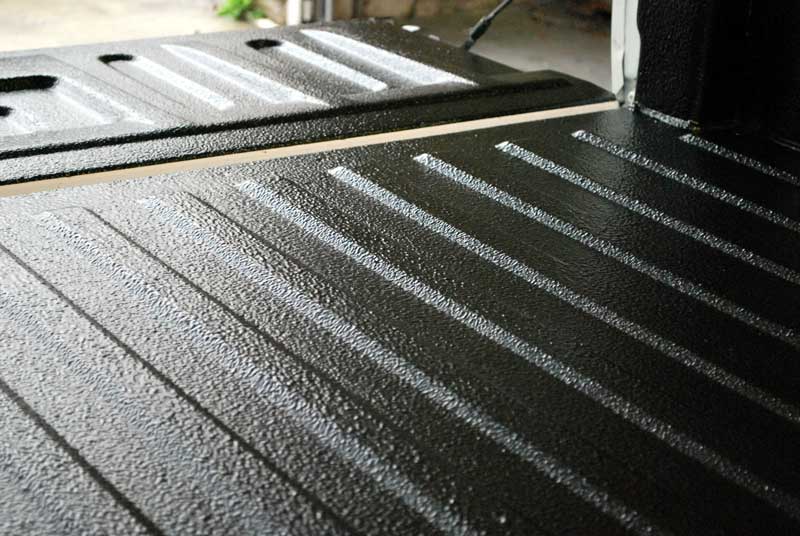

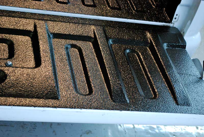

Posts: 11,439
Originally Posted by AustinTJer View Post
You gotta help me...
Im torn between Monsta and Raptor...
I dont have a air compressor, so that would put strain on doing Raptor, but everyone SWEARS by Raptor...
I tried to read as much of this thread as possible, but there are LOTS of posts...
What are some similarities and differences between the two?
Monsta - Monsta - Monsta - Monsta - Monsta - Monsta
If you have no compressor, hoses, etc. why even consider Raptor.
Look at these photos below. This is a small S-10 pickup I did personally last Friday. If you take your time with a roller just look how impressive this can be.
Monstaliner will give greater film thickness than Raptor which will work to deaden sound better.
Both are UV stable. Monstaliner will give better traction because you can't get this depth of texture from Raptor.
Spraying also requires that you do extensive masking to protect the rest of the vehicle.
Here's a link to this complete install without the final photos yet.
Truck is still in our warehouse. Tomorrow will be sunny and I'll shoot final shots.
Monstaliner Installation in 1998 Chevy S10 EV Electric Pickup Truck Bed
