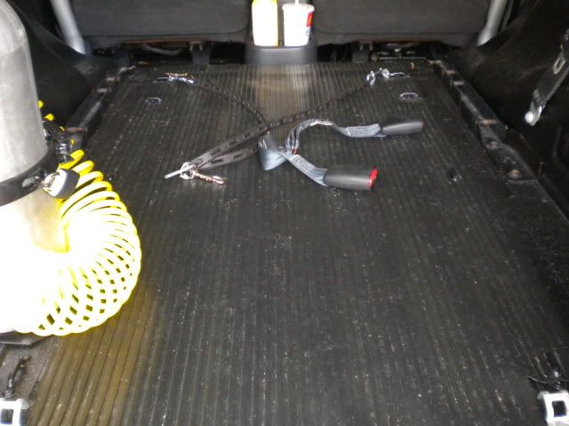

Finished my install, that was a bit of work but well worth it. Just a few things. My kit didn't have the mixing sticks or the brush. That's was OK since I had some mixing sticks and a ton of brushes left over from painting my house. The only other thing was one of my foam rollers fell apart instantly. It was the first coat too. Followed the directions perfectly for mixing and everything. Poured it in a tray, started to roll and 5 minutes later I had no roller. Luckily, the second one held up for both coats, I just had to MEK the crap out of it after the first coat so I could use it later.
Spent Thursday doing prep work (it was more than I expected), Layed down the liner Friday and let it sit all day Saturday. The dog hopped in it Sunday and slid all the way to the front. I got some rubber lining at Home Depot and put down a pad for her with velcro. It doesn't look too bad and gives her some grip on the road.
Before
Dog hair!
Stripped and clean
First coat
Everything back in
Rubber lining
One thing I did do a little different; On some of the harder to reach spots and where the metal was folded over leaving little gaps I sprayed some black platic dip in to fill the holes. The color dried to a perfect match. Didn't do it in anyplace you could notice, just some spots that were way to tiny for the brush.
All in all, I'm happy with the product and it's nice to be able to wipe it down. I did it for two reasons, to get rid of the dog hair and the moldy carpet smell from Florida's 3 p.m. rian shows. Now I can leave the Safari top on and forget about it.
