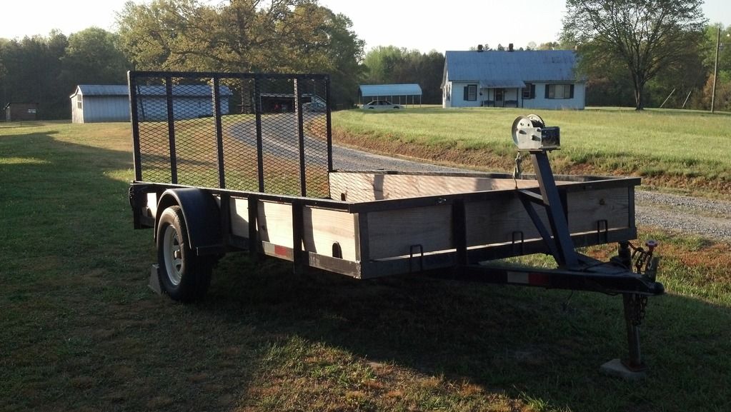

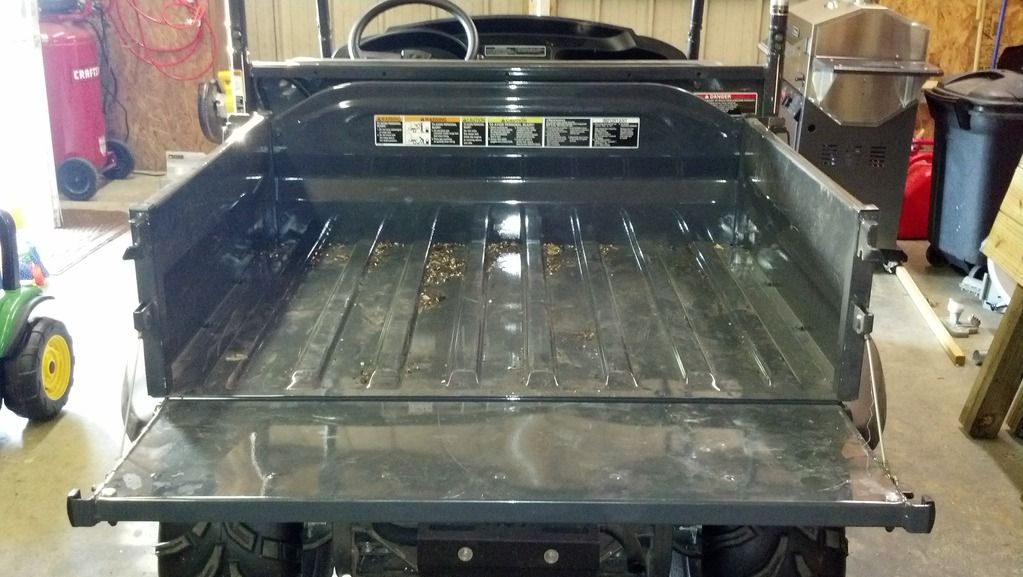

I'm trying to get an idea of how much I would need to do these two items and whether I should even both trying to paint the mesh on the trailer gate.
The bed size on the RTV is 40.6" x 33.7" x 11.4" (Width x Length x Depth). The trailer is 12'x6'.

I got 22 sq ft in the RTV bed which is 1.5 quarts (15 sq ft per qt)
Inside the trailer (floor + 3 sides @ 12" height) is appx 102 sq ft which figures appx 1.7 gals. Outside surfaces on trailer needs another .5 - .75 gals
You must seal the wood first. Silver Chassis Saver does an amazing job as a sealer on wood. I would just paint the mesh

jrp78
Location: Southern
Posts: 47
Thanks!
