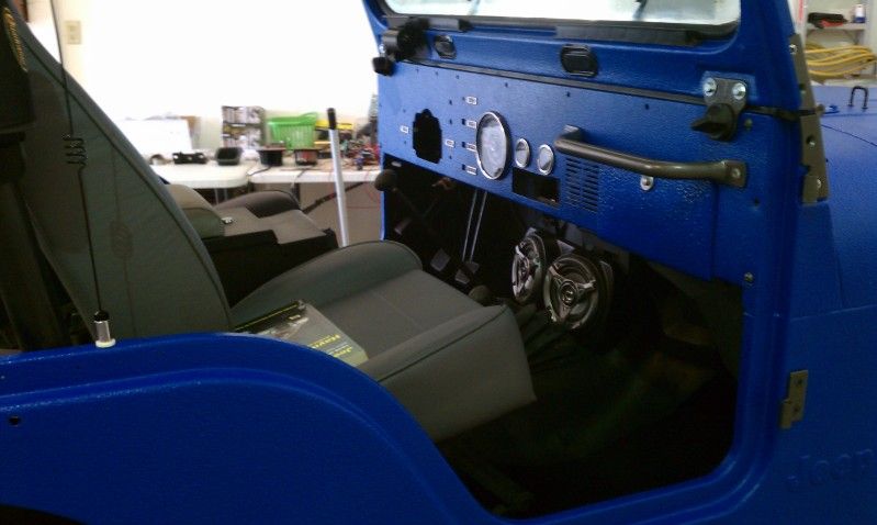

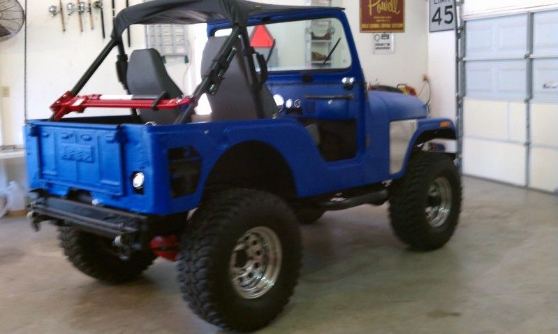

A sneak peek at my almost finished CJ5 project painted with Monstaliner Smurfadelic.
A few comments about the Monstaliner. The product is great, I am extremely happy with the application and the looks of the product. I have gotten so many compliments so far.
I will say, I did 2 coats of product and I rolled to long with the first roller and have some roller debris in the finish. Also, I was assuming I'd need 2 gal of product to coat the exterior of my CJ5, but I could have gotten by with 1 gal. I mixed the second gallon, but ended up throwing it away.
