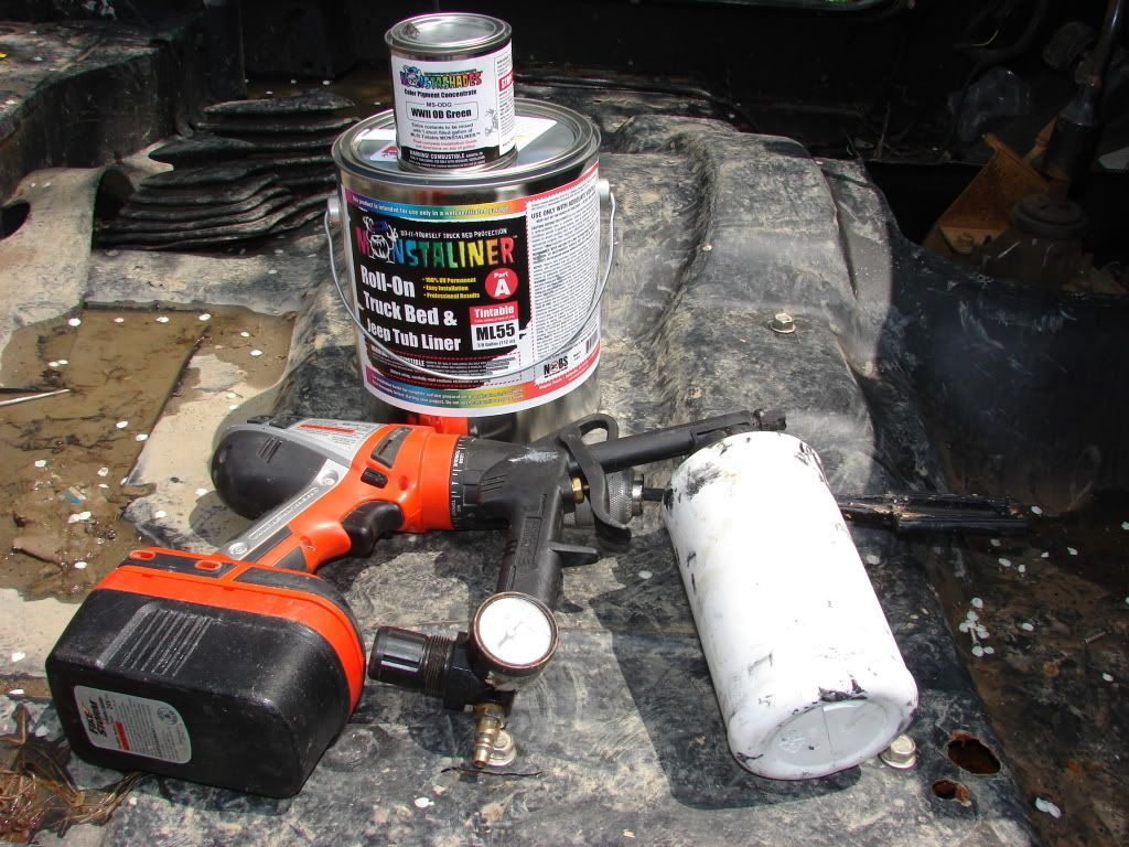

well if you insist.

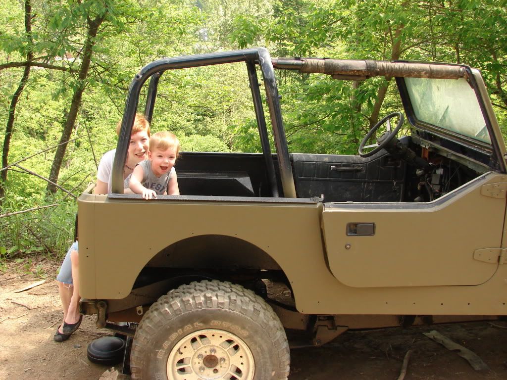

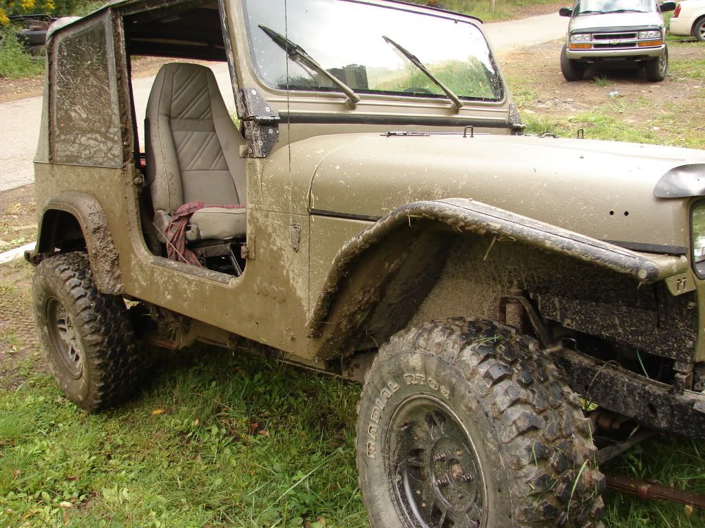

click these pictures they are videos

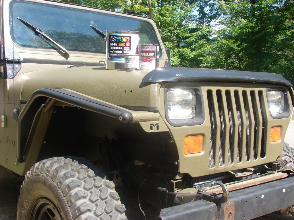

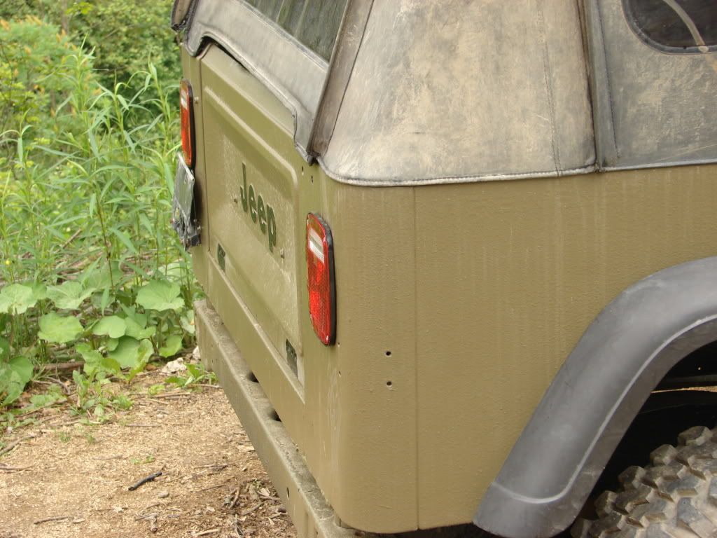

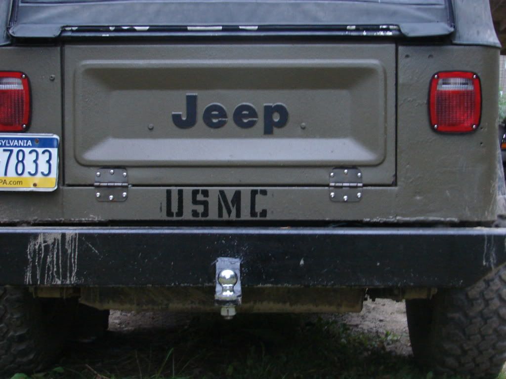

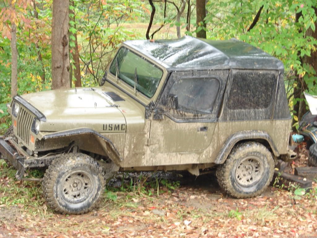

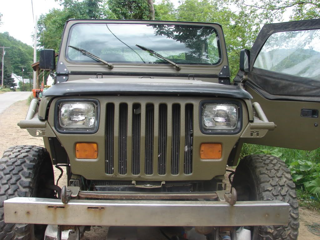

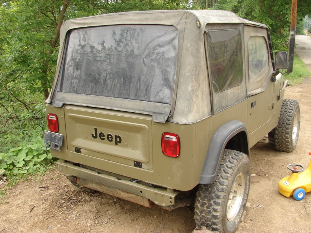

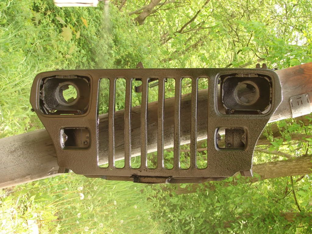

i have tons more but you should be able to get a darn good idea of what a YJ will look like with OD green sprayed ML.
i don't have any pics more current than the first few in the first post. not any change in the liner. i am planing on giving it it's second coat this summer after the d60's get under there.
i can report that in the approx 7-10k i have put on the jeep since the liner job i couldn't be happier with the results. the only thing that has any rust peaking through is a few spots i knew were insufficiently prepped on the frame. they were very hard to get to and i will be stripping parts of it off to weld on braketry for when the axles go under.

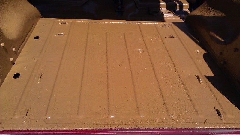

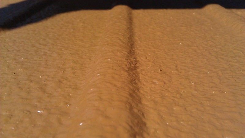

Well I finished in time to make it to my family easter thing.
first coat
first coat up close
second coat
second coat up close
A few things I learned:
If you are in the south, do this in the winter. I finished the first coat, took a little over an hour, came in to use the bathroom and when I went back out, the front was dry to the touch, which is where I started. Edit: even with the heat it wasn't till I was done that the stuff in the can skinned over bad enough I didn't want to risk getting chunks in it to put a 3rd coat on the front floor boards, which there was enough left to do =) I give all the credit to Eric for his ideas on how to work with it in the heat.
Find a place to do this inside. I have specks of stuff in mine, not that I care but some people do. And if it had AC that would be nice lol
Walk around whatever you're lining and look at it from lots of angles. I would think I had covered it all, walk to the other side and see a spot I missed..grrrr lol
Monsta is a GREAT product. Eric provided great customer service. Its really easy to apply. Looks great. I will get much better pics in a day or 2 when my friends with the good camera come back into town. For now you'll have to deal with my cell phone pics =)

Neudiin that looks great. What was the temp today?
