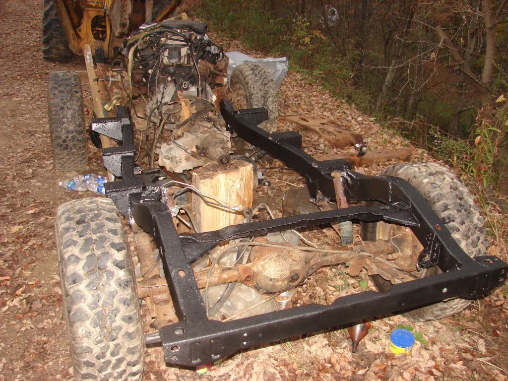

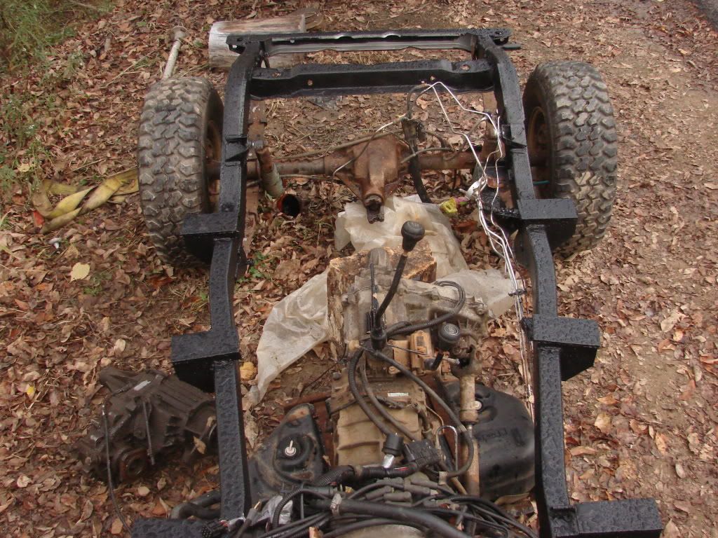

mike_breaker_5 did his rig. I have a bunch of shots like this from other people. This was a 1970 AMC, sprayed

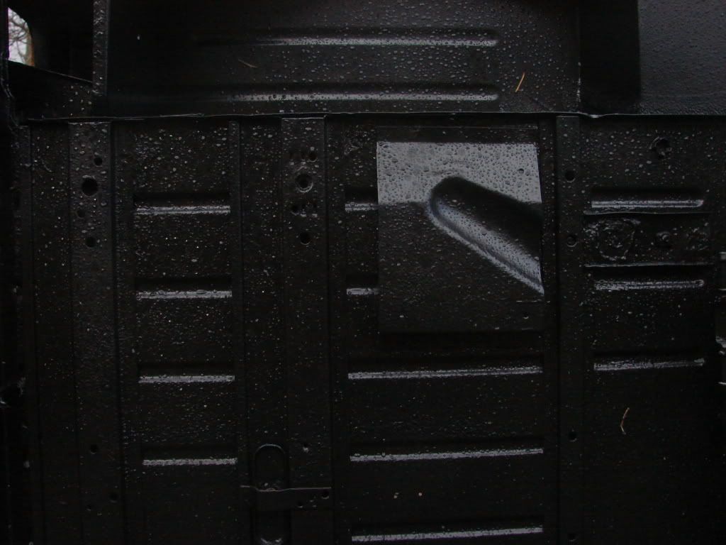

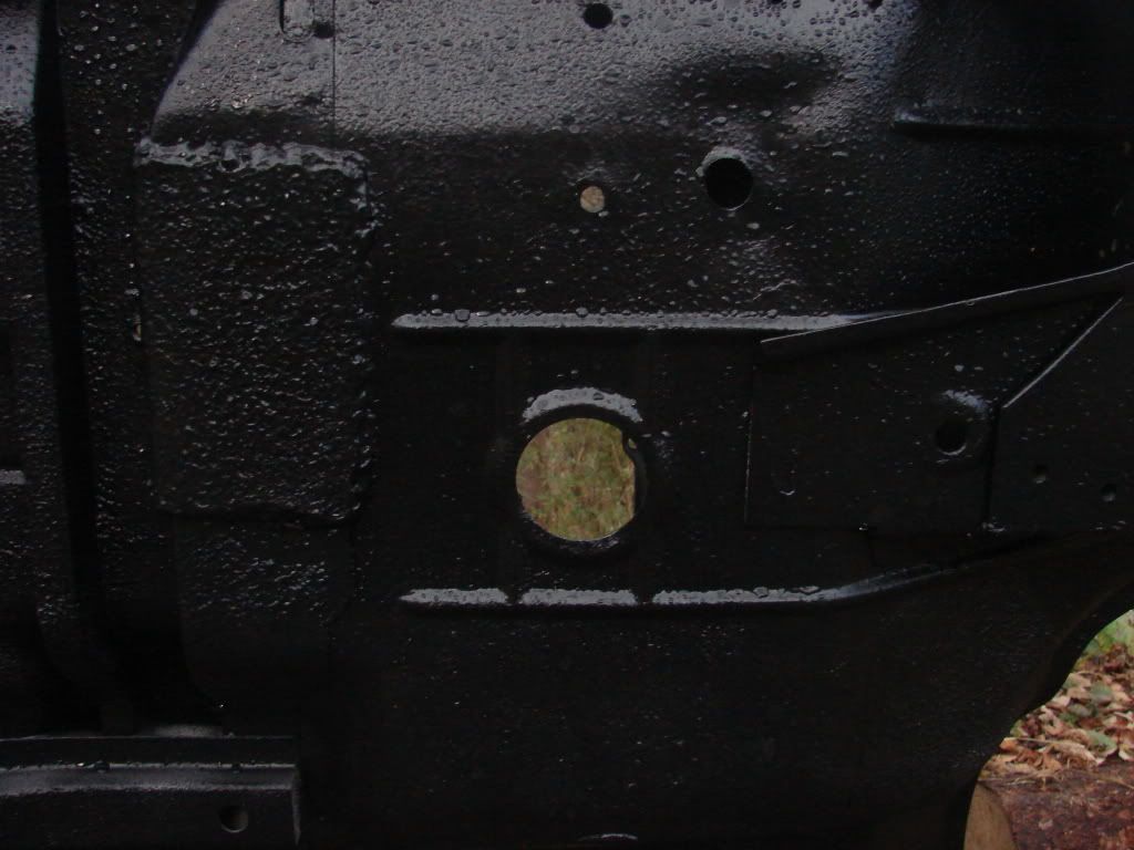

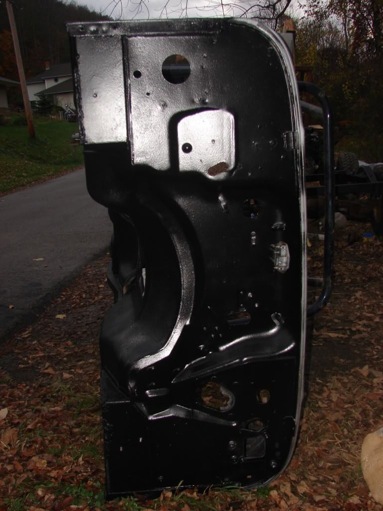

i'll help out with pics of the underside sprayed...
