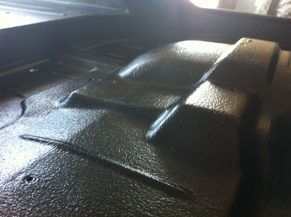

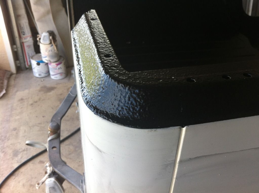

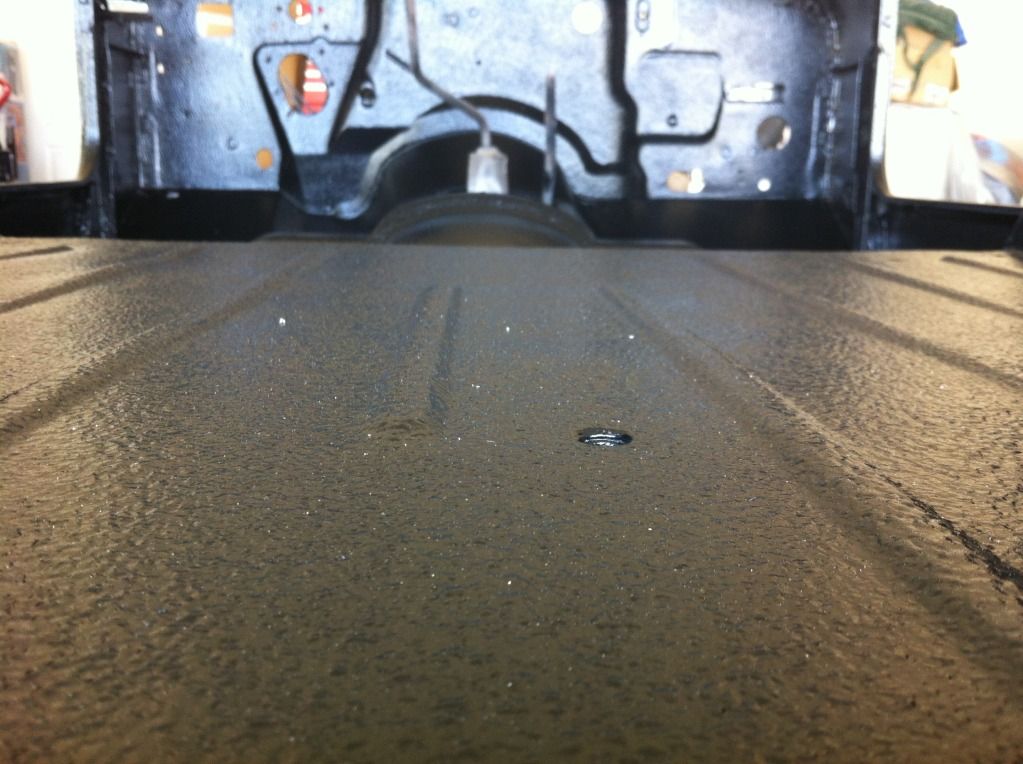

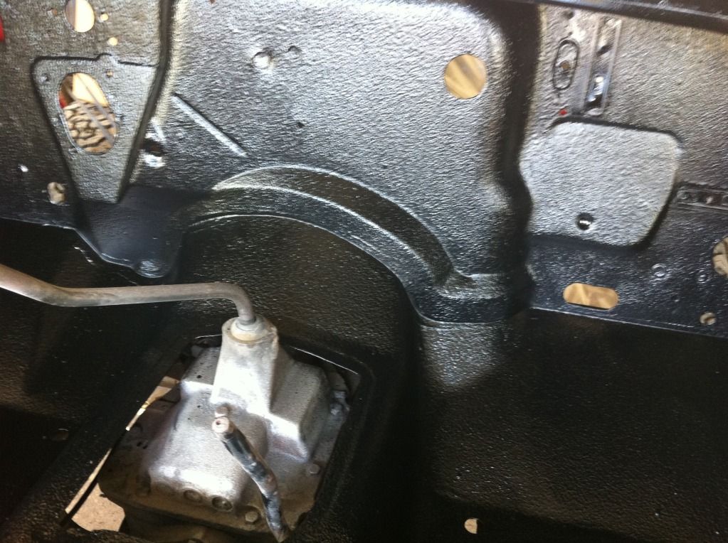

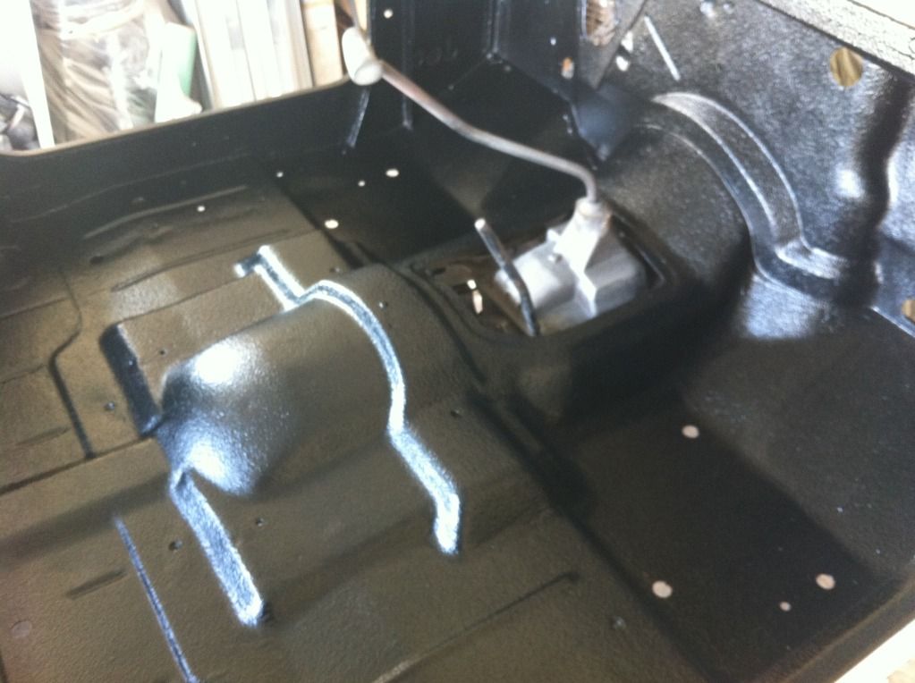

Hey guys, I just completed Monstaliner in my CJ tub last night and Thought I'd post some pics. This is an INCREDIBLE product!!!!!! You can see the whole process in my build thread. I started with priming with Silver Aluminum Chassis Saver and then followed up with a second coat of Black Chassis Saver. BTW, the Chassis Saver sprays beautifully in an HVLP gun with the S8 reducer. After the chassis saver was tack free, I applied the Monstaliner. It's so easy to do and once applied, you would swear it was spray applied. It does not leave roller marks behind, it spreads evenly, It's not splotchy, It's just beautiful.
Thanks Eric for the awesome customer service and for what I feel is the most user friendly "Breakthrough" product of the decade.
I have been restoring cars as a hobby for about twenty years now and I have dealt with too many companies that hype up their products and can't deliver in the end with either customer service or the overall claims they make with their products and more often than not, BOTH!
MAGNET PAINTS EVERYONE, THEY KNOW THERE BUSINESS LIKE NO ONE ELSE!!!!!

Magnificent! Thanks for the photos and your kind words!
