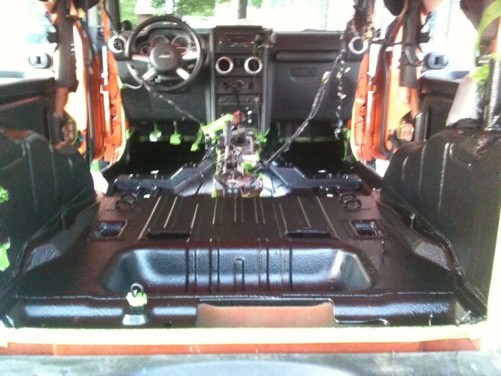

Finally finished my monstaliner project and love it. I have to admit that the 1 gallon seems to be cutting it close with the JK compared to the TJ. I didn't get to lay it on as thick as I would have liked, but I also did every inch of the interior as well as the side rails & door sills.
Unfortunately I had to do the project outside so lighting was an issue, on top of running low on monsta, so I didn't get to touch up in the hard-to-get areas as much as I would have liked. If I were to buy a quart of monstaliner to touch-up/thicken certain areas (say, next month), what kind of prep work would entail?
Here's a photo I snapped after my first coat before the sun went down. I'll try to get some higher resolution photos of the final product once the sun comes back out.

To touch up you just need to clean, light scuff and MEK wipe. Then just roll
Get the mini roller kits and it works well
