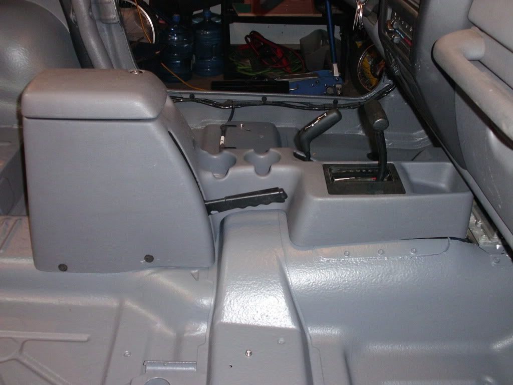

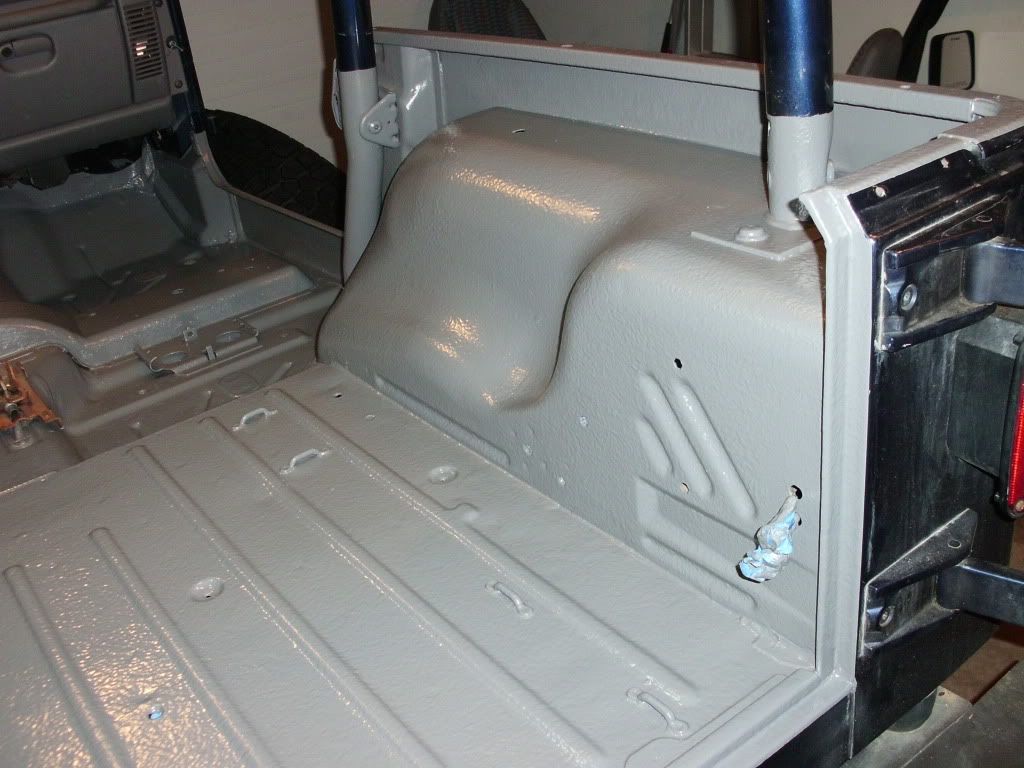

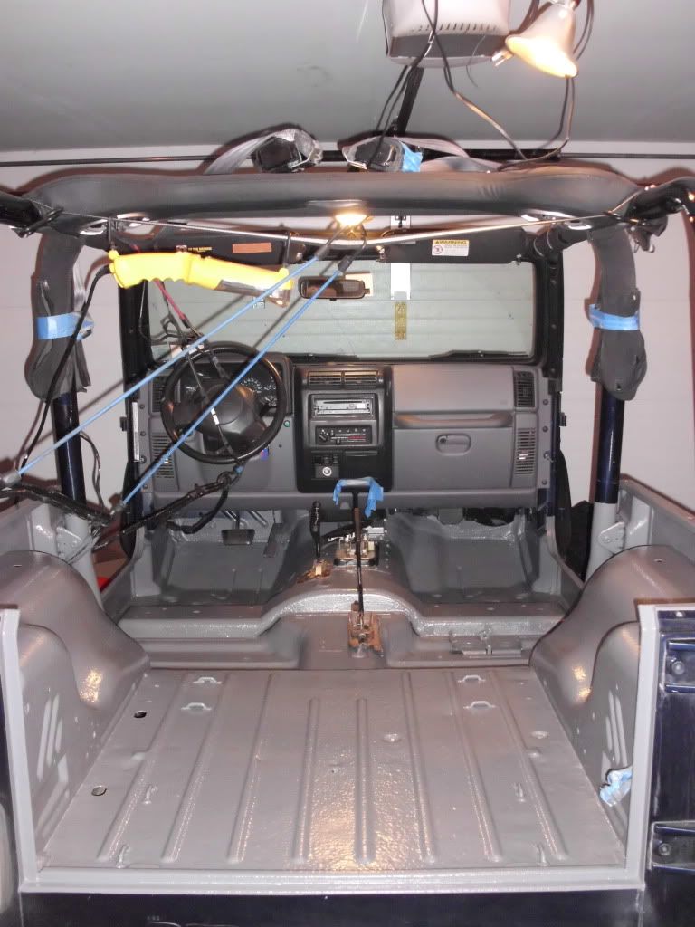

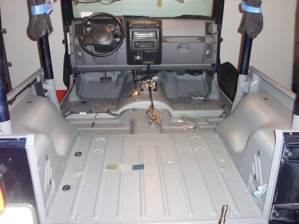

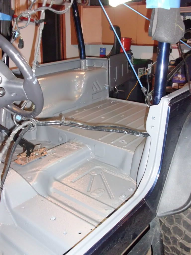

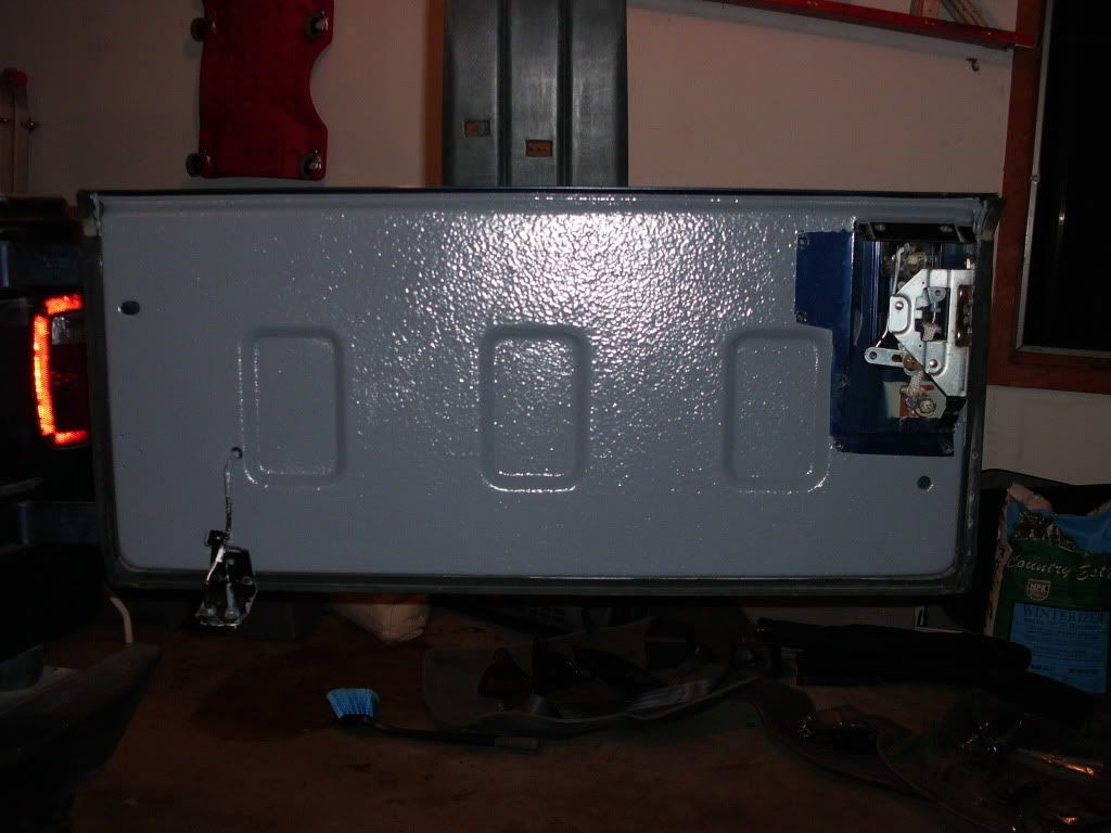

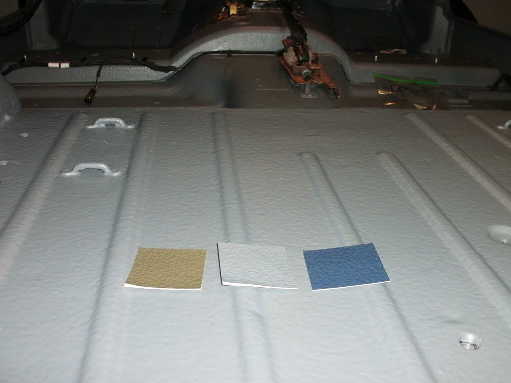

Originally Posted by SideshowBob024 View Post
Just finished second coat. Dry time was like 3 or 4 hours in a propane heated garage, at least it was plenty dry for a second coat. I was fairly humid/raining the whole time outside, maybe a little less inside. I had no problems going through rollers but I did use an extra brush, I think you should have 1 to 3 extra cheapies depending on if you have a friend to help.
1 Gallon kit just BARELY got me through TJ, I was a bit sloppy on application I guess but it was close doing all up under the sides and pretty far up cage etc. The Med Gray looks just awesome I can't wait for the cured product!
When you do it wear shorts and a long sleeve T you don't care about with the gloves.
Some final assembly and dry pics of the Medium Quartz Grey-

it looks so good. looks extra light colored in your pics tho. I thought the med was darker than that, but either way it looks amazing, good job!!!
Thanks Chris!

Great pics! Tailgate looks Med Quartz but the rest of the pics look light. Matches the interior great. Congrats!

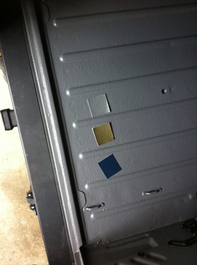

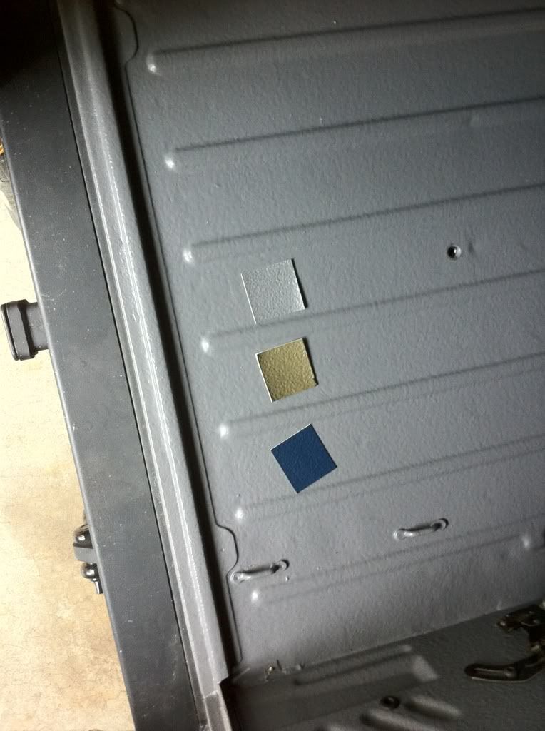

The white balance seems pretty good on that little point and shoot, and in the one pic that's the Magnet Paints sample along with OD green and the blue. It's definitely pretty light but it's super damn close to the stock dash plastic and the magnet sample. The last two pics without the flash are the most real world pics.
I love it.
The only thing is I dropped my tailgate bar (******* it!) on it while it was still curing and I have a little chunk about 1/4"x1/8" out on one wheel well. I want to do the rollbar anyways, so I will just touch it up at that point.
Magnetman plans for a 1/2 gallon size? It would be great for like bumpers and wheel wells and isht. Also I want to do some black and some grey and would love to get a 1/2 colored and a 1/2 black.

Is chip on the right here Midnight Special?
Manufacturers of CHASSIS SAVERô Rust Preventive Truck & Auto Underbody Coating
Connect with us on:
Watch How To Videos:
magnetman is offline
post #5985 of 13352 Old 10-15-2011, 01:08 PM
SideshowBob024
Location: Cypress
Posts: 1,197
Yeah, it's the Midnight, it may be a little dirty.
I just took these with iPhone-
No HDR no flash-
HDR-
