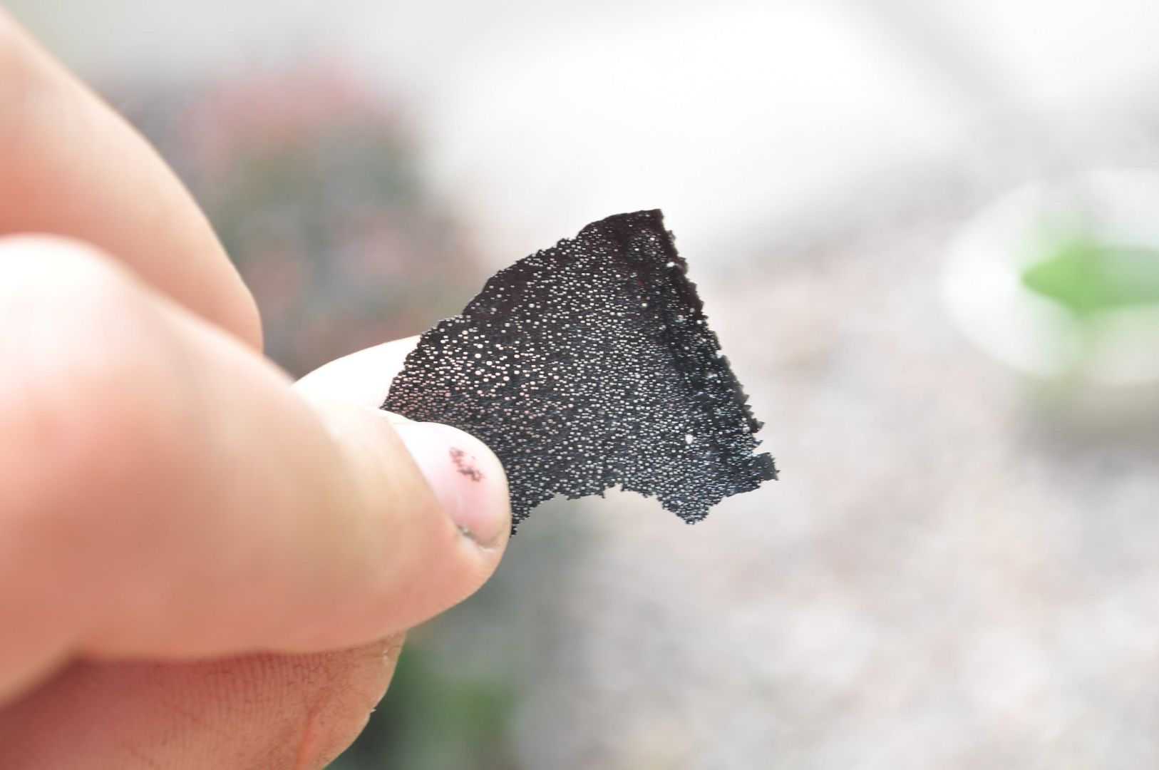

Hey guys! It's been a while, due to my computer being broken (which I fixed) but I came a cross some pics of when I monsta'd my bumper. I don't like the looks of them at all, they are air bubbles in what I think is a large chip of CS. Any idea what happened, Eric?

That doesn't look right at all. That is the CS? Doesn't look like it was able to grab to the bumper.

Might've been applied with too thick of coats, the air gets trapped underneath I noticed this once when sandblasting some dried CS that I applied really thick..

That happens when it's applied way too thick
What did that chip come off of?
