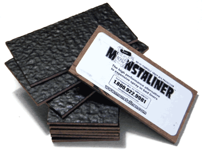

FREE MONSTALINER™ Sample Panels are available
Click Here to request one
