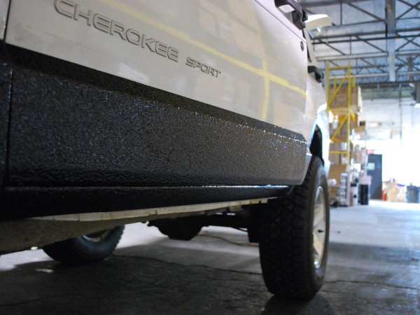

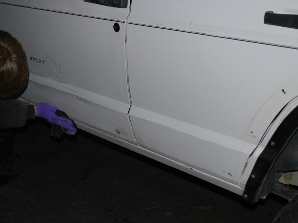

Tomorrow we have a local forum member stopping by our Amityville location who wants to do his Cherokee rocker panels, wheel wells and perhaps some other exterior areas in Monstaliner.
Will post photos of completed job tomorrow eve.

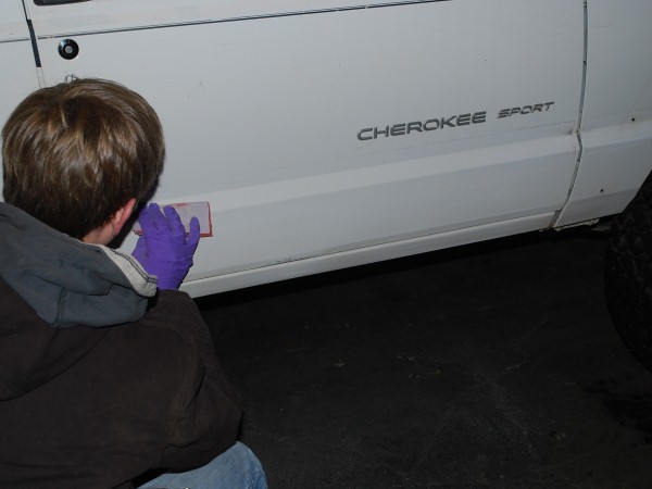

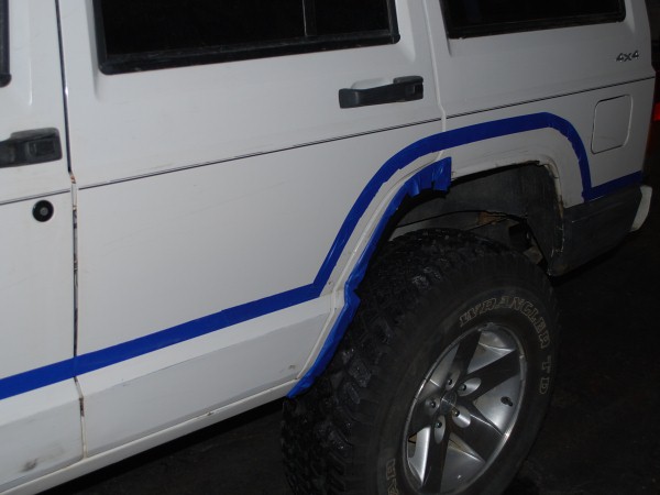

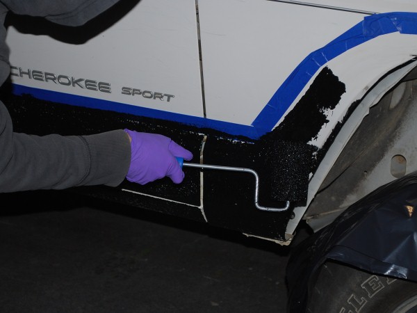

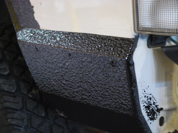

Cherokee Rockers w/Monstaliner
Originally Posted by Viencent View Post
cant wait to see them

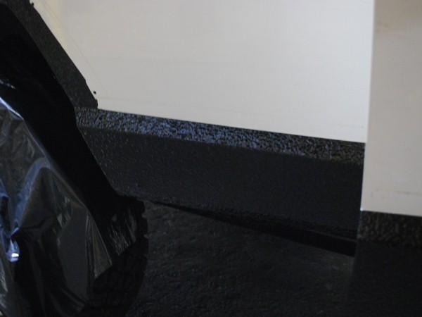

Here's some photos from today. The owner opted not to do wheel wells until weather gets warmer. Will post more tomorrow after fender flares get reinstalled. Coating was still wet when these were taken.
Note: Be sure to pull tape immediately following 2nd coat for cleanest lines
