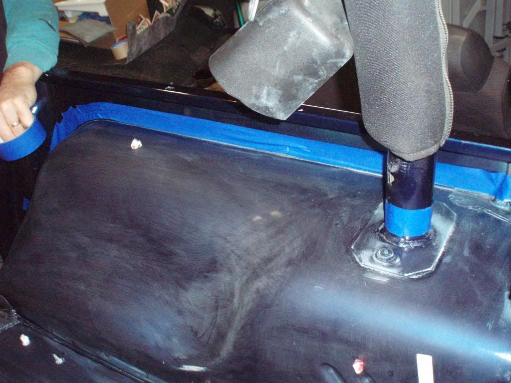

The word "through" the clear can be misleading. You don't need to sand "off" the clear. The surface needs to be scratched up significantly.
When scuffing dark color tubs, it's very easy to see when you've scuffed enough.
When your paint is very light like white it can be difficult to see when you've scuffed enough. Scuffing should generate a fine white powder as you go. If you're not making dust, you're not scuffing hard enough.
Thank you erickpl for this great photo
edit: see the back door now with difference of before and after scuffing

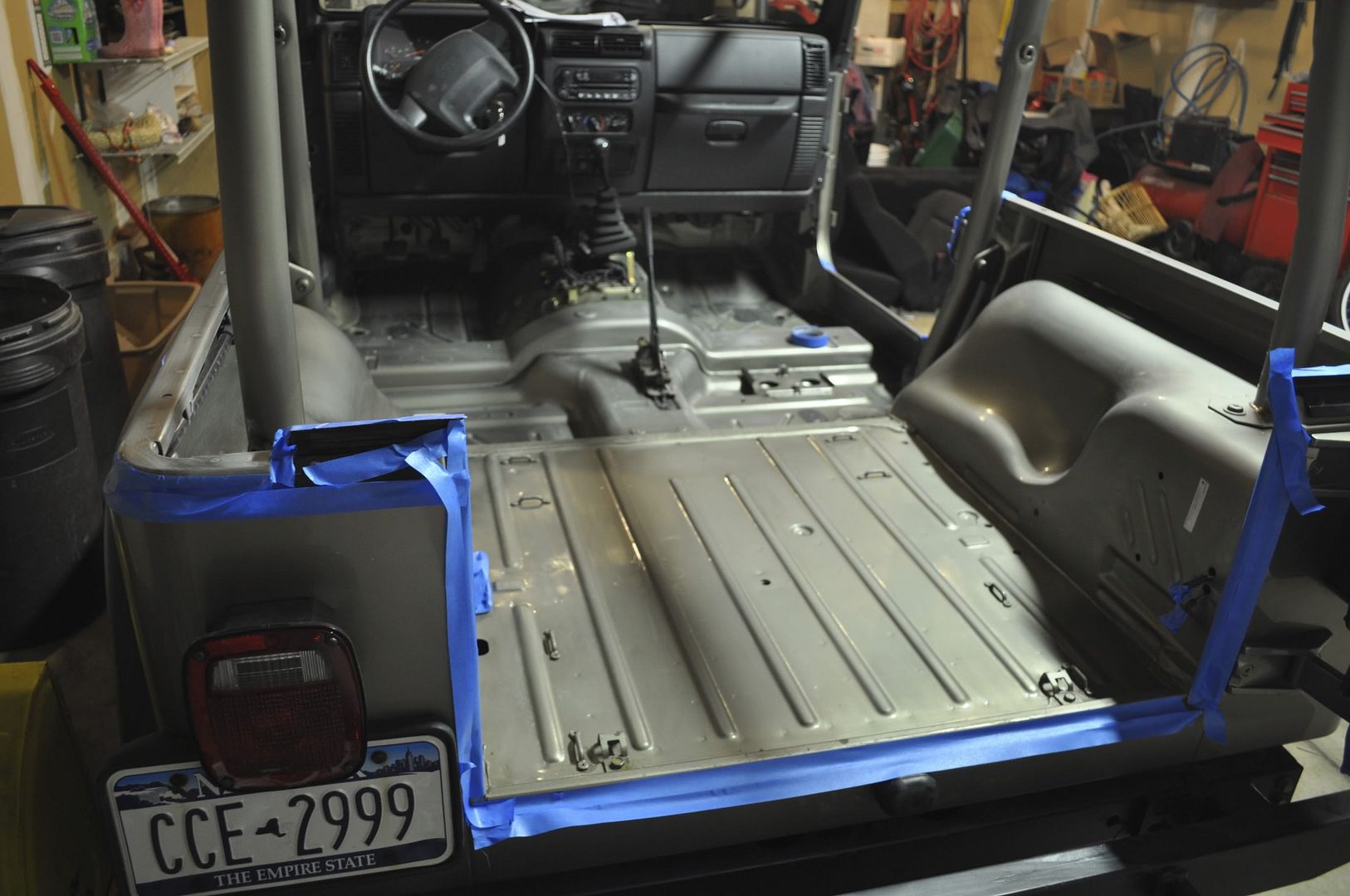

Here is a picture of my install... Notice how poorly the scuffing shows up on a lighter color?

Cleaner yes, but remember for the person who has no idea how much to scuff or when is enough your picture does not show the direct results of scuffing.
Paul's photos below are without solvent wiping which is important to see to eliminate confusion.
