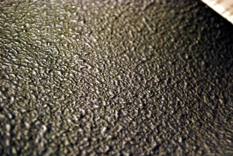

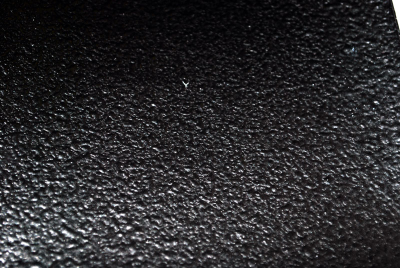

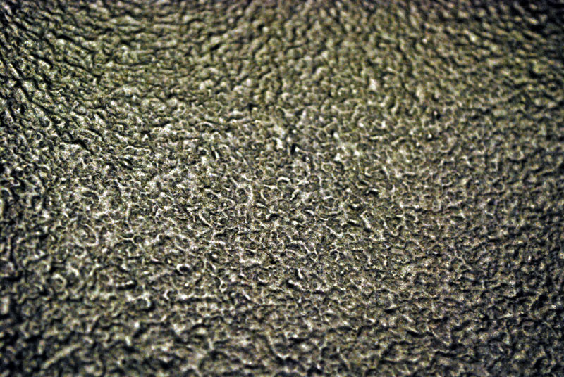

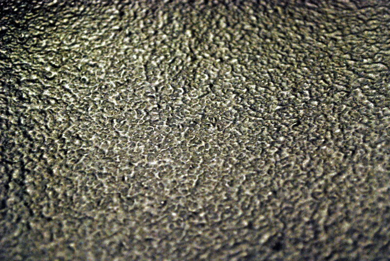

Monstaliner spray photos
Originally Posted by DaleII View Post
Sounds good. I will be looking forward to seeing some samples of the product.
Here's some Monstaliner spray photos. Walcom Shutz gun at 80 to 100 psi (really good tip control)
