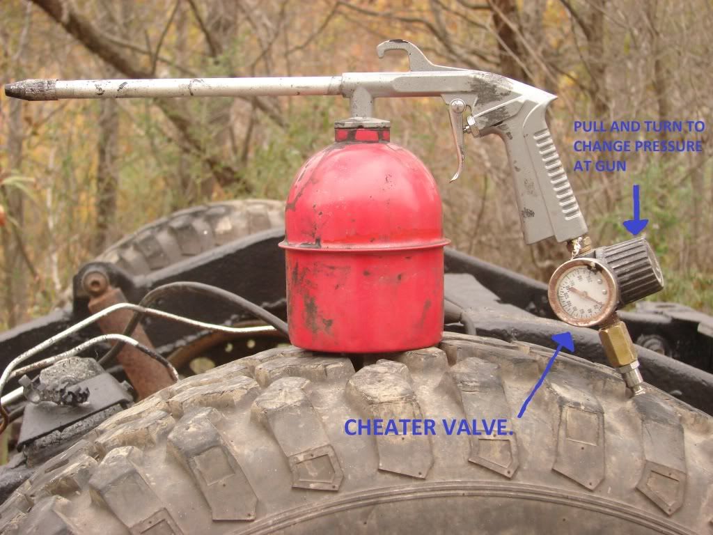

i used about 40# of pressure with this gun.
this is the cheater valve magnetman is talking about. it's easy to use and makes the job alot easier than having one on the compressor. you simply pull the black thing up turn to increase or decrease the working pressure.

I thought most guns have those. I know our cheap hvlp gun does. I love how working pressure at the tank is always greater than the working pressure of the gun.

Yes, we're going to stock one with the pressure gauge as they also come without as in in my pics of of my crazy spray setup.
By the way, this gun shows how different Schutz guns can be. This one has no front extension and a good adjustment at the tip. This is a WALCOM gun which we stock now.
like i said it was an el-cheapo gun i anticipated only using once. i bought an entire kit : shutz gun, paint spray gun, tire pressure gauge, a straight blow type gun, and 25 feet of coily hose for $40 bux (yeah it was all cheap). i hunted around and cannibalized the pressure regulator from my dads roofing nailer. now that i have used monstaliner, i will be buying a better gun, i forsee everything i own being coated in monstaliner, i wonder how well it would work to paint my house in.
