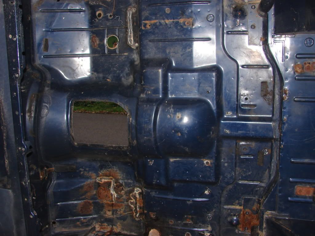

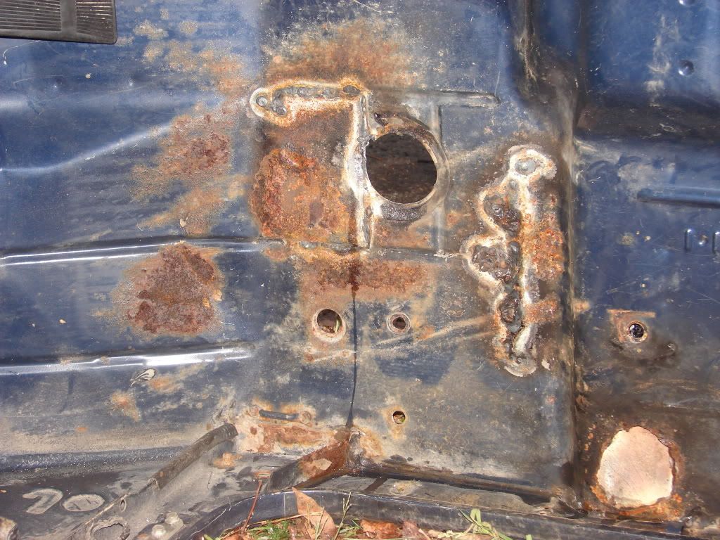

Posts: 2,167
here's a few pics from my build page.
full underside with a thin coat of chassis saver under 2 coats sprayed on MONSTALINER. maybe it was my shutz gun but i had to thin it ALOT to get it to move through the gun at 60psi! after a good thinning i had great results at 45psi.
firewall with same treatment.
rear frame with 2 coats chassis saver, 2 coats rolled on main frame surface, and 2 coats sprayed on in those hard to reach places. and yes that's a 5.2 sitting there all pretty like.
for those spraying this stuff it goes ALOT further than rolled on in one coat. but after 2 coats sprayed i think it's thinner than what 2 coats rolled would be. with all that i have in the pics done i still have about 1/4 of a gallon left. after rolling the frame i thinned the remainder of the gallon thinking i would use it all on the body and the hard to reach parts of the frame. after finishing i found there was still about a quart left. i did a float and hopefully it will keep till tomorrow afternoon. i plan on taking on a few trouble spots on the inside of the tub to get them sealed up until the COLORS come available.
here's a few pics of the troubled inner tub.
it's not much to look at... but it's mine.
