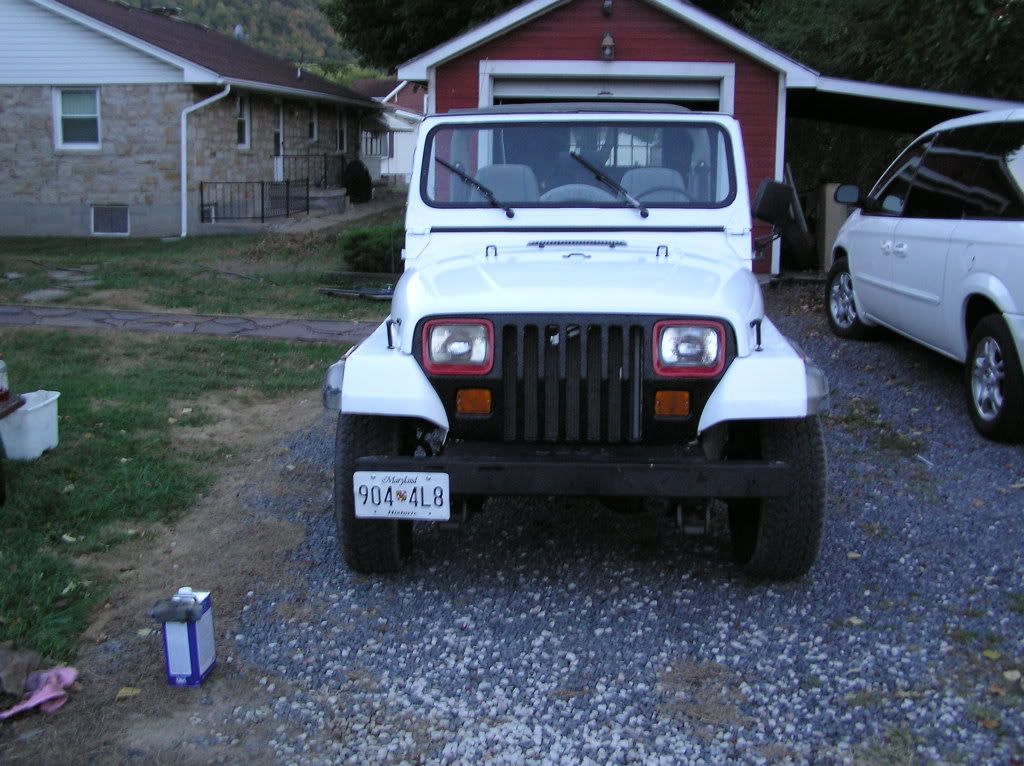

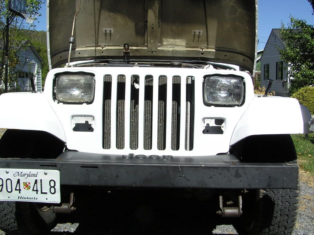

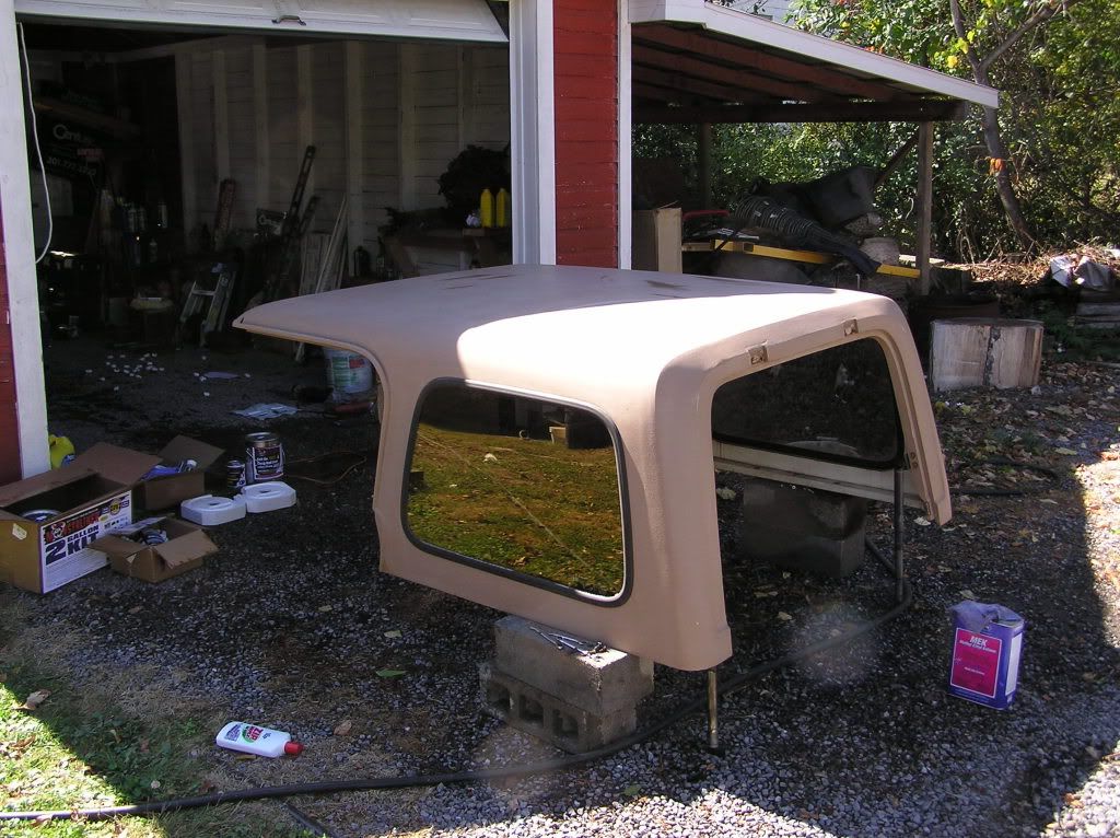

I finally got to break open my monstaliner and figured I'd start with my hardtop. I plan on doing the tub later. I had a little extra so I also did the grill. It definitely took the most time doing the prep work. But then again, it's well worth the effort. I was a little worried with the 6-10 hour shelf life and waiting between coats, but it was fine. I did notice three bubbles, but I actually saw them pop up and popped them and the second coat took care of that...not sure what caused it though. It was a good day, low humidity and not too hot. I can tell you why they don't recommend doing it outdoors....After the first coat, a breeze came through...I looked up and I had styrofoam noodles all over my hatch! lol.
I'm very happy overall. I could have done a little better job and still have a few edges to touch up, but I am definitely a satisfied customer. Here's the album:

Nice to see a hard top job. That was in the back of my mind as a project if everything works out well.
Can you fill us in on the prep?

That totally refreshed your top. When you get a chance, report back on how the hard top is in terms of sound and possibly insulation. It should deaden that hollow cave sound that comes from them.
Yeah, I hated that color and really with the shine and texture, the look to me is awesome! I love it. For prep, well, I read through this thread a million times, read through the directions and read through Luckrider's writeup several times. The top I have is off of a 79 CJ and it's got a little texture to it so I wasn't sure if I should do anything different, but in the end, I didn't. I took my grinder and cleaned up any spots I saw that loked bad(be careful with a grinder, I was careless and have a nice gash on my knuckle for it...which made the entire day a little tougher without the use of that finger)I washed it down good twice with just good car wash. Then I used the pads in the kit(I cut them into strips) to rough up the existing paint. I started to use the MEK and a rag to clean up after that, but there was alot of crap so I ended up washing it again with car wash first and rinsing it off, then hitting it with a fresh clean rag and MEK. It is very important to keep a clean rag involved. Next, I taped everything up. First I used the brush and hit all the tape areas, edges, and hard to reach areas. It's really important to follow the directions and "dab," not stroke with the brush. I decided to go ahead and remove my tape after the first coat dried a bit and then only re-tape the sections where I didn't cover well. I also took the roller over as much of the brushed areas as possible. When I was using the roller, I noticed it worked alot better if I went in one direction....going back and forth seemed to make it look different...as well as turning the roller on the surface. When I did that the liner would leave spots not covered. These spots were easily covered with the second coat though. By the way, I bought my kit in the spring, it's actually dated on the cans in April and Just opened the first can this weekend and really saw no issues. If I think of anything else that will help, I will edit it in. If you have any specific questions, just ask.

I covered the can as directed after each time I transferred material to the paint tray and still got the skin & significant thickening, hence the reason for my post.
I also thought of using an MEK float AFTER the incident happened, as I put one in the can of the remaining unused chasis saver.
Thanks for making the recommendation Magnetman. If I were to do it again, I would still mix a seperate batch for each coat.
You should place the MEK float tidbit in the Monstaliner instructions for sure.
