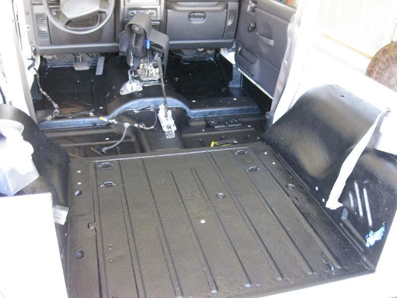

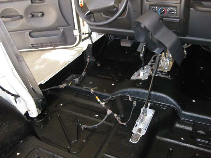

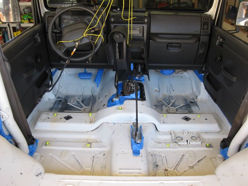

I finished up mine this weekend, posted the results/commentary in LuckRider's thread:
http://www.jeepforum.com/forum/f9/mo...ml#post9585444
Pics:
Before:
After:
Pics:
Before:
After:
Looks good. I'm wondering about how long this stuff takes to roll in and dry completely..? I'm just a po' college boy lookin to save his floor...
Prior to yesterday, I had the jeep totally prepped and all the materials laid out in the garage and ready to go. Entered the garage around 9:30am and was done around 5:30pm with only a 1.5hr break between coats. Weather (heat and humidity) will alter how fast the liner dries...so 1.)my between coats time was very short and 2.)mine will be ready reinstall seats, etc fairly rapidly due to this
