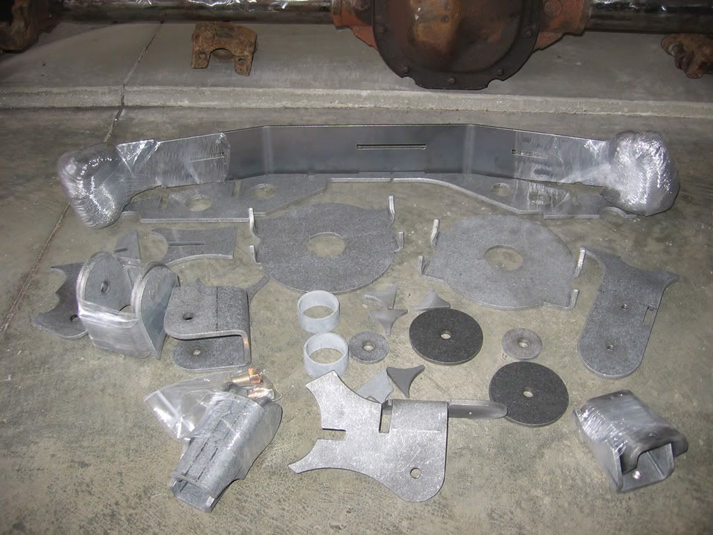

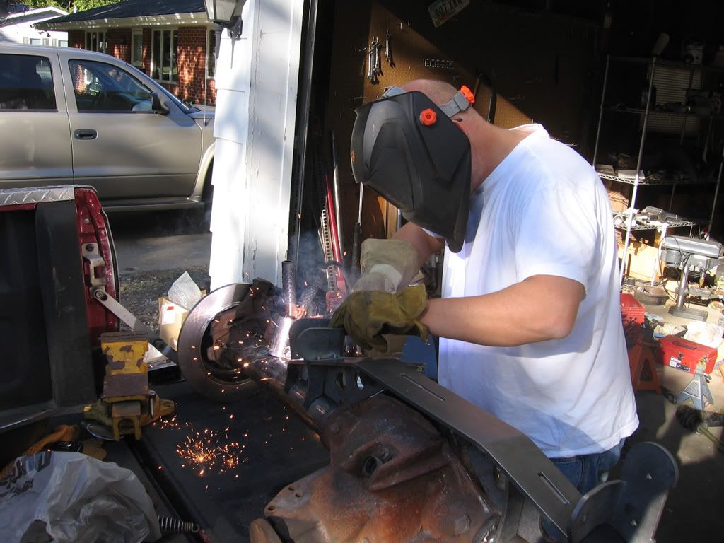

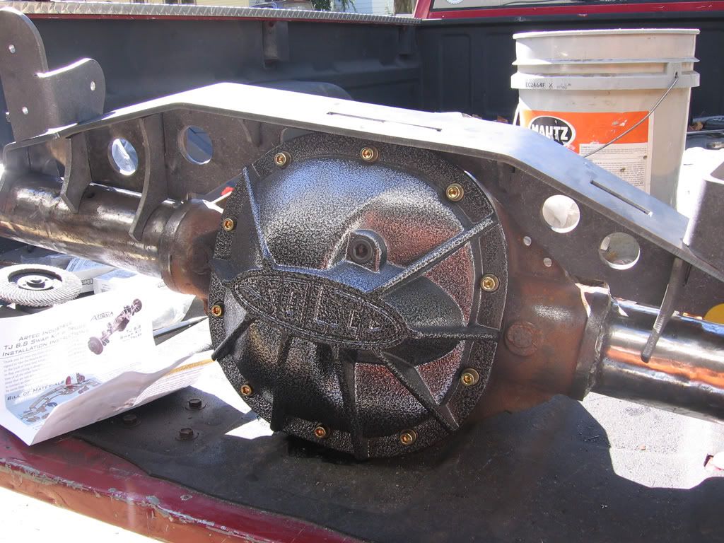

Got my TJ kit last week and finally started in on it today. Great product, although there is a LOT of welding. Going to be a great axle build.
Thanks for the excellent product.

Looking good although I think you might want to look at your pinion angle. The truss should be straight vertical and the pinion should be rotated up. It looks like your pinion is almost rotated down which means when you bolt it all up the truss (upper link mounts) will be way too far backward.

Right. I haven't even tacked it onto the axle yet; was just tacking the truss components together and using the axle to ensure the pieces were well-aligned.
