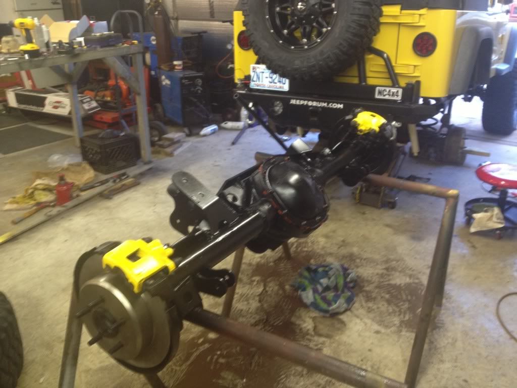

Finally got mine in (the Jeep) a few weeks ago. Ordered the damn thing in July. School sucks.
Artec, the shock mounts were a major issue for me. They didn't line up correctly when put on per instructions. Also, they were way too thick, so the shock body would hit the bracket before the holes would come close to lining up. We had to cut them off, grind them down significantly, bolt them to the shock, and use a jack to compress the shock and tack the brackets in correctly. Otherwise, the Artec kit worked pretty well.

Did you put a bolt threw them during the welding process? Could have warped... Also their instructions say to tack, fit, then finish weld. So if you tacked them and tried them out first you could have addressed the problem a little easier.

No bolt but it didn't warp. Didn't have time to install it, tear it back out, an reinstall. That would take a while. But they weren't even close. It seems I'm not the only one with this problem. A review on their site says the same thing.
