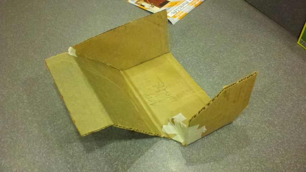

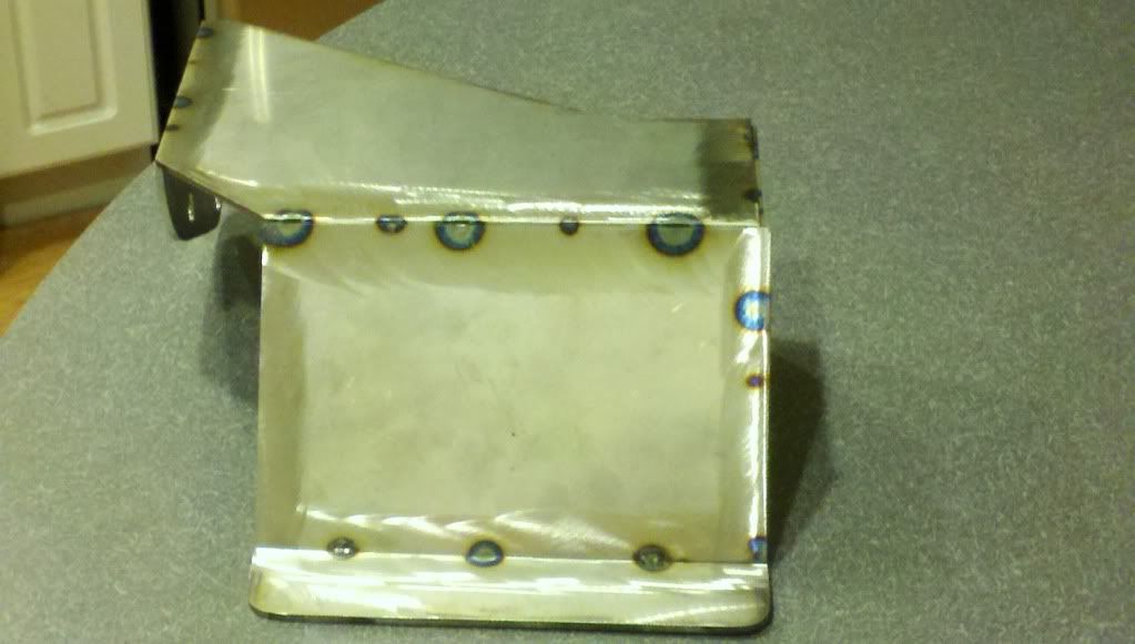

I was about to purchase the 1/4 inch fabtech steering box skid on 4wd tonight, had my credit card number in and was double checking my order when i decided to make my own skids. About an hour ago i ran outside with a flashlight, masking tape, cardboard from my garage and a knife i made a mockup of what it should look like so i know it would fit before i decide to start cutting material.
Finished the mockup:
Ill have some more pics up tomorrow

post #2 of 25 Old 09-14-2011, 11:19 AM Thread Starter
04WJny
Location: Long Island
Posts: 614

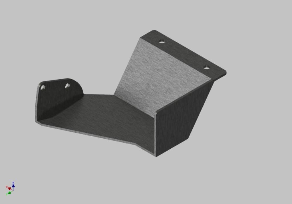

Got my hands on some 3/16 inconel 718 scrap at work. drawing up final dimensions in autodesk inventor and building soon

post #7 of 25 Old 09-17-2011, 01:14 PM Thread Starter
04WJny
Posts: 614

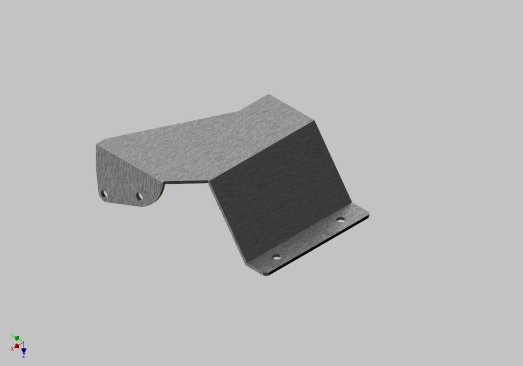

Made a second cardboard mock-up today in the light and changed it up from my previous design. I just modeled it up in Autodesk inventor.

post #15 of 25 Old 09-19-2011, 11:41 PM Thread Starter
04WJny
Posts: 614

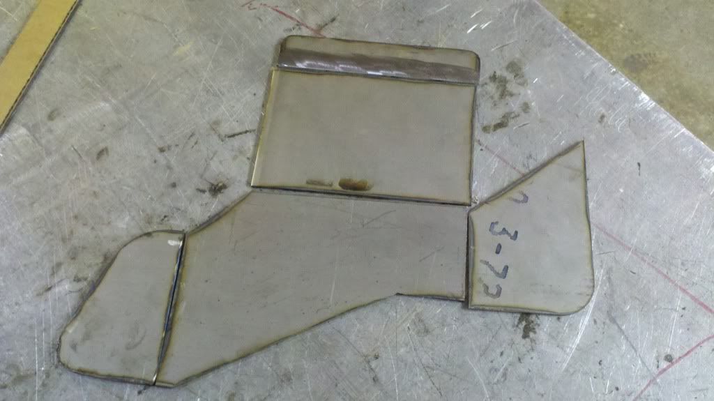

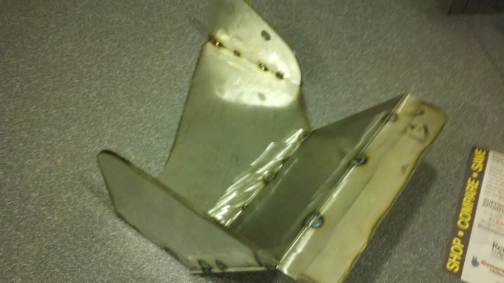

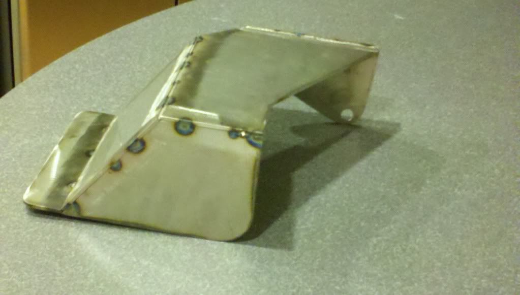

Pretty big progress today, i cut the inconel with the plasma cutter and ground it flat, rounded the corners and tacked the pieces in place. hopefully it fits the first time when i place it tomorrow lol.
Cut up and ready for tacking:
Finished tacking:
Going to try on tomorrow and weld completely tomorrow after class
