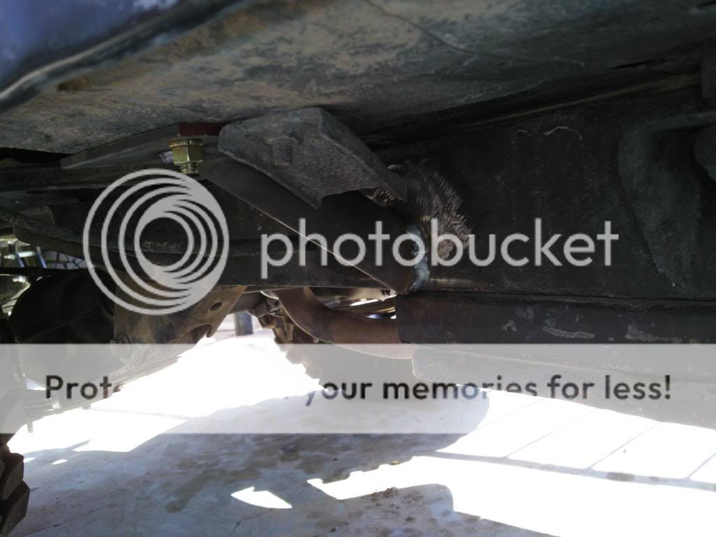

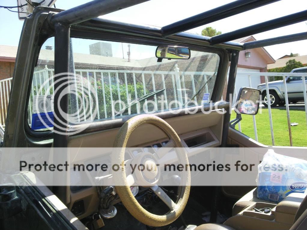

Originally Posted by Ironworker709 View Post
As was said.."to each his own" as far as the A pillar height,i've seen them above,at level with and below the windsheild,i see no revelance as to what is a "must",it's a personal reference.
I can't see where the mods he did made the stock cage any more dangerous than it was,if anything helped it out a bit.
I think the same as everyone else as far as the down tubes,should of bent it to fit snug to the dash,they gotta be some Knee Bashers ,especialy if it was me gettin in there.i am 6'4"..with a 36" inseem..long legs..lol,,BUT..i've seen ALOT worse jobs on them too..so congrads on the learning curve and doing it yourself
Maybe I should've used tacky instead of dangerous...and like you I've seen WAY worse on nicer rigs. The day I realized it was safe for me to weld a cage is the day I went to a car show and saw the welds on an 8 second Mustang! They were worse than this picture...I was truly amazed they would even certify that car...

I'm not sure i see how what he did was dangerous. Does it look odd and uncomfortable, yes, but not anymore dangerous then a stock configuration. Still doesn't mean i understand why those bends weren't put in...
But whatever. Also, When adding onto the Stock cage, it'd be awefully difficult to get the A pillar above the windshield frame without moving the stock part towards the center of the b pillar to raise it up. and then how would it bolt to the frame.
plus in order to keep the front supports parrallel or whatever, you'd have to raise the b pillar, otherwise i think it'd just look funky with weird angles. Really, there's not too many options when adding to the stock cage.

like i said before i couldnt finish the a pillar with a support bar because there was no more DOM tubing at the metal shop...both metal shops here in town are sold out so there wasnt anything i can do about that...am i finished with the cage? No not at all....and how some can say this cage is more dangerous then stock is kind of an odd suggestion to make...i didnt bend the tubes because the tube bender wasnt around and doesnt do too good of a job...so to say the job isnt good because of straight bars is kind of ridiculous IMO....once the cage is complete ill be better off then a lot of other jeepers without a cage and im still a lot better off now...and to those who are criticizing the cage lets see what you have that makes yours more superior then mine...
Actually we were talking about the rear loops getting a cross bar. If you're planning that bar and the cross bar for the bottom of the windshield, cool.

As mentioned in my post above, I should've used a different word besides dangerous.
Technically it could be dangerous...you're bound to get a knee or foot caught on that a-pillar and face-plant on the concrete...then I can say I told you so...

I think you did just fine. Lol! It's your taste and your jeep.

his effort is totally fine. often web wheelers confuse a trail cage with a comp cage.
and the whole "bar above the windshield is complete nonsense. if you put it on its lid, not only do you have more to worry about then the easiest part of a jeep body to replace, but the bar would have to be significantly higher to do any good. a couple inches wont do it. who the heck wheels with the windshield up anyways. the whole point of a jeep is to put it down.
i think anyone who criticizes a home effort needs to post up their work as well.
i dont like the straight bars myself but who cares. i bet his straight bars are stronger then my bent bars. go wheel it and have fun.
i bet a few people whos trail cage desires have been halted by a lack of a bender might look at your work and be inspired to get something better then stock done.

agree with the last two posts...in the event of a rollover the last thing im goin to be worried about it "oh man my windshield is getting crushed"....instead i think ill be saying "oh man im glad my head didnt get crushed"...but a lil constructive criticism never hurts anyone...

A for effort for sure, C for execution.
is it beter than stock? sure, anything is better than stock really. no matter what it will add some support for sure. is is great? no.
