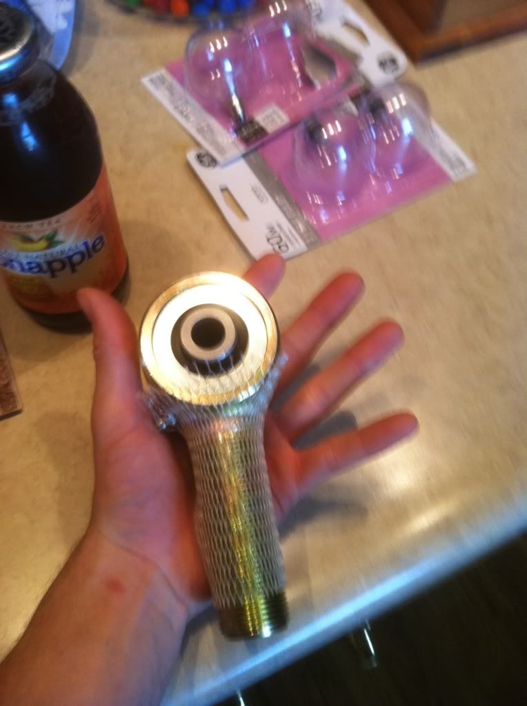

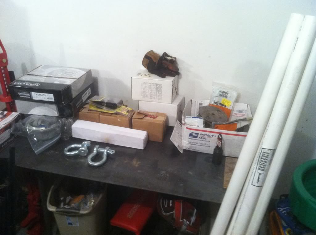

Well I didn't really fabricate these but I'll be welding them on when the rest of my stuff gets here for my axle swap/coil conversion! What I got was upper and lower coil mounts with retainers, (8) 3/8" thick link tabs, 20 weld on skulls for some stuff I'm making a cool weld on shackle mount for my most recent bumper and a bangn new battery box for my yellow top optima. All of this stuff is from my new favorite vendor, Ballistic fab! There stuff is awesome! Super beefy mounts, killer prices and pretty good shipping. Check em out In the mail, I also have coming 4 1.25" johnny joints for frame side links, and (4) 7/8" heims from ruffstuff for the axle side, triangulated 4link brackets from K.O.R.E. are going to be ordered tomorrow along with some steel for my 8.8 truss I'm making. I never would have started this whole project had I not found pbb! Oh well, it should be fun and interesting. Really, the last thing I need is an sye. What vendor has the best prices for the aa sye?? Any of you guys running it? Good, Bad? Let me know

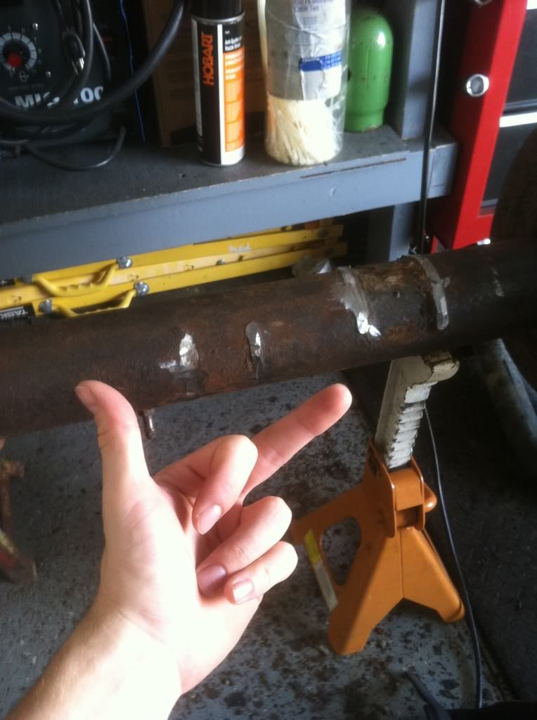

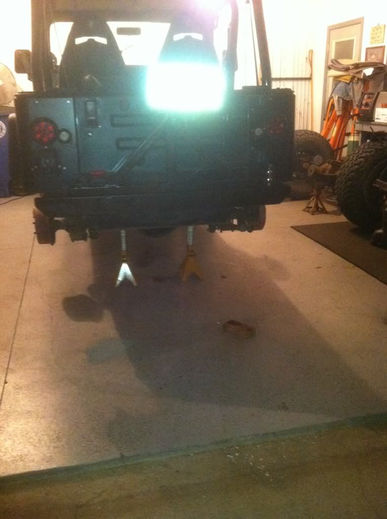

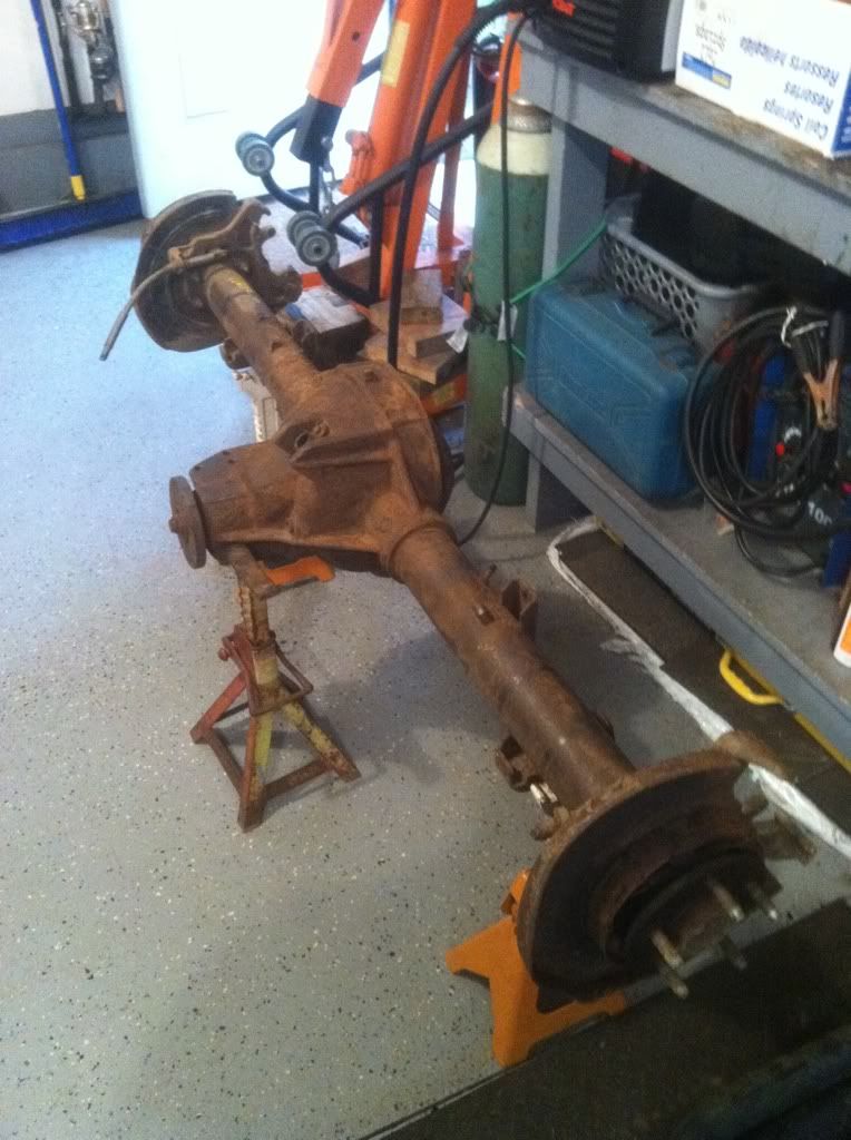

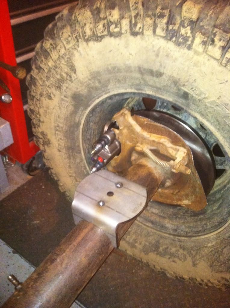

So many projects at one time on the jeep along with college in the summer, camping and work really is delaying my build! So I finished my rear bumper, finished my rocker guards, and put in my new battery tray from ballistic and now it is time to put in some work on the new axle. Took the calipers off, rotors, sway bar, brakelines and started to cut off the spring perches. I only had one cut off wheel left so I'll have to run to my welding shop tomorrow and get some more. Everything stopping related on the axle will be new so I don't have to worry about failures down the road..

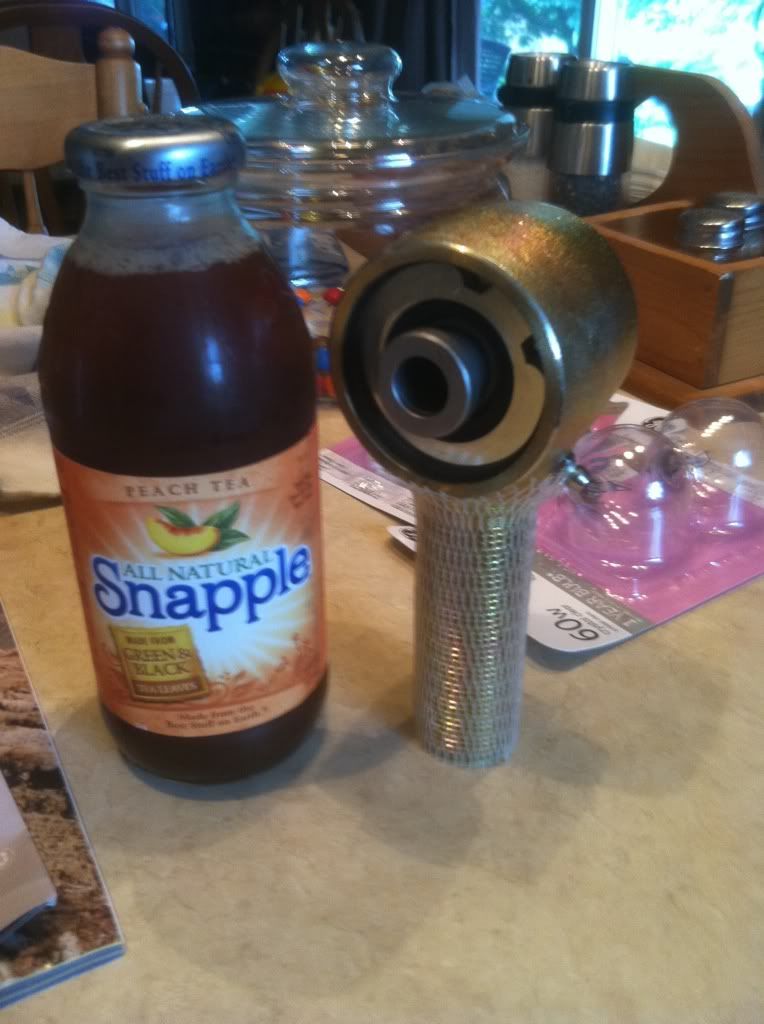

Got a few more parts to the pile. Forgot I needed tube inserts and jam nuts since aluminum links aren't in the budget. DOH!! Again, these are from ballistic. These will be for the 1.25" Johnny joints that I'll be using frame side. The ones on the bottom are for my lower links which will be 2"o.d. .25" wall dom and the tops are for 1.75" .120 wall dom upper links. I also found some time in this 110 degree weather to cut off the brackets from my axle. On another note, I told my girlfriend that I needed some jeepin' shirts. Today she comes up to work and hands me two shirts from ballistic, a poison spyder tee and one from genright. Is she a keeper or should I keep looking??

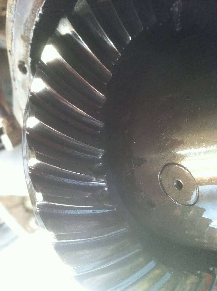

Figures..Soon as I get my new axle for the build, my turdy 35 takes a crap! I'll have pictures in a bit. Chewed up my ring gear. Can't see much more because of my locker. PO told me it had welded spiders but it looks like a detroit to me lol...

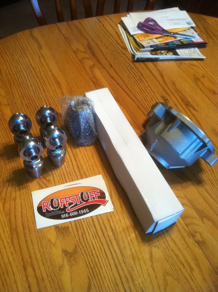

Another small update here. I got my new calipers, rotors, pads, shoes and soft brakelines done on the 8.8. My heims for the axle end showed up today along with my s.y.e. Ruffstuff has THE best shipping! 3/4"X7/8" heims with S.S. high misalingment spacers. Also, got the s.y.e. from here, http://www.performanceoffroadcenter....07052fe399c44f .

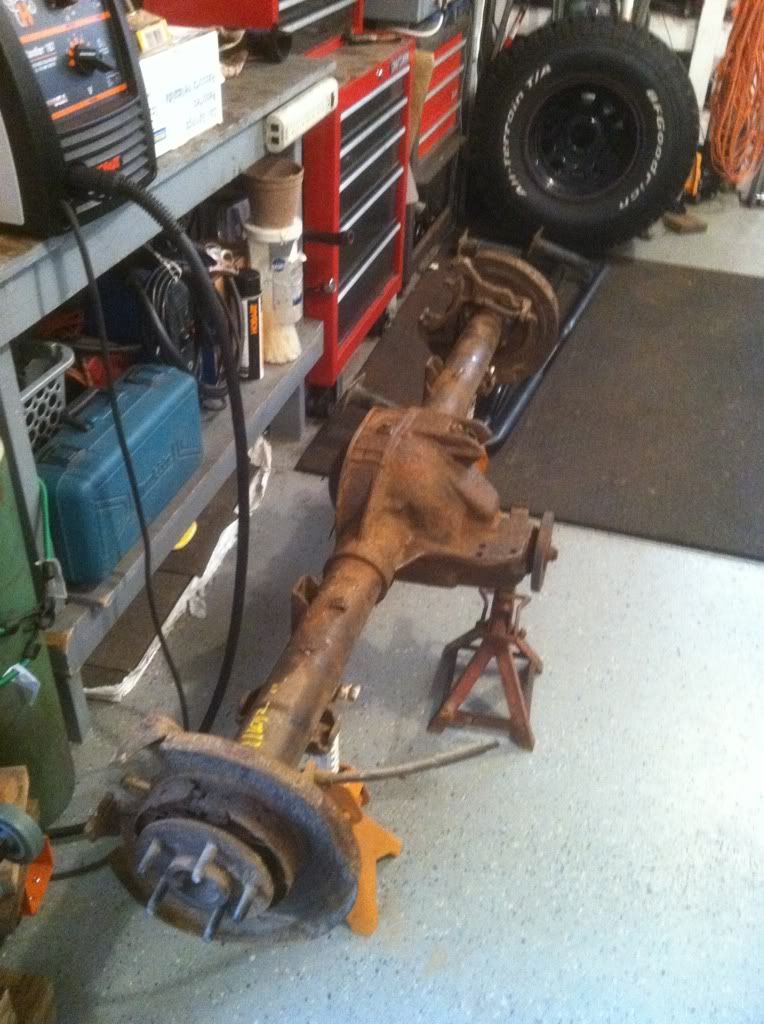

Got the 35 out today using my favorite tools, bfh, sawzall and the grinder. Also, scored some free stock TJ coils. I primered them up and ran out of paint. So I'll pick some up after I get off of work tonight. Tomorrow will be a big day, because I'll have all of my crap and I'm off work so I'll be super busy.
