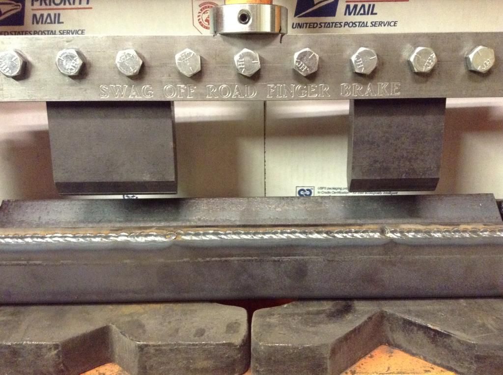

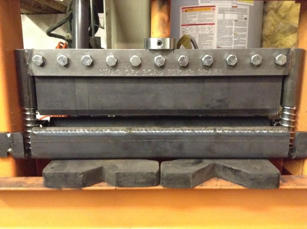

Got this in the mail today... more pics after it's assembled.

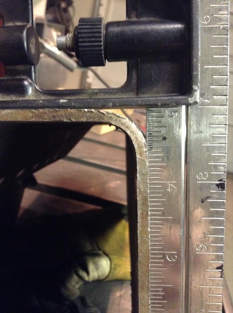

Got it all assembled. I must say Swagoffroad put together a really well thought out piece here. All the parts fit in a priority mail gameboard box, so all 70lbs of it shipped for cheap. With the bottom die as it is, it put about a 1/2" outside radius on this piece of 10 gauge. Probably around 5/8" radius on 3/16" I'm guessing. I'm going to make shims to rest inside the bottom die to get tighter bends in smaller pcs. Can't wait to really mess with this thing!

i want to get the slider kit from SWAG to bend smaller pieces on our Press brake kit. but everything i have bought from them has been top notch, we even use their stuff at work in our maintenance shop on a daily basis.
