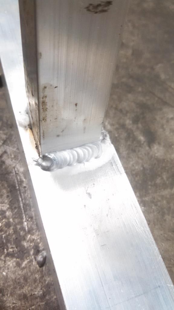

The aluminum is looking better. Still looks like you need a bit more heat and move quicker.

Originally Posted by underpowered
i tried a bit more heat and it blew through extremely easily if i went much higher than what i was running.
What size filler metal are you using? Also what size/type tungsten?
How many amps are you running and how thick is the material?
88 YJ- 4.7l stroker, AW4, SOA, 8.8, hp D30 powertrax no slip,3" front stretch with waggy springs, stock replacement springs in the rear, 35/12.5 r15 goodyear kevlars
youngjeepr is offline
3/32" filler with a 3/32" 2% ceriated tungsten on 1/8" wall 6061 Box tubing set on 125 amps for fillet welds. only running 90 amps for butt and outside corner welds.
Tried pure tungsten, and the ceriated seemed to work better for me. Ground to a point, then blunted before using.
3/32" filler with a 3/32" 2% ceriated tungsten on 1/8" wall 6061 Box tubing set on 125 amps for fillet welds. only running 90 amps for butt and outside corner welds. Tried pure tungsten, and the ceriated seemed to work better for me. Ground to a point, then blunted before using.
Your setup sounds pretty good for starting out.
Personally I set my machine at 150-175 for 1/8" you won't get as fine of an adjustment with the foot pedal but you will be able to start the puddle quicker and weld faster.
I set my machine at 80 when I weld .035 wall .75 tubing.
Some of the best advice I've gotten is weld fast and hot. Don't get me wrong there is a time and place for slow and low heat welding but aluminum is not one of those places.
will have to try a turn it up a bit again now that i am a bit more practiced and see what i can do. Thanks for the tips
No problem. If you have any questions let me know.
