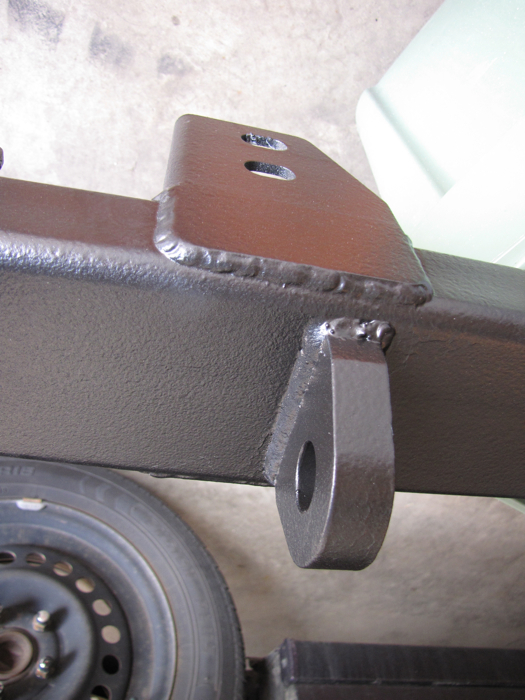

Here is a rokmen DIY front bumper I just did for a friend...
Used and Old (+10 year) Craftsman 120v Mig welder. It was their top dog in the 120 line.
Flux core. could have tied in the edges better... but works for me. I would get a 220v if I didn't get this one for free!
