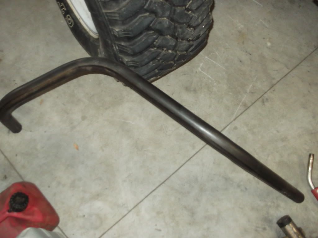

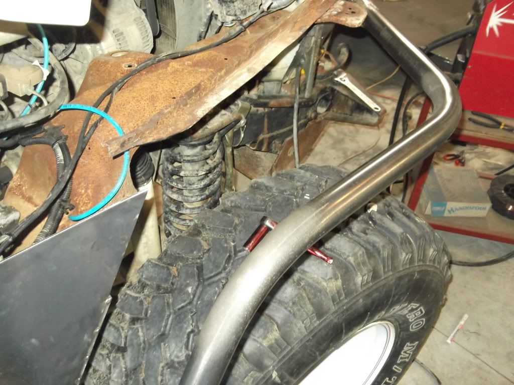

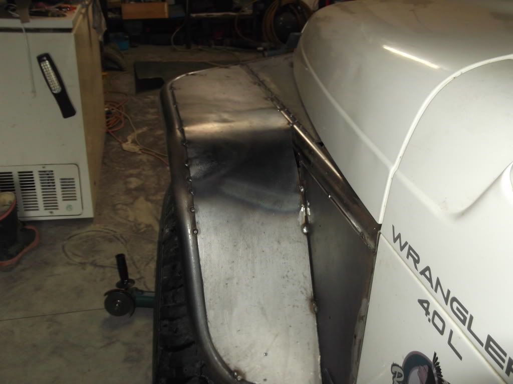

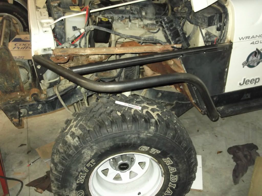

Hi all,

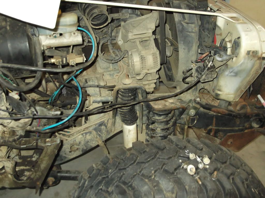

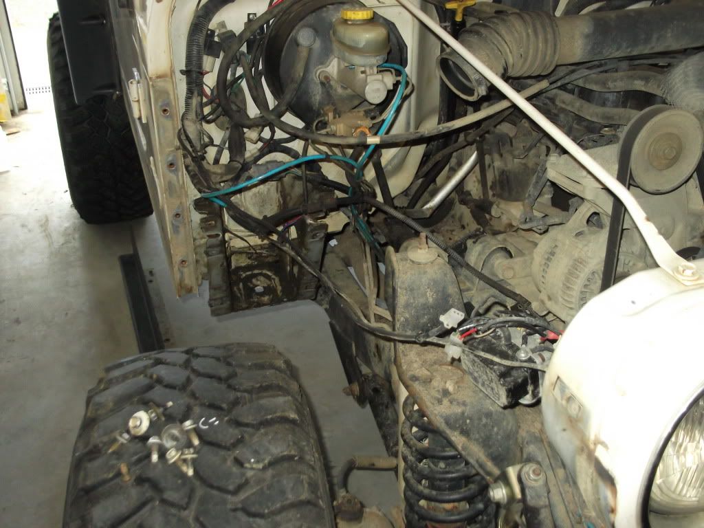

Heres some what mid way through making my tube fenders (Sorry I didnt get any photos of me taking the front apart or making them).
Trying to make them similar to Genright ones but with but more flare.

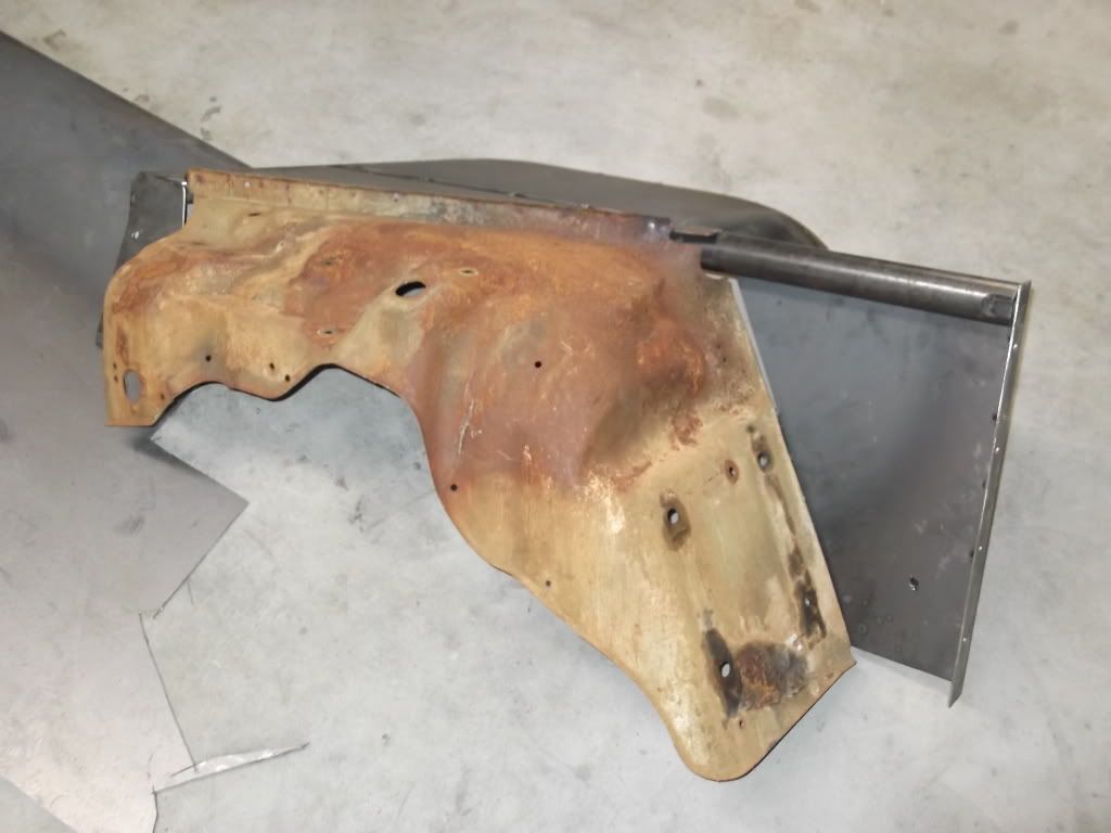

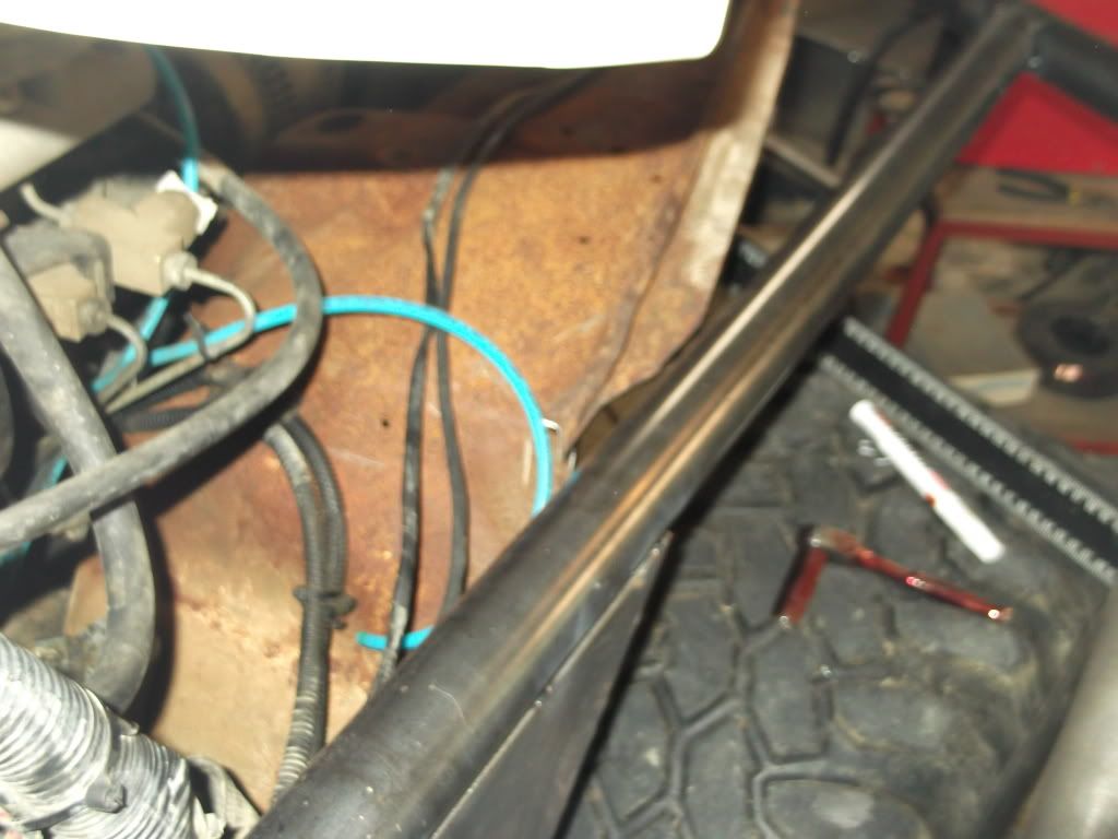

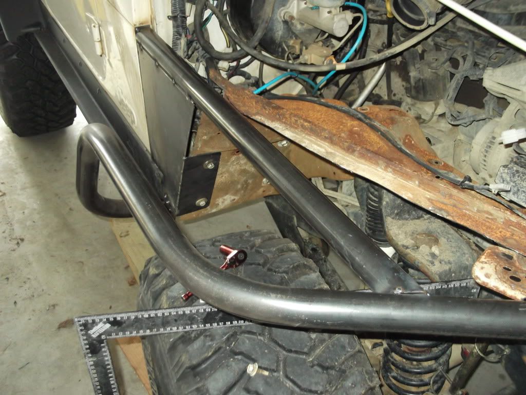

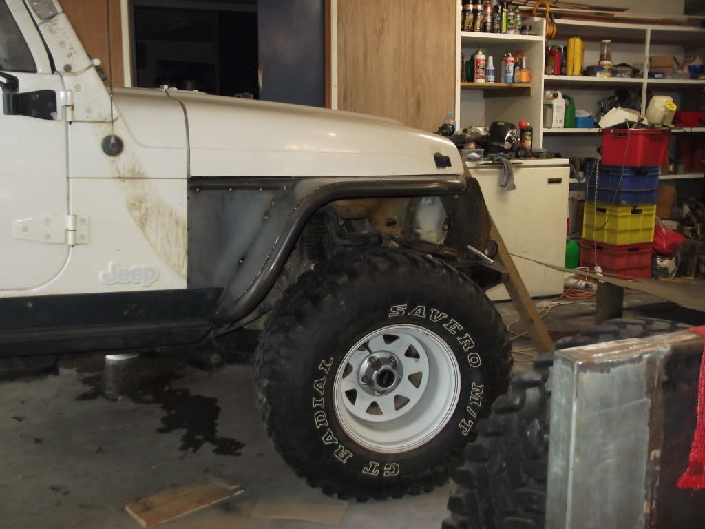

Both sides all tacked up ready to be plated in now.

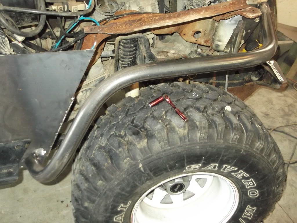

What size tubing are you using? looks great so far

great work!! your tube fender are 4.5" or 6" and what size of tire you are running (33 or 35)

Its 1 1/2" tubing and it ended up being about 8" flare just covers the tyre. tyres are 33".

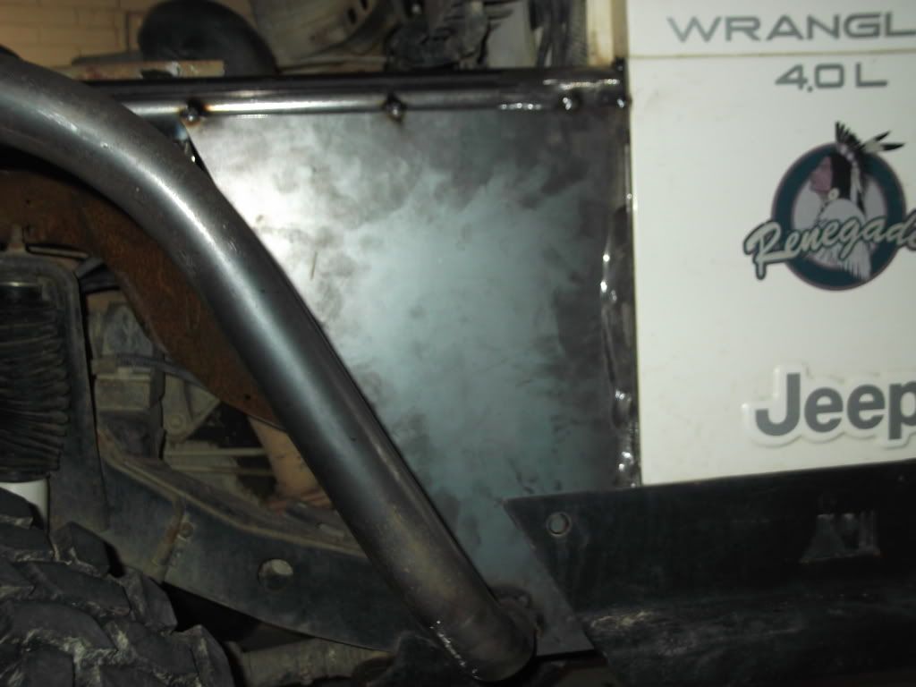

Can i suggest putting a Tube or two in the rear to help brace the load against firewall? I was reading up on some builds and one of them a guy made his fenders like you have done and rubbed some rocks with it and bent one side of firewall back a bit. Just triangulate a couple pieces behind the sheet in the rear.
Looks awesome. Wish my xj was done so I could start the yj!

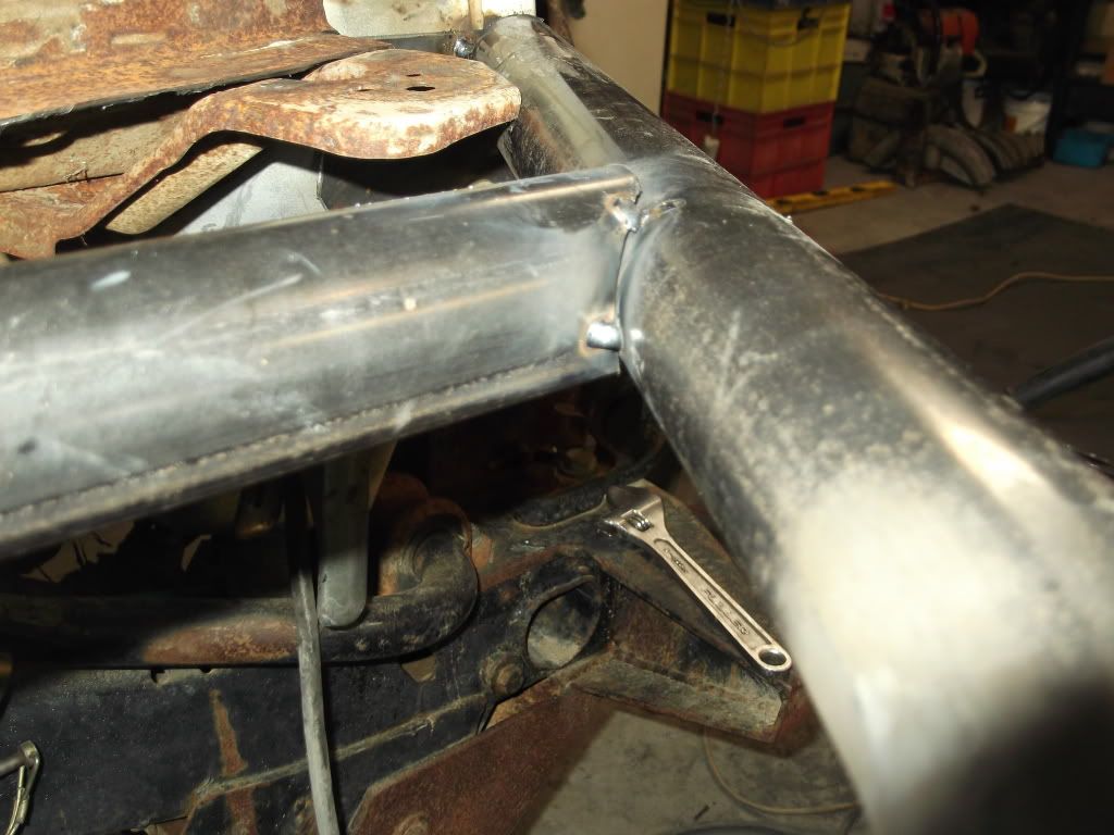

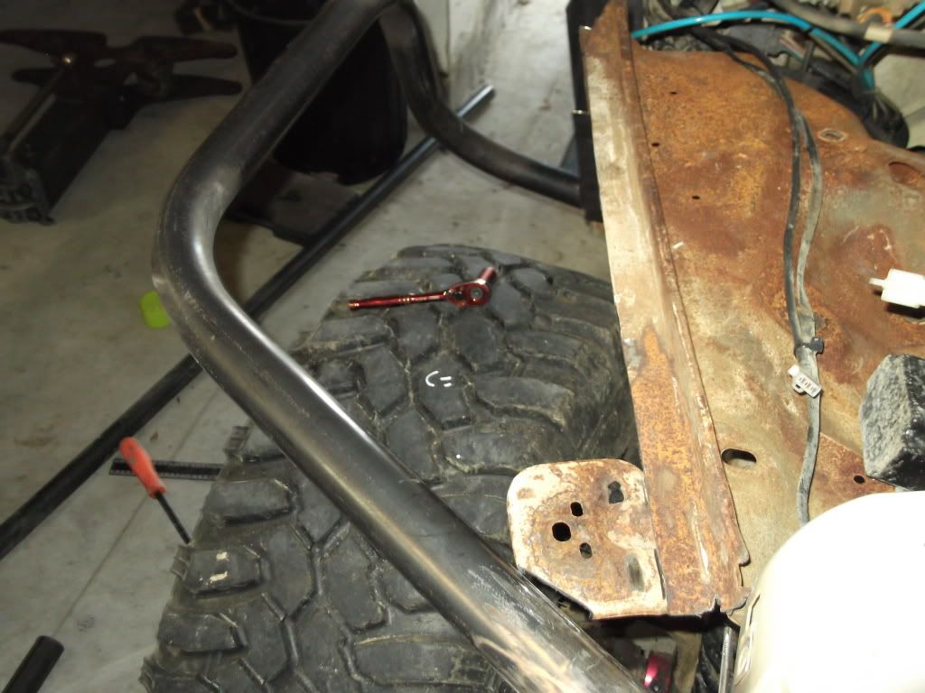

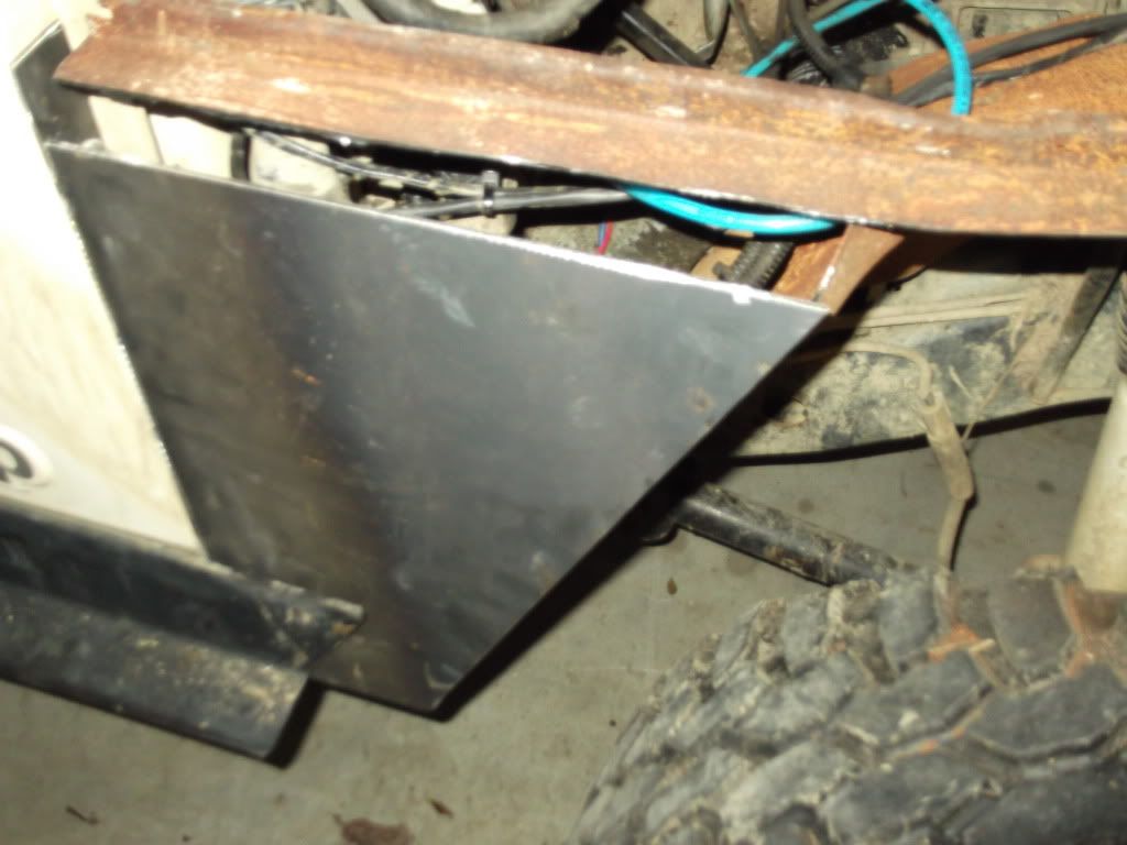

Got some more work done on them getting closer now.

I like the wide look of it all. Time to start the rears!

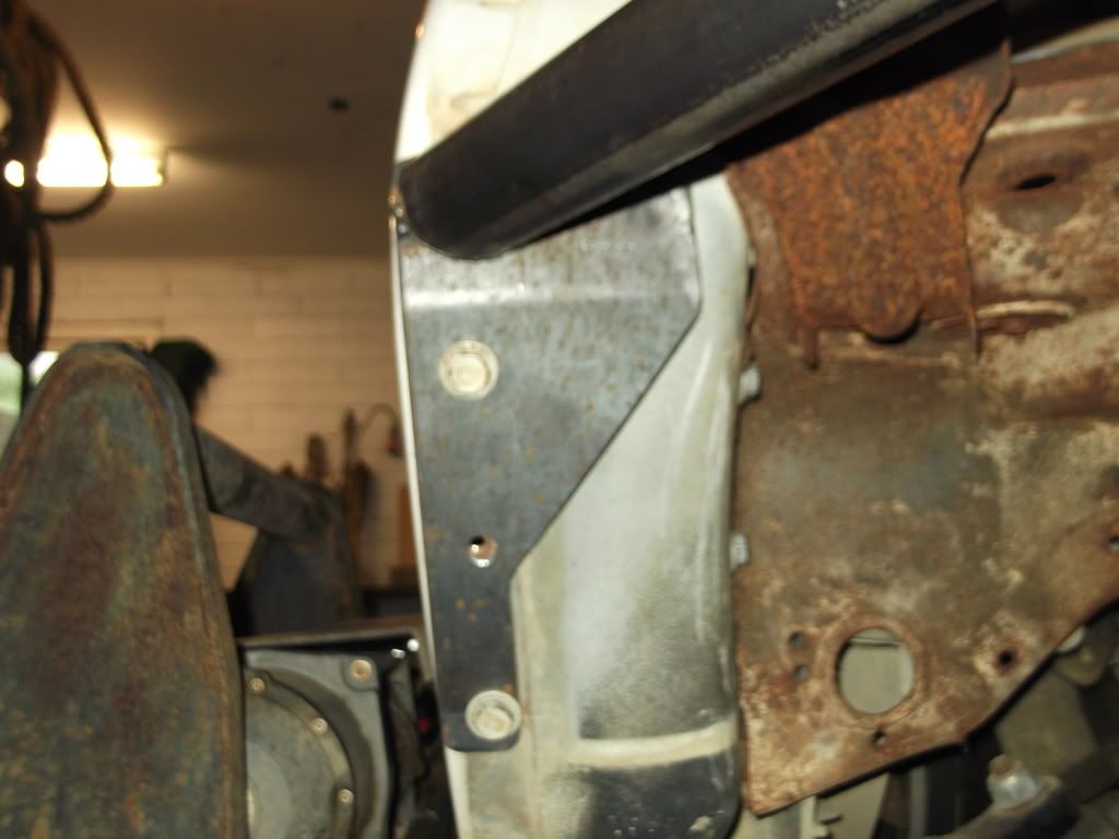

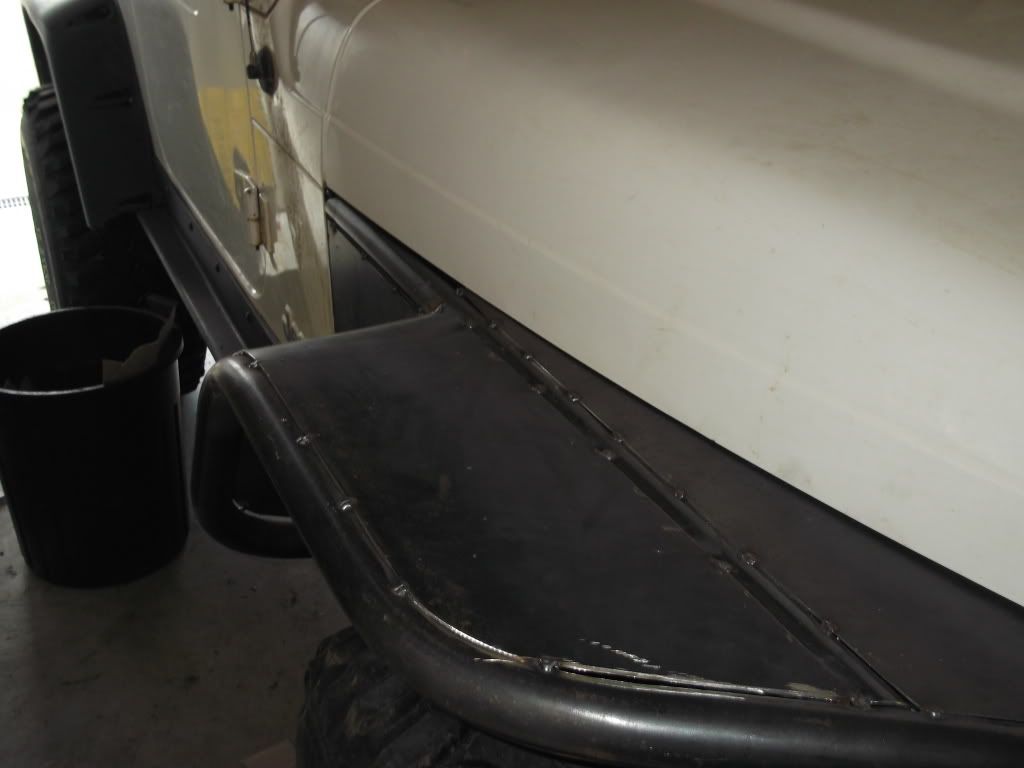

Removed one of the guards to start welding but run out of gas about 10 mins into it. So ill have wait till tomorrow to weld it.

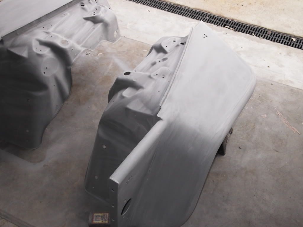

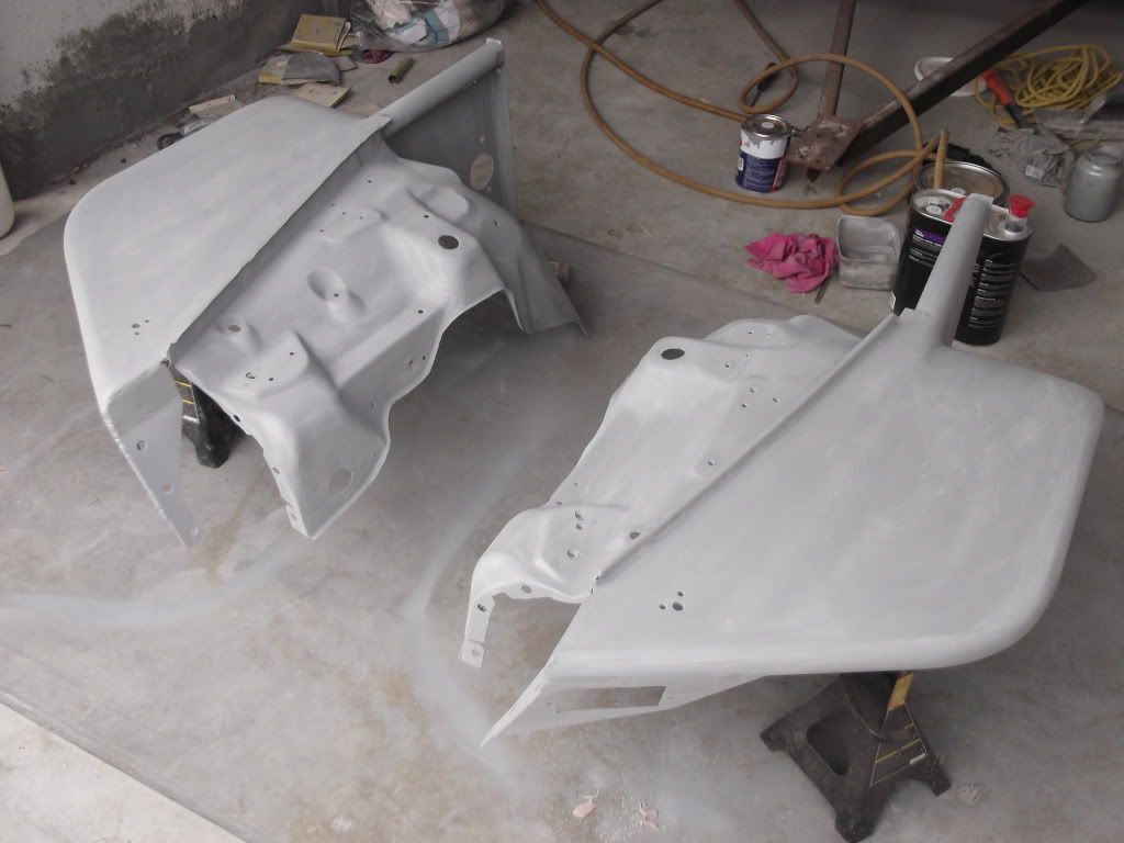

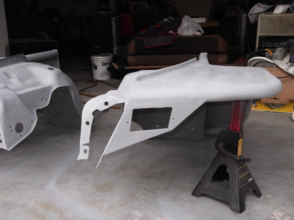

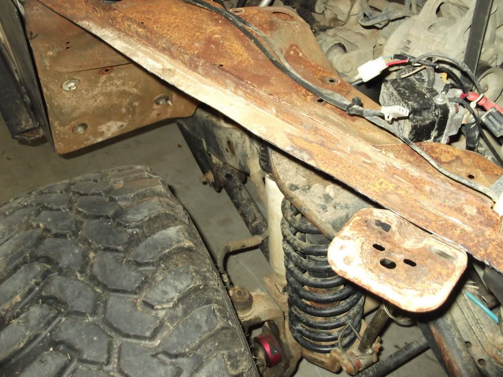

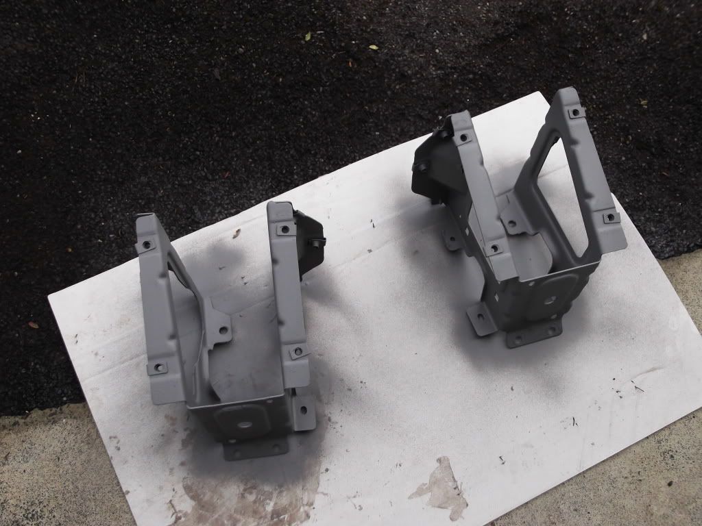

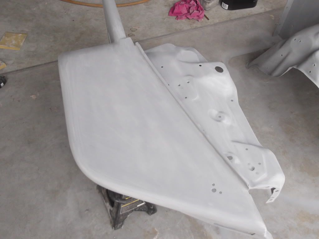

All primed up ready for top coat.
