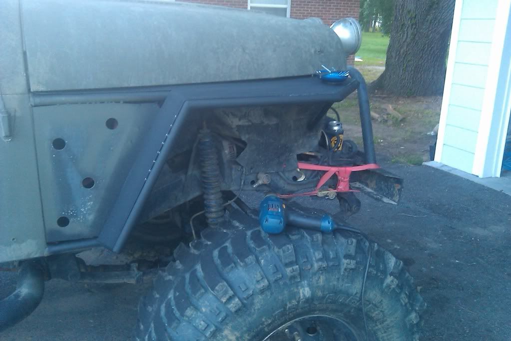

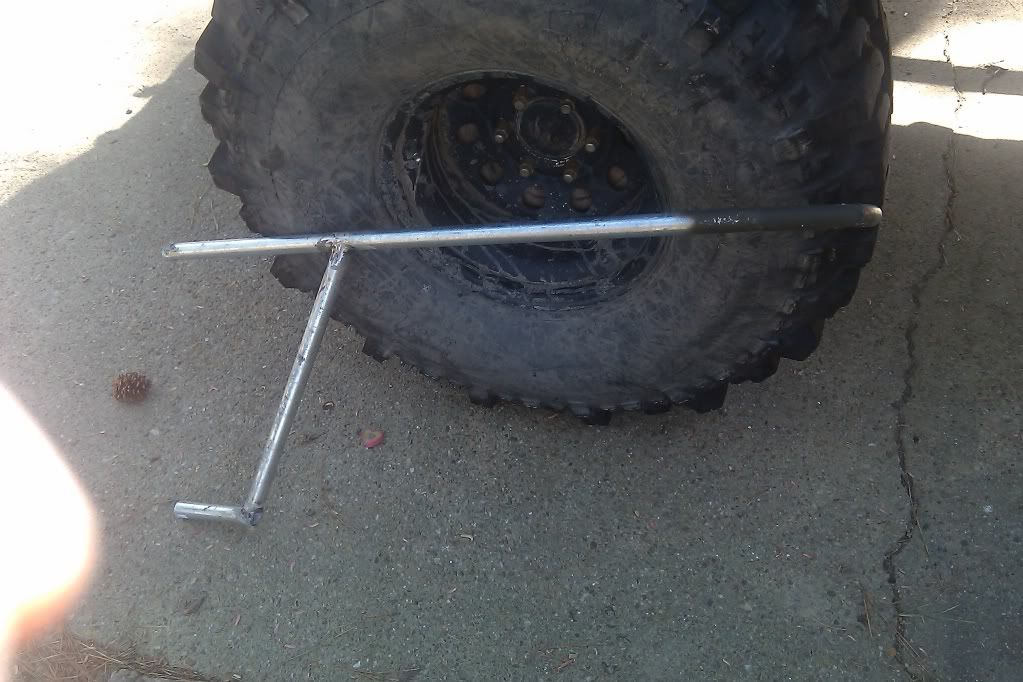

this is where i am so far gonna do the down tubes and the fender flares soon hopefully before next weekend cant wait to finish this up

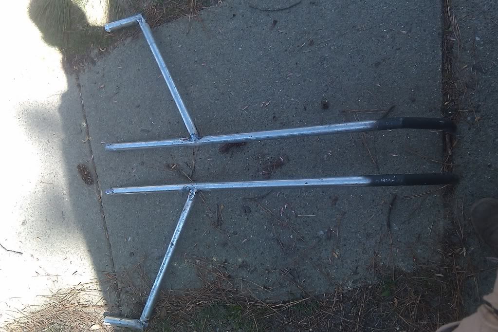

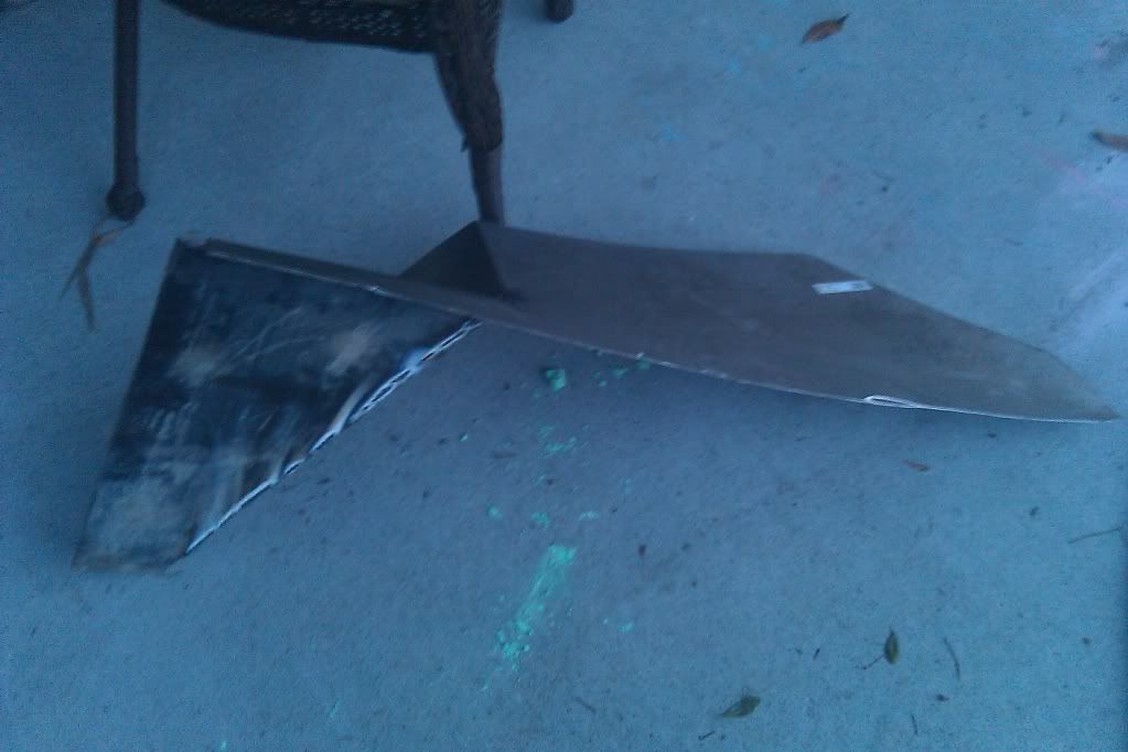

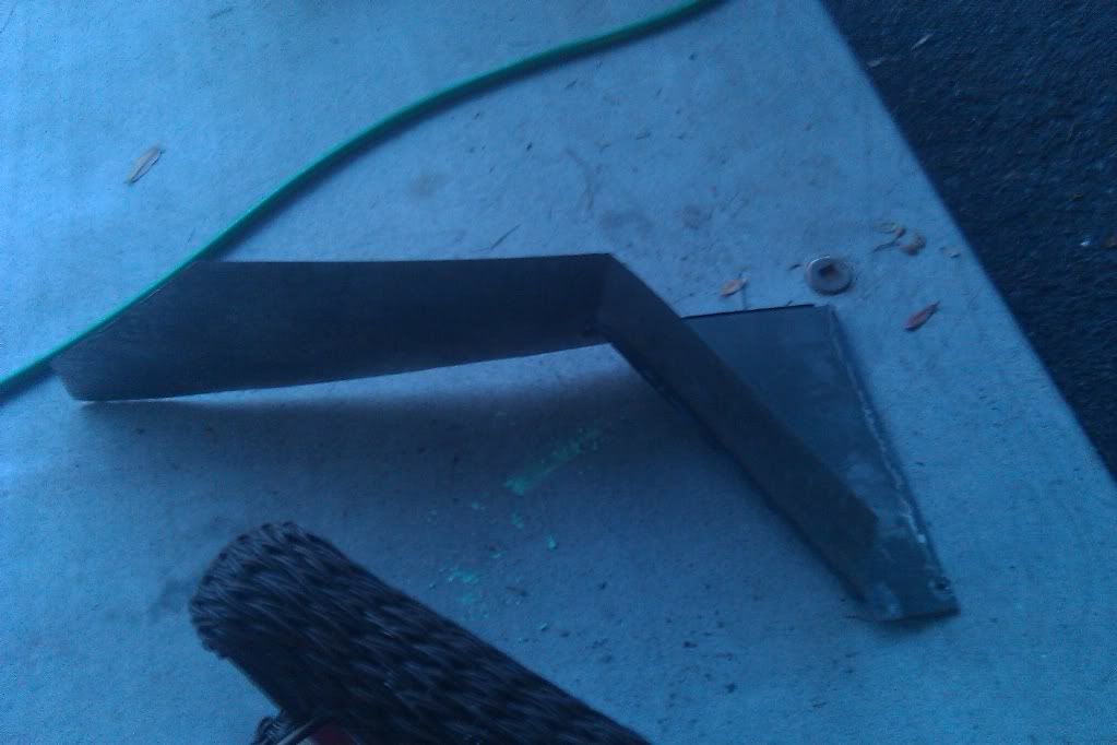

Wow forgot to update this not sure if i took any pics before i welded them to the jeep but i cut the sheet metal and started using poprivets to secure it to the tubes i think it looks pretty darn good will post pics when i get a chance

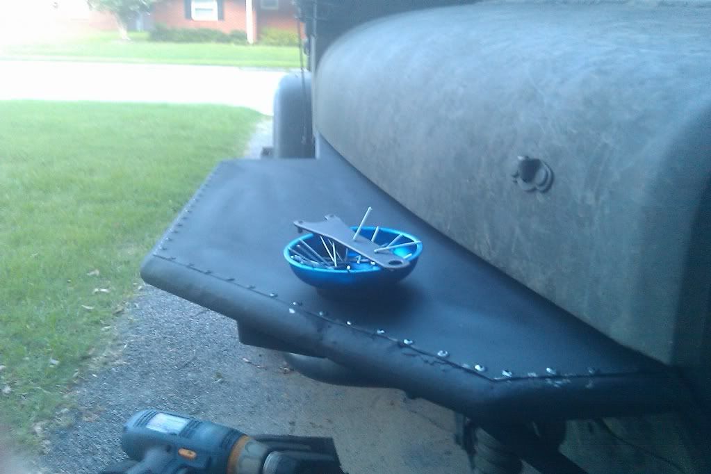

with sheet metal on
decided to use pop rivets
sheet metal off
still have somethings to do might smooth it out might not

formed the sheet metal for the other side today still have to trim a little and clean it up but all in all im pleased

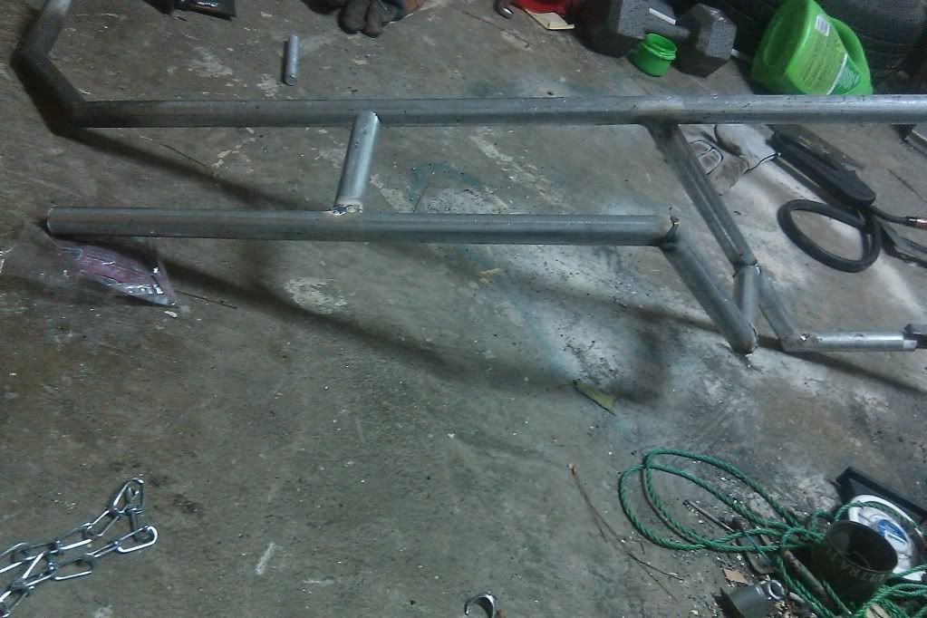

found some more pictures of when i was putting my flares together. welding on metal that is galvanized is quite the *****.

Look good. But why did you use galvanized? Is that electrical conduit from the hardware store or something? I almost cheaped out and did that when I made mine.

used it cause it was cheap and strong not conduit though. its, i think, 1" tube and 3/16 wall thickness. im gonna have to look at your build thread for yours.

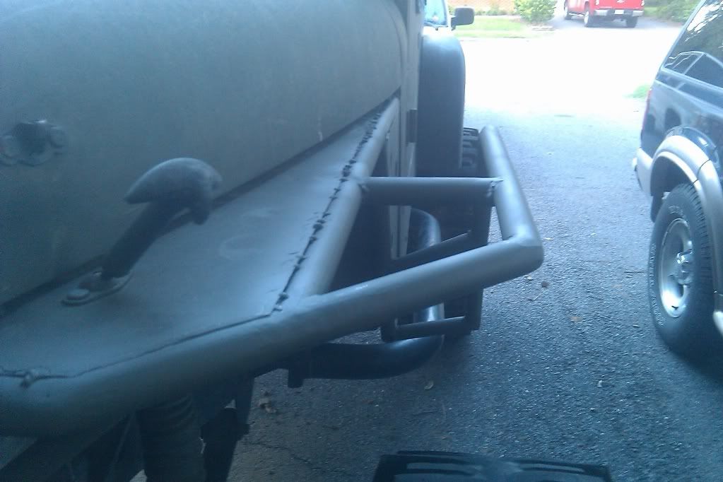

sorry i never updated this heres where she sits now gonna sand blast soon and repaint
