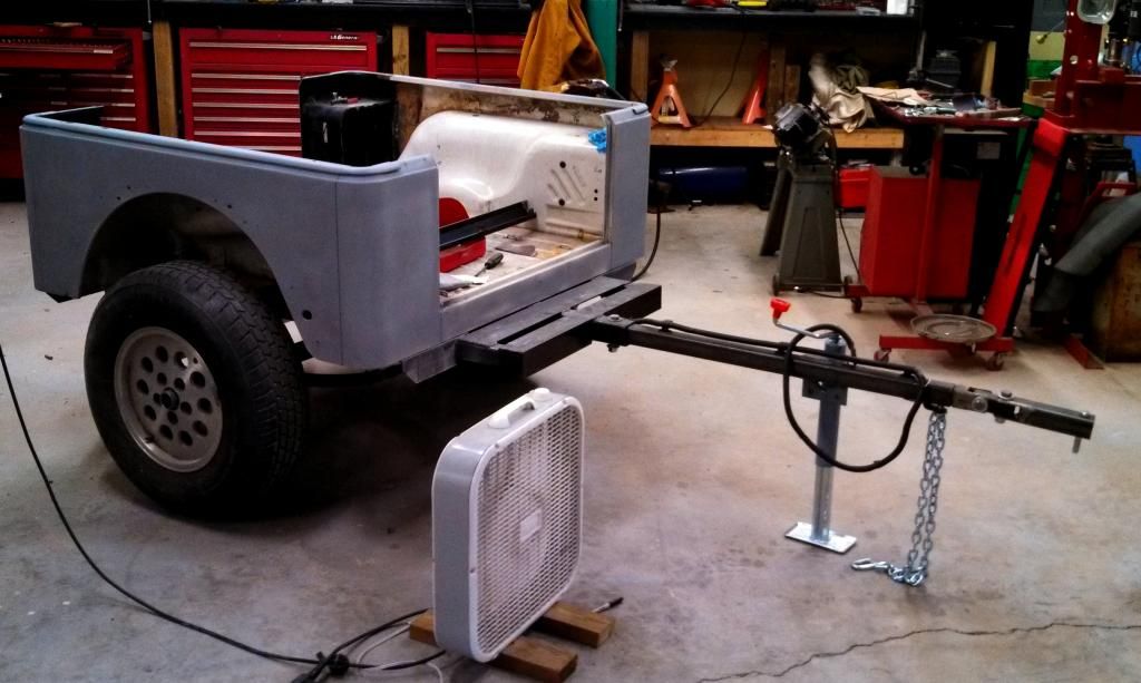

Made a little more progress today ...
The patch for the filler neck almost complete .
Tongue wiring is complete .
Trailer jack and saftey chains are welded up .
The drivers side is mostly complete now . Tomorrow I have to go install air lines for a friend , but come Wednesday I should be able to finish up the last of the body work on the trailer .
I also dropped off my measurements at the machine shop for the front panel , and I hope to pick it up Wednesday . I took a page from Clint Riveras build and I am using the last of my upper tub rail scraps to finish out the front with the panel from the machine shop

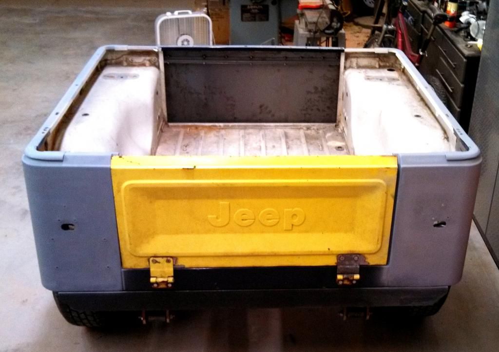

Tonights progress .
The filler panel is in place and ready for the final bending and fitment .
Fitted and ready for welding . I am not kidding this patch tacked up perfectly and I took pictures ... but the bud light platinum bottles interfered with the upload . Well thats the story I am sticking with .
Skim coat is on and drying for the night . Tomorrow I have more sanding and primer to spray . I still need to finish welding the floor corners in , but they are currently halfway welded in . From here on out is all finish work , and if I dont make it Friday to get it inspected , I will take it to the State Highway Patrol early next week .

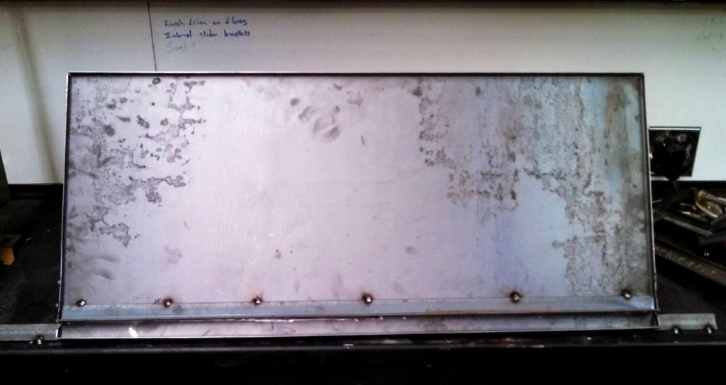

The bodywork is finished , and its all primer gray . Still a lot of wet sanding to do before I spray any paint .
I had my local machine shop break a pan for me to use as the front filler panel . They made it to tall , but gave me a killer deal on it .
With a little angle iron and tack welds I was able to make a break and bend the pan to match the angle of the tub .
Heres the filler panel fitted and adjusted to the tub .
I want to bedline it , but not sure which one I am going to go with yet . Any suggestions ? I like Line X , but not sure if I want to spend that much money right now .
Thats all the trailer progress for the day . And I still need to strip the tailgate ... forgot about that .

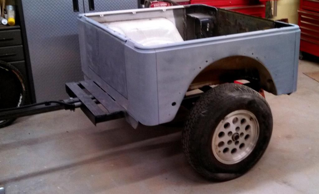

I thought I was done sanding .
Thankfully the drivers side of the trailer is about done ! The passenger side doesnt need as much attention , so maybe the sanding will end this week ? The trailer is ready to be inspected , but I am going to wait until the bodywork and paint are done later this week.

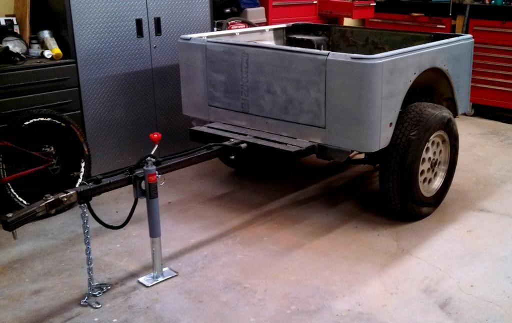

1st coat is on , its dull from wet sanding .
Another angle of the sorta shiny faded paint as Billy (my son) calls it .
Tomorrow is going to be a big shocker ... more sanding ! And some paint too , then some wet sanding followed by paint . Worst yet is I still have to strip the CJ tailgate and it has three layers of sandpaper eating badness built up . I tried 3M safer stripper and it did nothing to the finish other than clump up in fear . Next up is Kleen Strip airplane stripper which has lots of stern warnings printed on the package . The warnings coupled with danger! on the can means it has to be good right ? The plan is to apply the aircraft stripper outside over top of an old box to catch the toxic runoff and avoid future super fund status .
