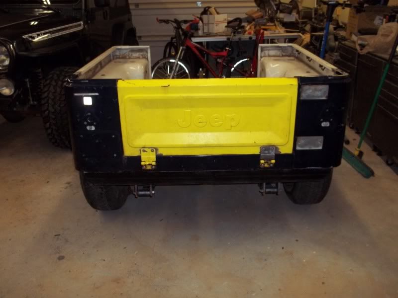

I managed to get out to the garage for a little bit this evening .The tailgates are mounted , but I am going to have to figure something else out for front TJ tailgate as I had to use spacers to get the hinges to sit flat .

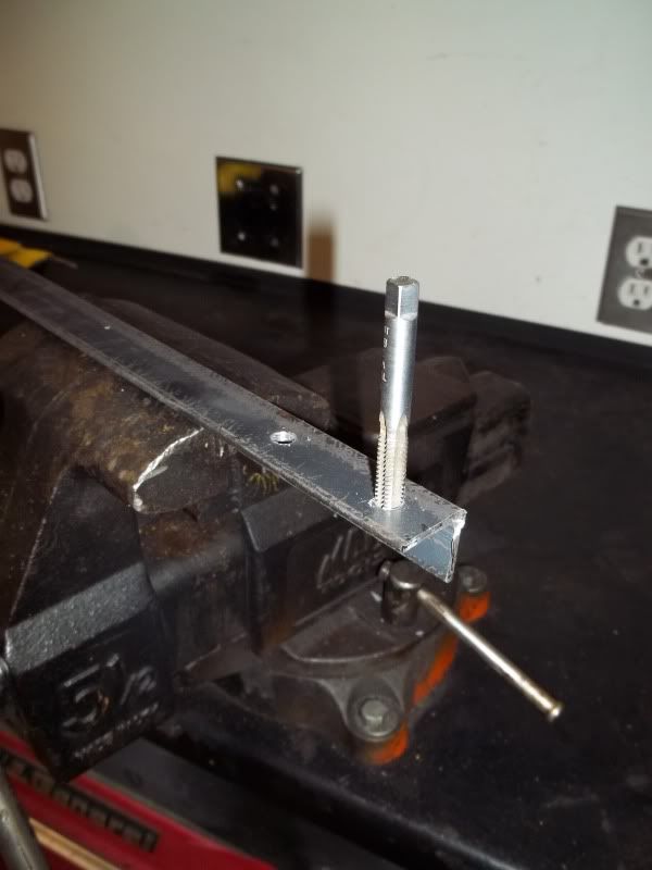

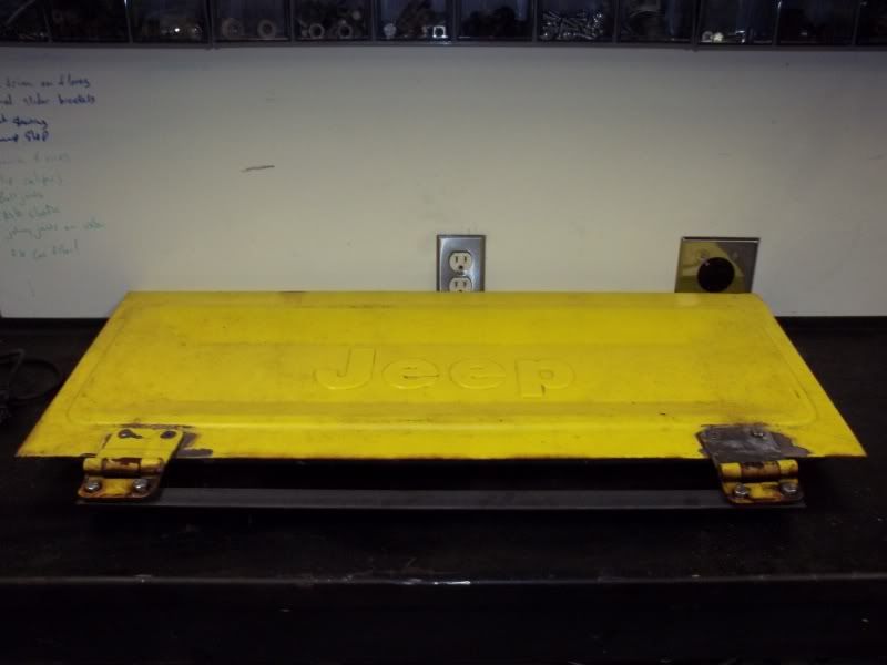

First up was to make something for the CJ tailgate hinges to attach too . I used a piece of angle iron to resist warping as the tailgate is opened and closed . I drilled four holes to match the pattern on the hinges . Then I ran the tap through the holes .
Next up was to test fit the brace before putting it in the cross member .

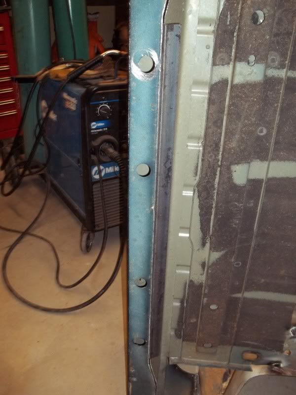

You can see where I inserted the brace through the body seam . I am going to weld the seam back up before the final install of the tub .
The brace is fished into place and the tailgate is installed .

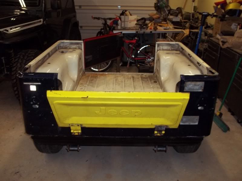

Dropped down and no flex in the tub cross member as it went down .

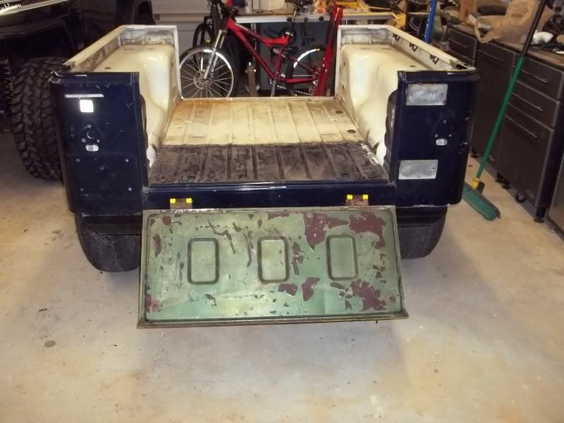

Front and rear tailgates are installed . I will have to either make or buy the rest of the tail gate hardware for both the front and rear . I still dont know if I am going to swing the front tailgate or mount it . If it is mounted I think it will add a lot of rigidity to the tub , and I dont see myself opening the front up very often . Still thinking this through any thoughts ?
