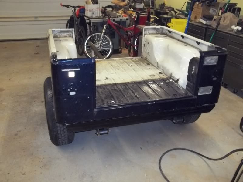

My wife kept me busy all day , and we had santa assembly tonight . But I still managed to get the tub bolted down and the tongue fully assembled .
Now that its on its wheels I am starting to figure a few things out . The first thing is I have to add leaf or two back into the spring pack . It is so soft right now that any weight in the bed will make it start to squat . The second thing is that I need some bigger tires ! It looks so funny on the 235s , but all in due time. Maybe I can hitch up to it and tow it around the yard tomorrow . Hope all of yall have a Merry Christmas .

Test towed around the yard today to see how things worked.
I didnt get up to much speed , but it towed nice and straight without any bouncing . I drove up all over and even backed up the gulley with no issues. The
gspup aka Mike multi axis coupler worked great and is very easy to hook up . The trailer is back in the garage and ready for the bodywork to start , but it was nice to tow it today .

The CJ tailgate has been a lot more work than I thought it would be . *
I had to drill out one bolt on each of the hinges and this left a nice round hole .
First up after drilling the old bolts out was to make an access hole to weld the new nut in .
Heres the nut welded in top and bottom . I also flapper wheeled it smooth so that the hinge would sit level . The last step was to run the tap through the nuts so that the new bolts will go in smoothly .
Lastly the tailgate is in place and the holes are drilled in the tub for the hinges . I need to drill an access hole and make two plates to go inside the tub for the hinges to attach to and the tailgate will be attached . I still need to get cables and the fold down retainers to finish the tailgate install .
