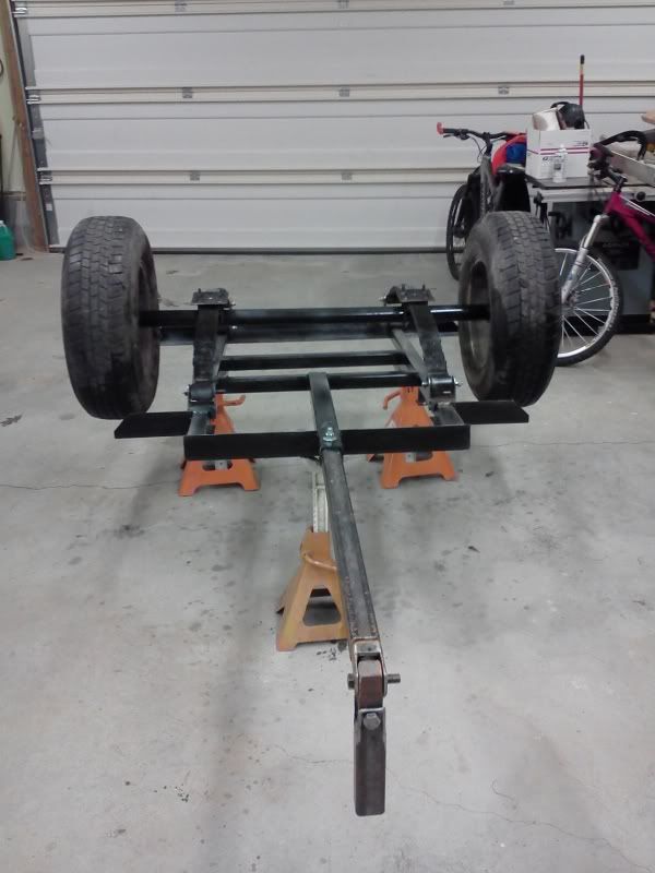

As of now my tongue is uncut . Once I hook it up to the LJ I should be able to figure out length a little better . Sounds like you got about the perfect axle . Hopefully your hubs will fit through your rims like mine did , it was a stroke of luck that it worked out that way .
All welded up with the four additional body mounts added in . I still have to move the rear spring mount , so it is tacked in until I figure out what I am doing .
Mostly painted ! It got cold quick , so no touch ups tonight . Tomorrow is supposed to be nice , hopefully I can finish the paint and get the tongue bolted in .

Back to the topic . To adjust the ride height I flipped the axle to the top of the springs . The ride height is closer now , but I think I may have to make longer shackles to get it perfect . The other thing the axle needs is u bolt skid plates now that they hang down and will want to grab everything . No worries , I have the steel in stock to make them .
Now that its upside down I can fully weld the rear spring hanger . Then I will paint the bottom tomorrow night .
Also bored the hole to bolt the tongue in , what a pain in the butt ! I stepped up 4 sizes of bits and the 5/8 at the end was hard to get through the 1" of combined steel .

Why not undersling the axle. Less chance of anything getting caught up on the plate and you gain around 2" in height.

I started out with it sprung over , but it was just too tall . As it sat before it would clear 37s . Now it will be more in line with my 33s . I prefer the spring over, and I may go back to it at a later date if I decide to cut the frame and raise the rear mount .

When the axle was sprung over it cleared 37s , with it now sprung under I think it will be almost perfect for 33s . The current tires are just temporary to roll it around on .My end goal is to make the trailer match my LJ in height and color .

The springs I am using are from the rear of a CJ .They were cheap (free) and are easy to replace . I skipped using the rear frame section as it limited what I could do . My other goal of building a frame is that I am hoping it will be a little lighter .
