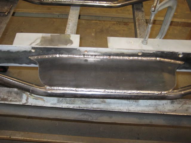

yep, this pick shows the backing plate for the top row, then there is a similar one for the bottom row. it it 2x.25 stainless steel.

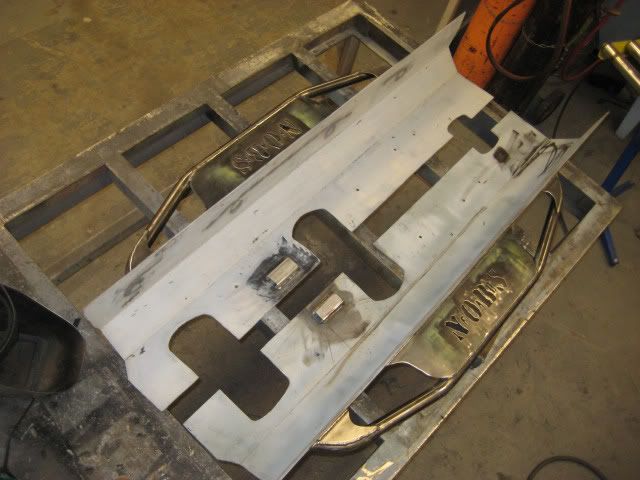

fab is finally done on these sliders!!!
and the pair together!

Man that is some fantastic work you have done.
You can't buy stuff like that with the touches of your own.
Makes it one of a kind.
Again really fantastic
Larry

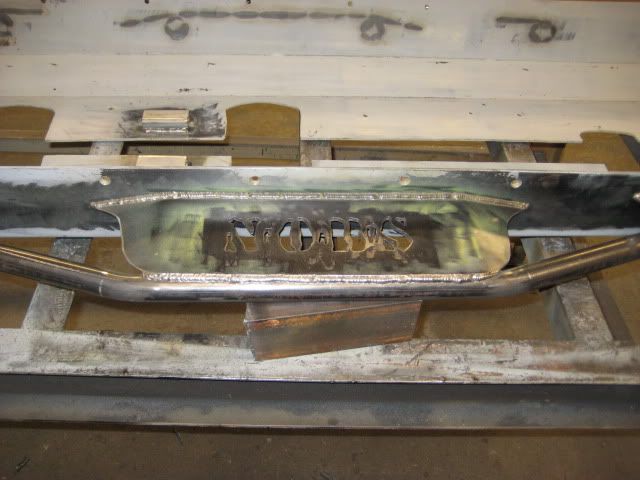

its actually 3/4". the sliders mount to the body between the 1st and 2nd body mount, then it slopes away after the second. which is why i used the spacer.

before i added the the tubes i was able to lift from the cut out around the front body mount with out any deflection of the rocker or tub but now i had just planned on lifting off the tubes. we have put tubes of the same material on many sliders in the past, xj, tj, yj and even an fsj on 38s and to my knowledge no one has crushed a tube. they are burned in hot and so is the plate because i knew they would see a ton of leverage all the way out there so im not worried about them holding up to a lot more then a hilift jack. if I have a problem i can redo them with .25 wall i suppose...

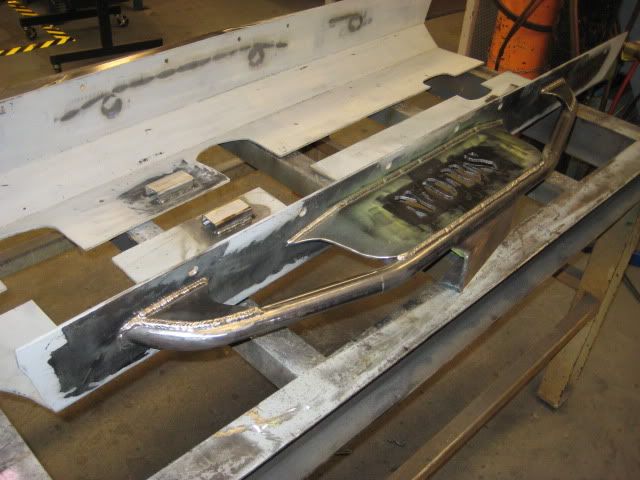

just primer atm... but heres whats been part of the delay
