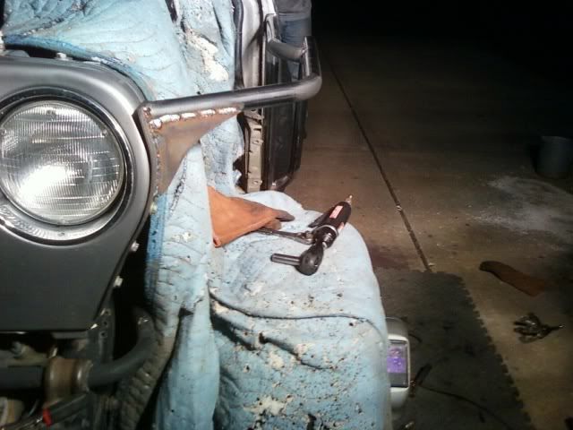

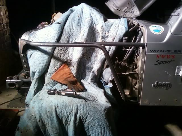

got the tubes welded together and the step plate roughed out of cardboard. the NOBS will be free hand plasma'd

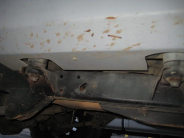

sure would like to see where and how they are mounted underneath.

o crap... sorry... heres one pic that kinda shows it... and its a bad *** pic ill get a driveway shot tom
there are three bolts between the first and second body mount that go through the floor and are sadwiched between a peice of 2x1/4 strap and then one between the second and the third through the floor and plate with a peice of 3/4in channel as a spacer where the tub slopes up.

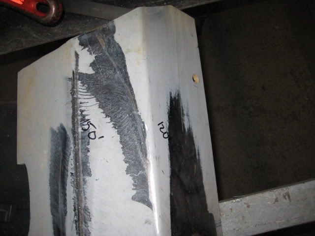

and i got your guys' requests... the bends...

and the underside mounts
fronts:
rear:
pretty simple... ill get flat head stainless fasteners eventually, i just wasnt sure of the length yet and they are kinda expensive.
did i miss anything?
