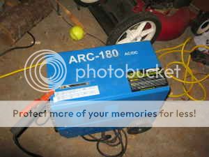

I'm interested in learning to weld. I found this on CL, I was wondering if you guys have any opinions of this welder. It looks like its the harbor freight job, but can you tell anything else by the pics??
I'm going to take a class this summer. Would this unit be something that would work for a new guy?
It's $50 by the way.

Here it is on Harbor Freight's website.
For that price, I'd probably buy it new, except that I personally think HF welders are junk so I wouldn't buy it at all. Worst case, though, is that you buy the one off craigslist, hate it, and you're out $50, which wouldn't exactly be the end of the world.
