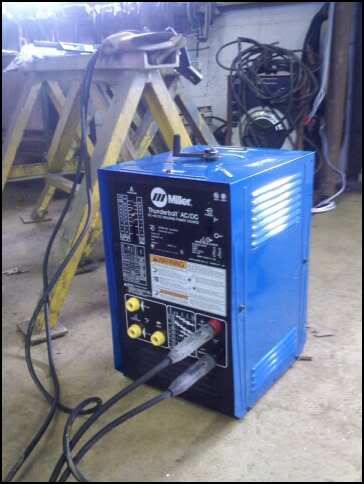

If cost is any consideration the stick welder will be king in your book. I have had 3 different Lincolns, 2 in the 225 A/C version and 1 of the 225 A/C-D/C flavors. The A/C-D/C is by far a more versatile welder. If I were to buy one today I would get the Hobart 230/160 A/C-D/C stickmate as is is more compact and has a better amp adjustment system. It runs in the neighborhood of $440.00-$475.00. TSC seems to have the best price on these.

Yup. It takes a little practice welding sheet metal on A/C. If you get an A/C-D/C unit it is duck soup. The A/C only rigs will need to be turned way down and use a 3/32 rod. It will be similar to a flux core weld.
Bullbar is no problem at all. Even the Lincoln buzz box 225 can weld 1/2" multi-pass pretty darn good.
Once you get the drift of welding D/C stick the welds with 7018 will look almost as good as gas shielded Mig.
The 2 welders I listed above, the A/C-D/C Lincoln and Hobart, can weld 1/4" steel with great confidence using D/C 7018 in one pass.
If you can swing it the A/C-D/C units are the way to go. They usually will cost about $150.00 more.
Same welder. A/C = Alternating current D/C = Direct current. It will use a 50 amp 220 volt circuit. Technically what and why they work different is best left to some smarter than me to explain. But I do know on the D/C setting there is better control and the action is much smoother.
On D/C you can change the polarity. Negative or positive ground. This helps with penetration which comes in handy while welding sheet metal.

A wider selection of rod can be run with having both, or should I say, all three polarities. D/C has a better looking weld and can do fairly thin work as well. It is hard to weld A/C on real thin metal.
