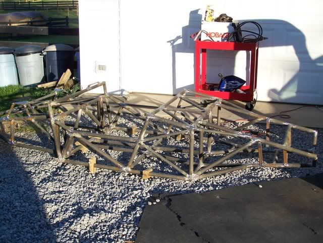

...a 1lb spool of .030" flux core wire to get you started. I've been practicing like mad and I'm nowhere near the end of it yet....
I went through 6 pounds, welding together a '59 Jabro MKII space frame for a guy (he already has 2, but want another) . It took about 13 hours to weld it together. I hate working with the flux stuff because you have to remove all of the slag to weld over top of the old weld. I was requested to build up the welds on the joints and grind them off to make them look "cleaner" the grinding and wire wheeling took an extra 15 hours. : but the money was nice $15/hr.
Pics of that space frame:
here is what the finial result will look like.
