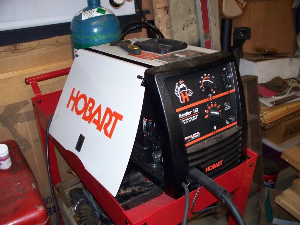

IT IS!!? I payed $650 not including a bottle! but yes I agree, it has the most heat settings, and with the right fineness and the thinner wire (.024) you can weld really thin stuff, and with the really thick wire (.035 solid or .045 flux stuff) you can weld REALLY thick stuff!! I bought the 187 right off because of this.
heres a pic of my welder:
Oh and learning how to weld comes with practice, that's how I learned. this past summer I went to a class to get my welding certification (I just thought it would be another nice PLUS on the resume) the funny thing was that the instructor saw my welds on the first day and said "man you already know how to weld," then he says jokingly, "you should teach the class!" I have been welding since I was 14, so I got a lot of practice.
Practice makes perfect!
