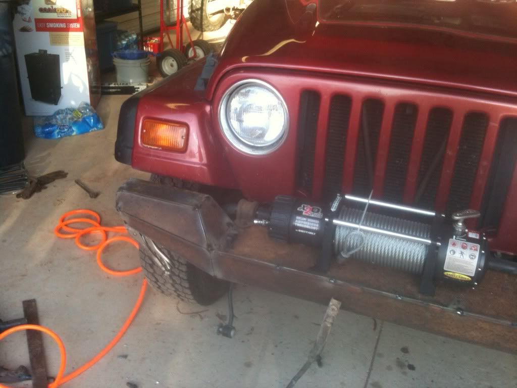

I'm planning on adding D-ring mounts and a "hoop" to go up and over the winch. Still have to add a piece across the front for the roller. Probably put light mounting tabs on the hoop.
Is there any thing I'm forgetting?

looks good... how are you attaching the D-rings?

what thickness is the metal?Looks like 1/4 inch or thicker.Will be heavy as all get out,but one hell of a start!!!!!

I'll probably cut the plates for the D-rings to lap over the top just a little and then weld down the front. I may just weld them straight to the 3/16 plate on the front. That's how the store bought bumpers look.
The winch plate is 1/4", the rest is 3/16". I had some 10 gauge but decided against it. The pieces right below the fenders are also 1/4", but only because it was 3" flat strap and saved me from ripping the 3/16".

Wow the pics are deceiving,I thought that material was thinker than that.Keep up the good work bud!

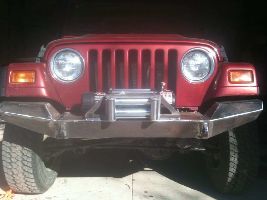

Welded out and ready for grinding.
Now I'm thinking I might not add a hoop. I don't have a bender and don't want to mess with weld in 45's. The plate that I used had been sitting around for a while, going to paint with bedliner to hide the pitting.

I like the style of your bumper
