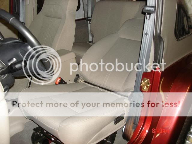

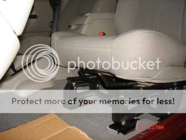

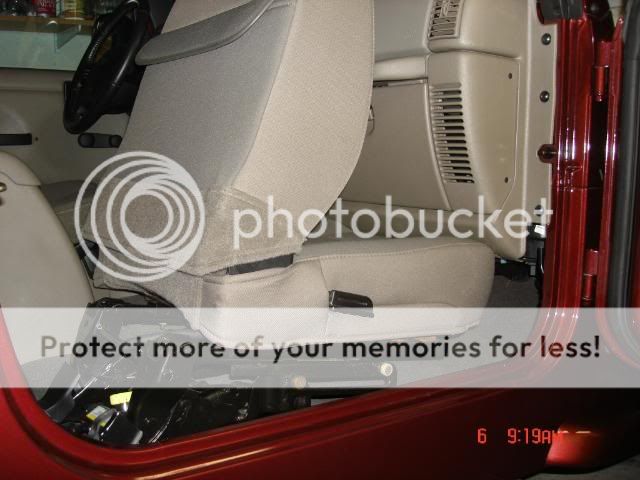

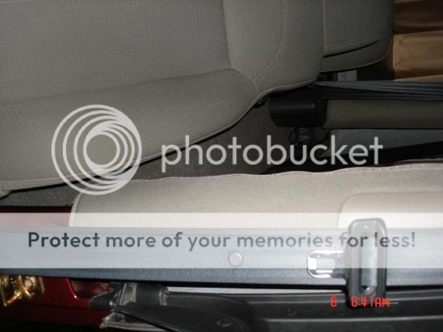

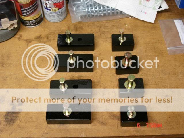

I finished this a few days ago. I went with 1" high by 1.5" wide. The total cost for me was under $40. I finally got some pictures up of it all for you guys. The only thing I messed up was drilling the holes. I got a little drill happy and drilled them all out with the larger size so I went back, flipped the block around and redrilled. You can't see the extra holes once it was in the Jeep.
Here's the parts
[IMG][/IMG]
You'll need 2 of the grade 8 standard bolts for the seatbelt corner then 6 of the smaller bolts. Since I wanted the strongest bolts I could, I went with 10.9 grade which, 10.9 is the metric version of standard grade 8 bolts and they have 10.9 stamped on the head of the bolt. Grade 8 have 8 lines on the head of the bolt.

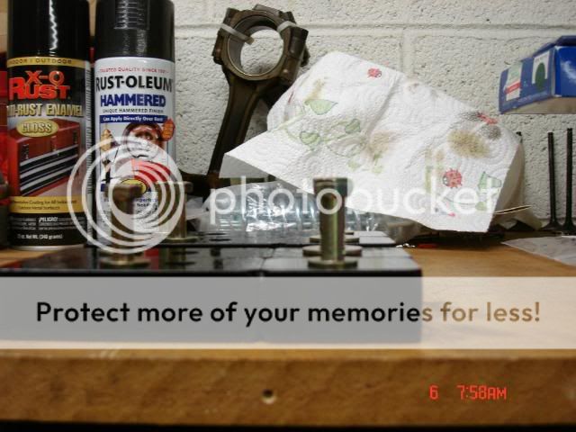

[IMG][/IMG]

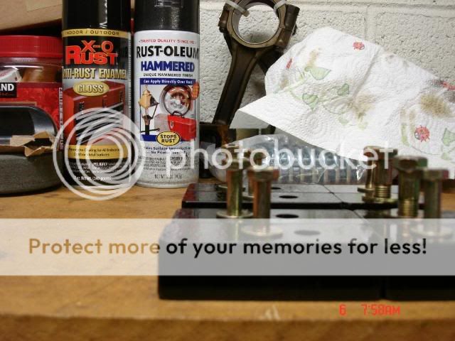

The bolts holes for the blocks in the back are all the same measurements
[IMG][/IMG]
The ones upfront will be staggard
[IMG][/IMG]
Here's the drivers side with 1" risers on
[IMG][/IMG]
[IMG][/IMG]
Seat still functions completely the same
[IMG][/IMG]
[IMG][/IMG]
[IMG][/IMG]
The passenger side was exactly the same. I know there was a question about the seat going forward. Here's what it looks like. It touches but doesn't effect it at all with 1"

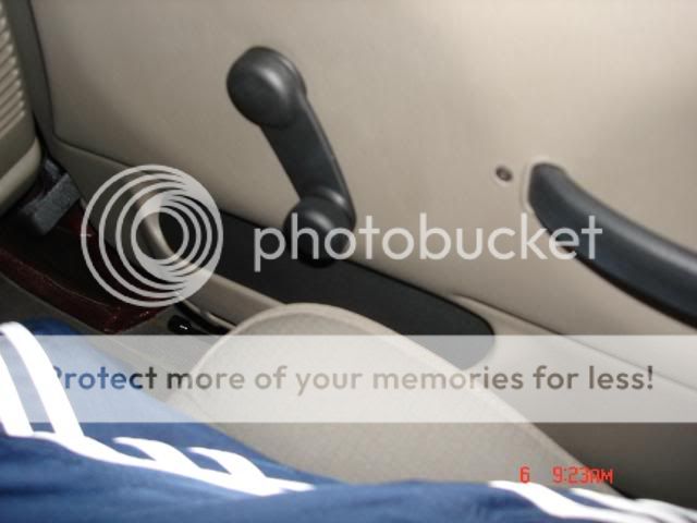

I did notice that if you go too high you might have a hard time putting the window up and down.

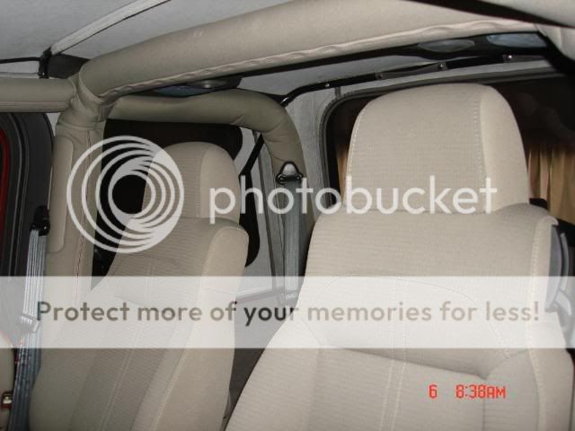

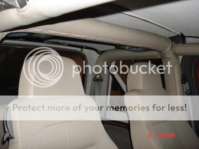

Here's both seats raised 1". Decent amount of room before it hits the roll bar.

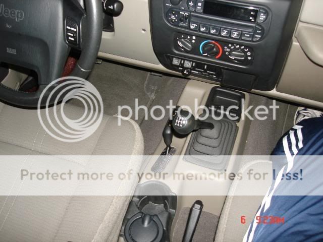

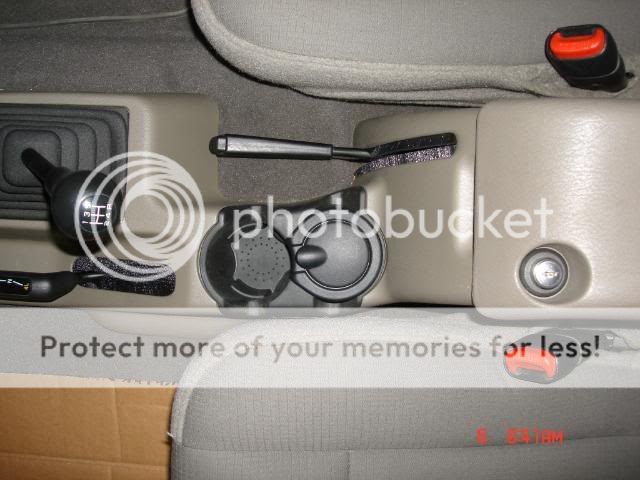

and last but not least here's a shot of the console. It looks like it normally does with no gaps.
