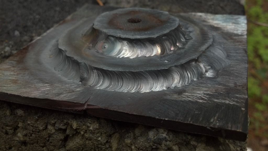

Could some of the more experienced guys post up what tungsten (types and thicknesses) and filler thicknesses you guys use for different metal thickness. Mild steel for now.
I picked up some Argon, 3/32" er70s2 filler, and am using the 3/32" Lanthanated tungsten the seller left in the torch.
Here are my first welds with the new toy on some 1/4" I had laying around. Still playing with amperage control (using a finger control, don't have a foot pedal yet) and trying different torch and filler dab techniques.

More used to stainless, satellite and aluminum. Just remember to keep a good point on the tungsten, that was always the main thing for me. If you go thick, you may want to try helium, or a mix - gives more penetration. Prefer straight argon on aluminum. Also harder to maintain arc with helium. If you start doing stainless do short beads, otherwise weld will sag on backside. Have fun.

Thanks for the pointers. Have been pretty good at keeping the tip out of the weld so far and have been keeping them sharp with the grinding marks parallel with the tungsten.
I've found that out with stainless. Played with a couple thin pieces and some stainless tubing and had to cut my amps way down to keep the weld from sagging through.

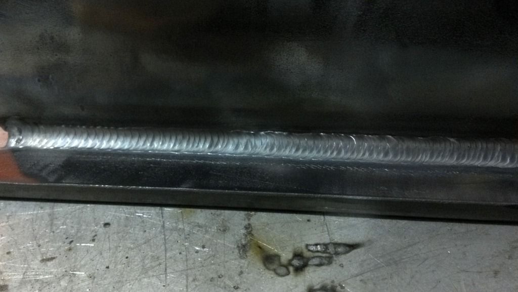

On the top picture on this page: the middle part looks the best. From this view it seems concave, try adding more filler or slowing down. 3/32 filler will work, 1/8th is easier for me. Slow down and get the puddle going good, step forward with the torch, dip the wire, then step back to burn it in. Don't be afraid to manipulate the torch to get it to burn in how you want to as well. As long as your not over-filling you shouldn't have penetration problems, if the amperage is high enough and there are no defects in the weld. TIG is the hardest to learn because of the seperation of filler and penetration, with MIG you have them both happening at the same time. TIG you have all the control in the world. Keep a steady, consistant torch angle, consistant speed and consistant puddle size and step. Step, dip, step back, step, dip. step back. Rinse and repeat.
Thanks for the advice. I didn't think I was adding enough filler on those welds. We have been learning to manupulate the torch more in class recently and I'm starting to get the hang of it a little better I think.

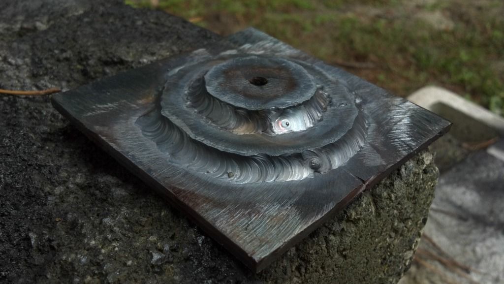

Here are my most recent fillet welds on 1/4"

Those are looking a heck of a lot better! Keep it up!
