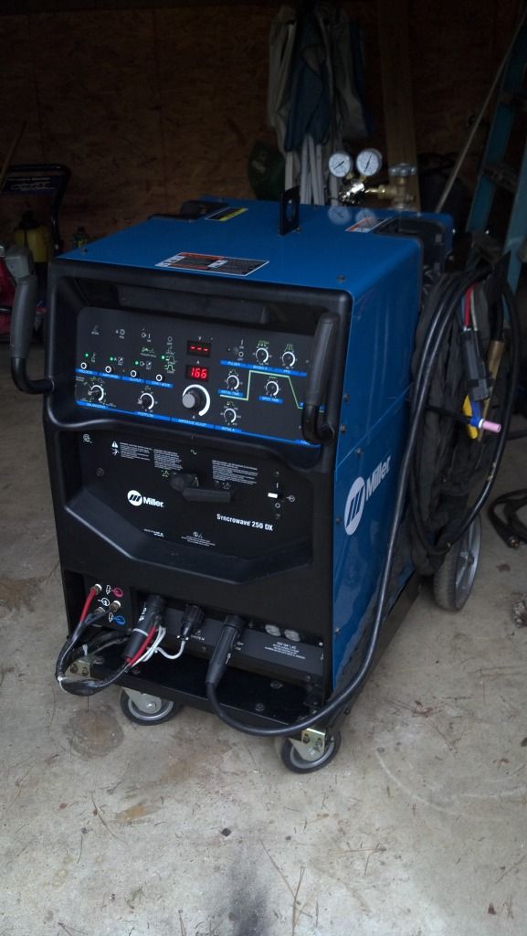

Beat the seller down some on the price and brought this home this morning
I ran a few beads with it at the seller's shop to test functionality and tested the cooling system. Before I can weld anymore with it I'll have to wire in a larger circuit in the garage. The "beast" needs a 100 amp circuit. Probably overkill for my use but I think I got a good deal and a good machine. I read about a few issues with the integrated water cooler which is why Miller went back to an external cooler on the newer TIG runner packages but I tested the cooler and got no trouble codes nor anything when I was welding with it. If the cooler goes later on down the road I'll probably switch to an external model.
