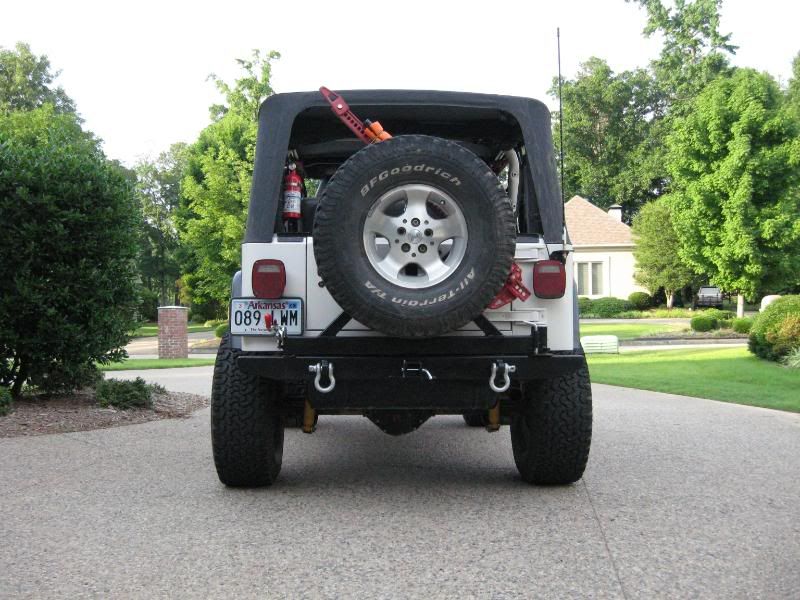

Sol_Invictus
Location: Grand Rapids, Michigan
Posts: 128
Originally Posted by BESRK View Post
I thank you for the kind words Yeah.. pics would be great for my scrap book!
I saw those other pics you posted of just the rear bumper without the tire carrier. Looks really good.. what did you coat it with?
Hey thanks! It turned out better than I thought it would. Just some self etch primer and three coats duplicolor truck bed liner from a rattle can. I've been thinking of topcoating it with some POR15. If I recall, I thought that's what you said you used to coat yours. If you use it, how well does up hold up to abuse and UV? My jeep won't fit in my garage and I don't want a gray bumper with the rest of the trim black! Thanks again, great thread!

POR 15 likes "bare steel".. it doesn't adhere well to paint. Probably wouldn't adhere very well at all to the bed liner since that coating is kind of "rubbery".
If you shoot/brush on a couple coats of POR 15 and then follow that with a couple coats of the POR 15 Chassis Black, it'll last for years. Really durable paint.

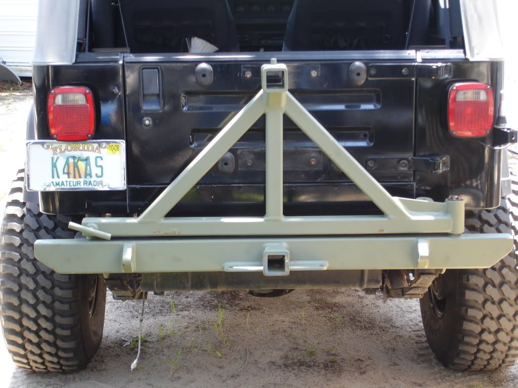

A few pics of my BESRK inspired bumper! I have a question/problem,(94YJ) I incorperated lower frame tie in tabs. I have a 4.5 RE ED lift, I am having a problem with my shackles hitting the lower tabs I fabbed up using AtoZ's tabs.
I have RE shackles but haven't gotten around to putting them on, still using the stockers. Has anyone had a problem with this? I think its because the RE springs are a bit longer than most springs. Surely longer than stock springs.
Nice!
Can you post pics of the shackle interference?

Well I was going to take some pics and post them but the rain is killing me! I put my RE greaseable shackles on and and all is well. No more interference!
