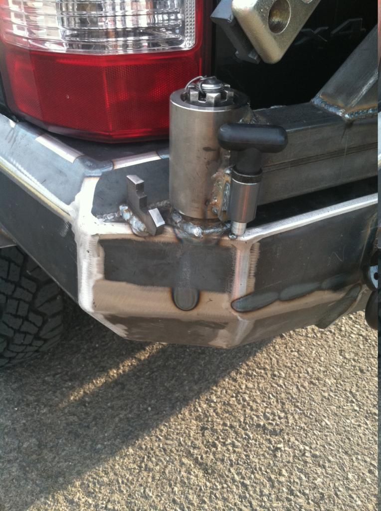

Hopefully KK's are welcome here... Just about done on this one, BIG thanks to BESRK for supplying me some of the parts and sharing his techniques. Everything is solid and rattle free. That plate location is temporary, it actually goes in the center of the bumper in a recess.
Hopefully no one is using 56k bandwidth haha. (Dust cap on hinge not installed yet)

Nice! I love the wraparound. Most people will put the tire on the passenger side especially if you're a solo driver. Just a thought.

AtTheHelm
Join Date: Nov 2012
Location: South Lake Tahoe
Posts: 860
Thanks!
I put the wheel on the the driver side for better visibility esp during lane changes and backing into the street..
