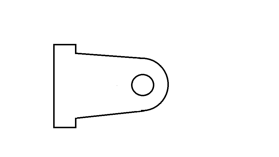

Yep.. it's my side gig. I'm a "attention deficit, OCD, workaholic".. always going 100mph in 10 directions. I've gotten better though. I used to do 10-12hours a day 7 days a week.. all year (including Tgiving, Xmas, New Years..etc). Now, I try to take at least 2 evenings a week off from the shop. And I plan on taking Xmas Day off this year..
3/4" is fine for Clevis Mounts.. Maybe do some with the "T" Lock on the backside..
Something along the lines of this...
BESRK is offline

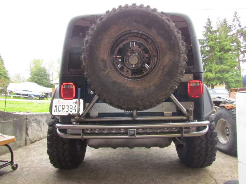

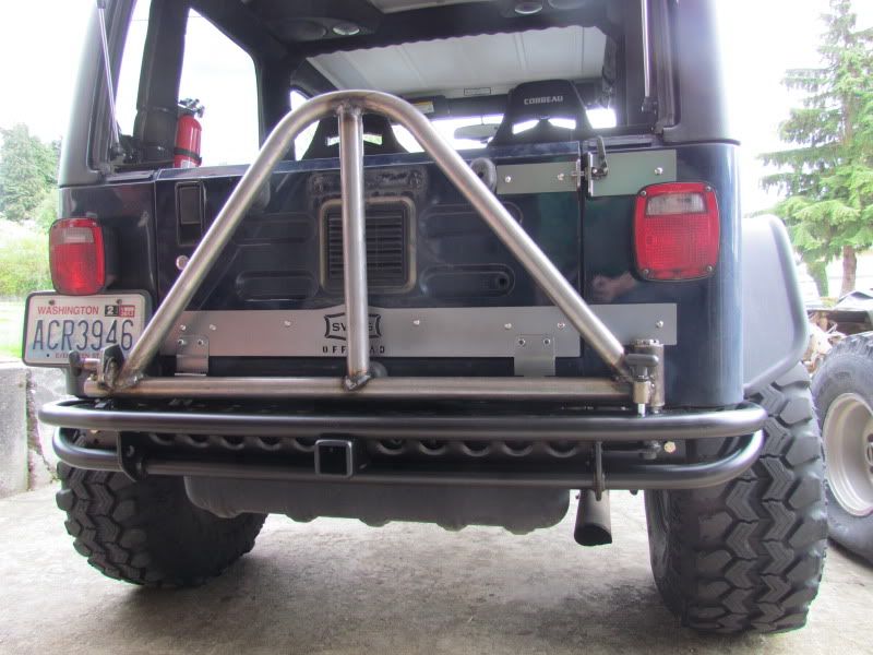

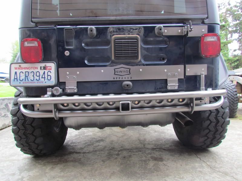

post #1829 of 2229 Old 11-22-2012, 11:18 PM
1982cj8
Location: Everett, WA.
Posts: 657
Here is mine, it survived 2 weeks in Moab, even some high speed runs over rough country.
I have added a couple of items since the pictures, rear lights, cb antenna mount, outlet for the on board air.
Always bring a compass, it is awkward to have to eat your friends.
4X4XNORTHWEST.COM
1982cj8 is offline
post #1830 of 2229 Old 11-23-2012, 06:29 AM Thread Starter
BESRK
GROUND POUNDER
BESRK's Avatar
Location: Newport News, VA
Posts: 12,283
Nice! What's the blue handle thing on the latch side?
BESRK is offline
