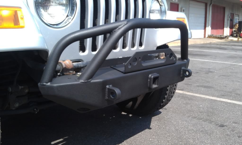

Can some 1 create a bumper similar like this???
I don't have the time to do it myself nor the tools.

Any idea who makes it? When it comes to custom creations like that (nice bumper BTW), it's usually quite a bit cheaper to try to get it from someone who is already building them. They've already worked out the bugs and have some (if not all) of the parts already pre-made to incease production time and reduce cost. When someone has to crank out a "one-off" based off of a photograph, it's all about time.. and time = $$$.
I'd be kind of curious to see how they did the mounting setup.
Have you tried posting that pic in the CJ Forum to see if any of the guys/gals know who made it?

Yes I did. Here is the thread: http://www.jeepforum.com/forum/f8/do...umper-1379144/.
But when I see this picture: I just simply like it.
