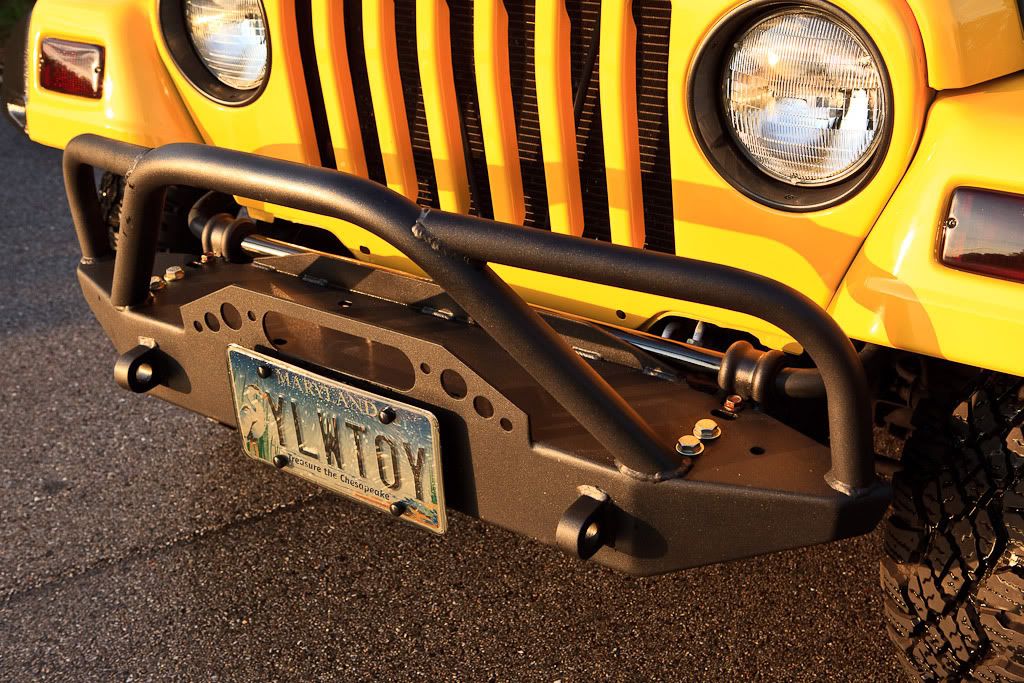

Originally Posted by RichardD View Post
S8credground, how did you mount the front license plate to work with the front receiver? Great pictures, BTW.
That is one good looking bumper Eddie!
Originally Posted by tdkask View Post
Probably what I intend to do when I get my new GPF bumper in a couple weeks... piece of 2" tubing with a hole drilled for pin, front plate size of tag w/four holes for tag screws.
RichardD,
Thanks (I do photography professionally) but to answer your question...just like what tdkask said. I grabbed a 2" piece of tubing, a thin piece of sheet, welded the tubing off center...that way the license plate clears the fairlead hole, fitted for depth (because of frame cross member), drilled hole for pin, bought those little plastic license plate things and drilled holes for them, installed plate and that was it. I must admit...it's a little bit of a pain in the a$$ to put the pin in, but it's not like I install and remove it every day.
I've also seen these for sale...but I don't believe I've seen them off center...just centered.
Hope this helps?
