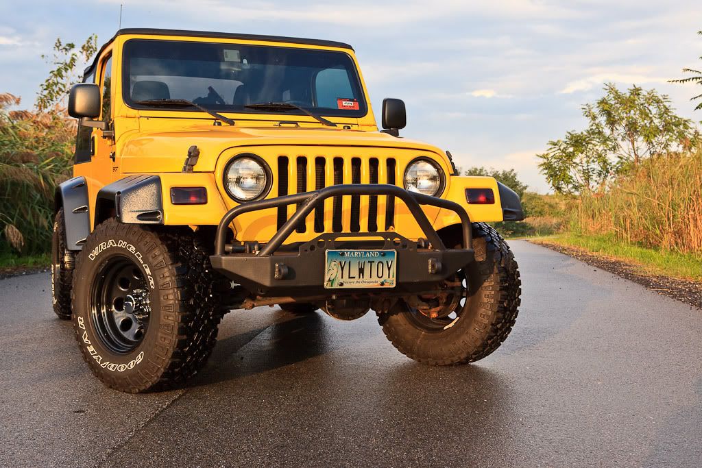

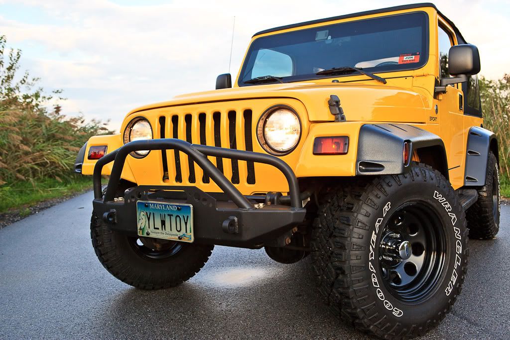

Ok Besrk show me a link to some pictures of the new front bumper your now making.

post #1554 of 2230 Old 11-19-2011, 06:41 PM
S8credground
Join Date: Jul 2011
Location: Baltimore (Halethorpe)
Posts: 59
Sent from somewhere out there...
| Yellow 2006 TJ | BESRK Cstm Bumpers & Carrier | 16" Rubi Rims| 35" Nitto Trail Grapplers| Rock Krawler 3.5 X Factor SA Lift| 1" BL |
| Currie Currectlync HD TR & DL| Tom Woods SYE & Shaft| Bilstein 5160 Shocks|Rokmen Bump Stops, HD Engine/Trans Skids, High Clearance Belly, Gas Tank Skid & Mercenary Rock Sliders|
| 2012 JKU Sahara Black 3.6L Auto | Ordered 10/5/2011 - Received 11/19/2011 | Stock...for now! |
S8credground is offline
post #1555 of 2230 Old 11-19-2011, 08:11 PM Thread Starter
BESRK
GROUND POUNDER
BESRK's Avatar
Location: Newport News, VA
Posts: 12,283
Ooooo.... Had to "right click save pic as".. I've made a few of those now and only have a couple pics. I just called the wifey to come take a look at it..
she just did this ----->
BESRK is offline

That thing looks great.
S8credground can you take afew more pics are different angles.
I'll have to come by the shop when you get another one done so I can take a better look at one.
This is about all I have. I get a lot of compliments on my bumpers...(Thanks Eddie!)
Before paint and test fitting...
Incase anyone is wondering...I painted with POR15 Rust preventative then POR15 Chassis Coat

S8credground, how did you mount the front license plate to work with the front receiver? Great pictures, BTW.
