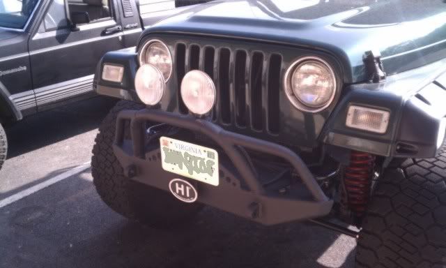

Here's some pics of that TJ Front Bumper I did a couple weeks back. The owner had it LineX'd. Almost booboo'd and made the bottom edge come to within 1/8" of hitting the steering box. I think I'm going to just revamp it a little and add in a steering box skid.. why not?
Cell phone pics...
Cell phone pics...
That looks very good. I may have to consider getting a front bumper.
Cell phone pics...
Eddie,
Was this a custom bumper? I would love to have one like this...PM me when you have time.
Thanks,
Jason

Originally Posted by BESRK View Post
Cell phone pics...
Definitely one of the nicest front bumpers I have seen. Excellent work Eddie!!!

Thanks for the kind words fellas!! It was a "custom" bumper. I still need to work out some issues before I make it a "production" piece but it shouldn't be too far down the road.
I just want to make sure I have it right before sending it out there. With local wheelers, if there's an issue, they can swing by the shop and we can address it on the spot. They are my "beta testers". Once you start shipping them out.. it's a whole different ball game. So for the time being, I'm only doing that newer one for the local crowd.. at least for a month or two..
