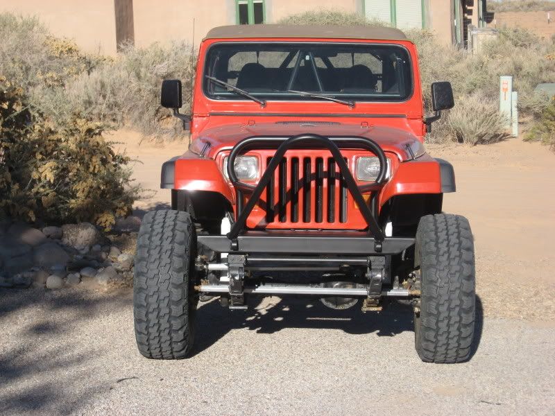

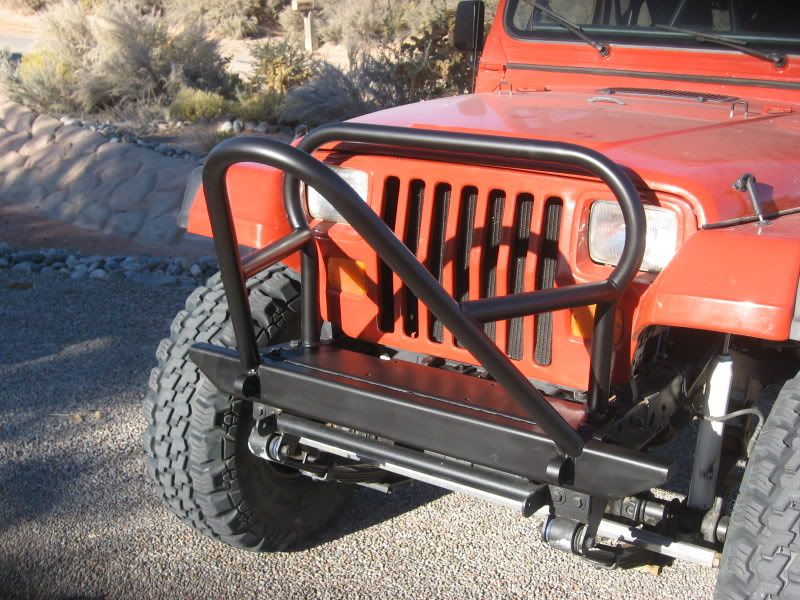

Last night a friend bent me a radiator hoop and stinger. I spent 6 hours today fitting everything together and welding it up. Because of the highline fenders he couldn’t bend the radiator hoop in one piece so its made out of 3 with the split where the horizontal bars from the stinger attach.

Yep, looks good but I'm curious why it couldn't be bent with one piece?

is that 1.5 or 1.75 OD?
DOM or HREW?
looks really good.
His bender needed 6" between bends. The bends around the head lights run into each other.
DOM or HREW?
looks really good.
It's 1.75 DOM
